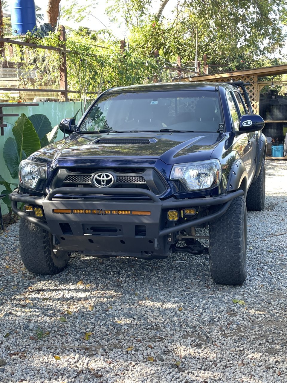

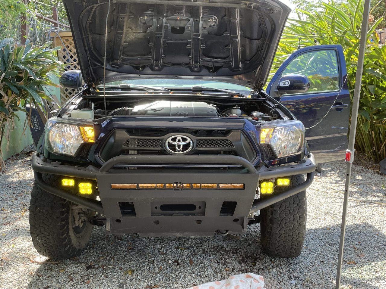

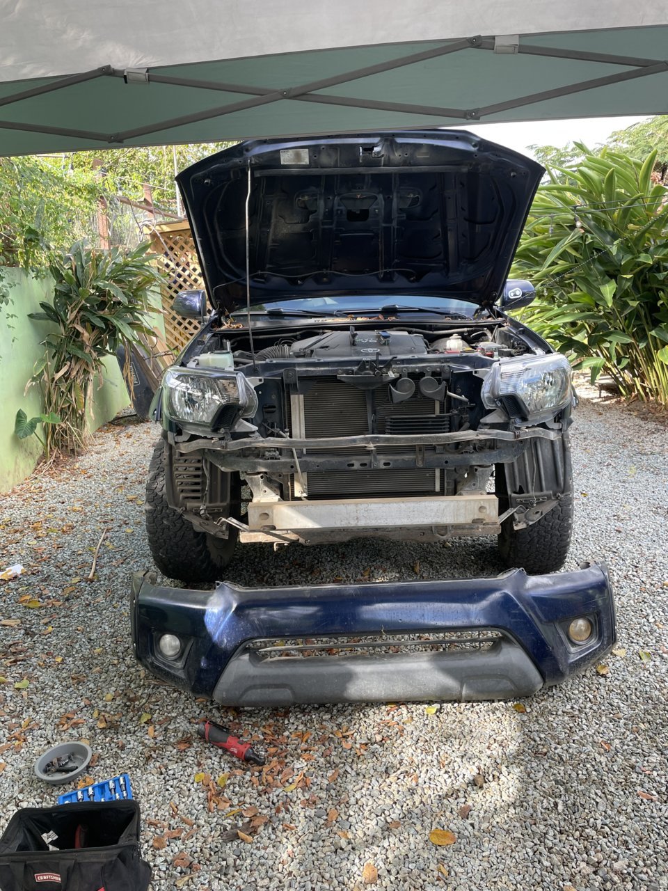

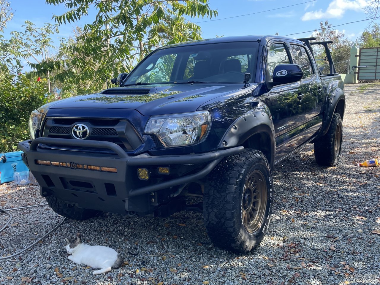

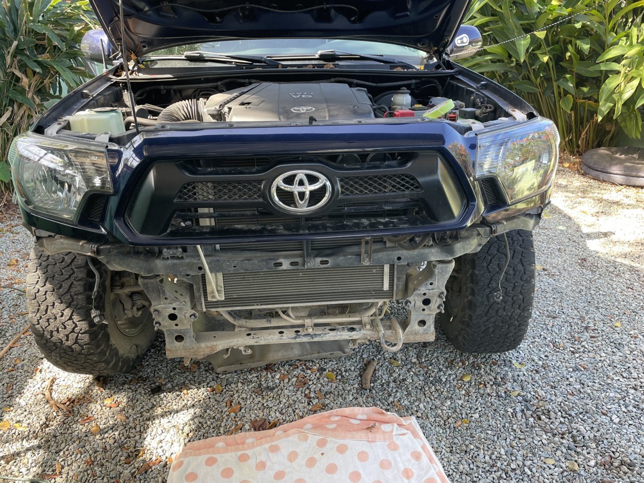

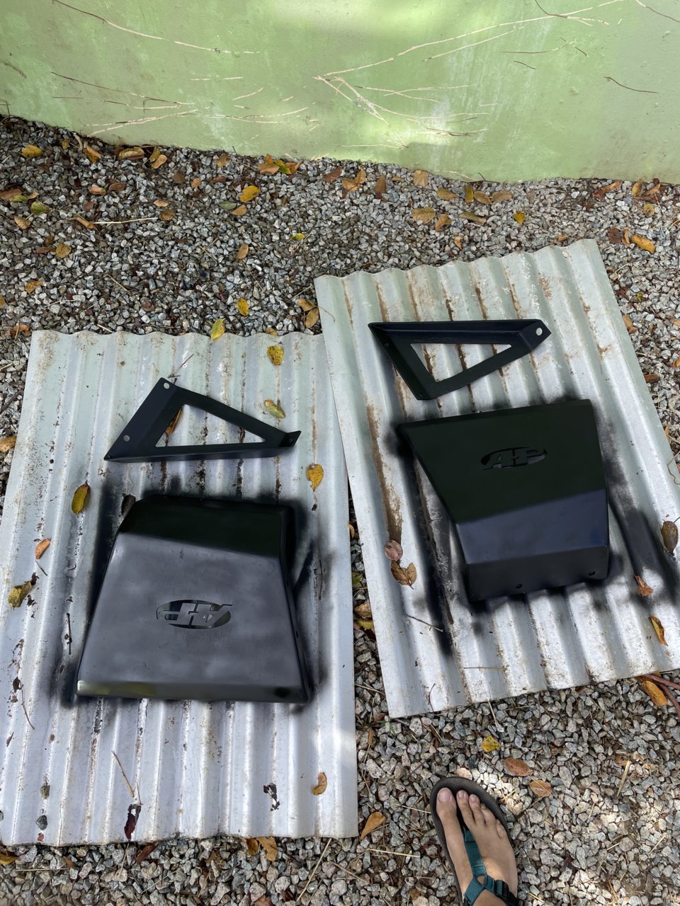

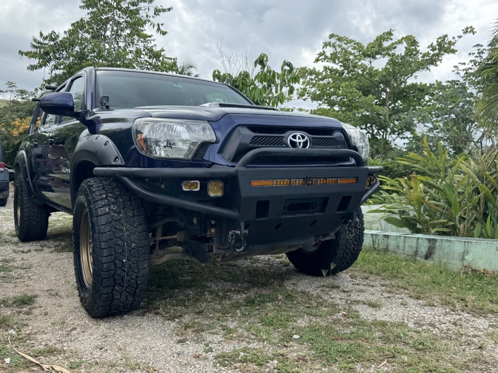

    Did the bumper install. Much more painless than expected. I had all the disassembly and trimming done in about 90 minutes, then waited about four hours for help to lift the new bumper into place. Ended up spraying a bunch of stuff with rubberized undercoat, including all the sub braces, a-arms and skid plate.
    Old crusty bumper removal:
    Helper and cutting various bits for fitment:
    Grill refit:
    Fog light wiring up and running. Still need to wire up the light bar to the high beams:
    And a front end shot, need to go out for an actual photo shoot:
    the passenger side is sitting about a quarter inch lower. Looked even when I was tightening things up. I think I might snug the whole thing up closer to the body lines.
    All my armor, cosmetics and lighting is pretty much done. May swap the grill at some point. Next step is suspension and 33’s.

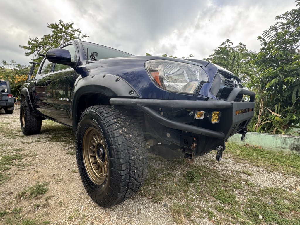

    And a better photo of the old girl. Light bar didn’t get tightened enough and worked itself loose, so I’ll fix that tomorrow.

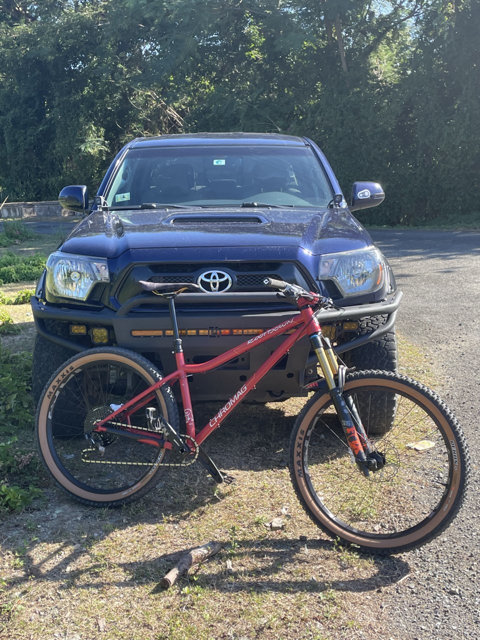

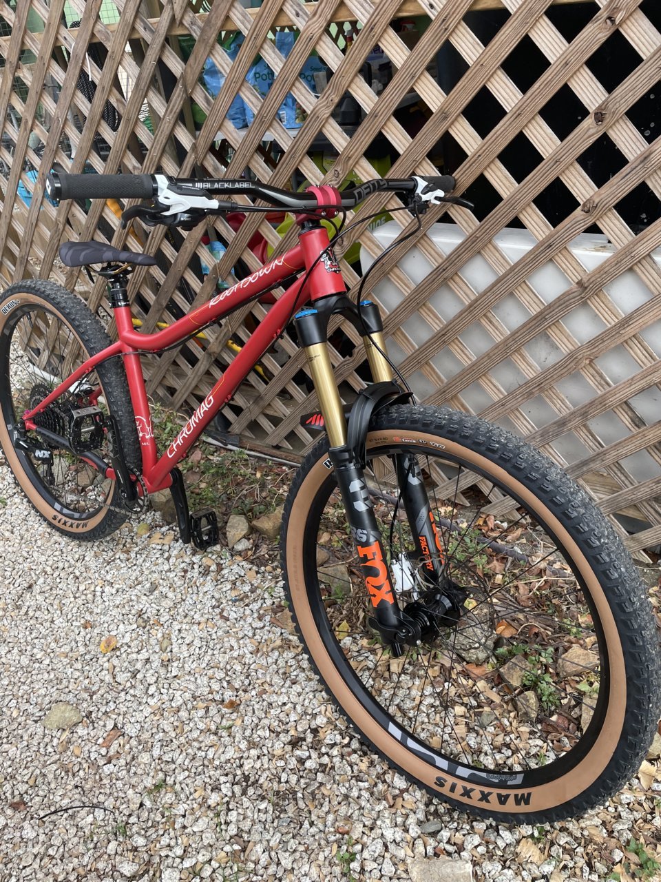

    Took the new bike out for its first ride. Man, this thing just wants to absolutely fly downhill, what a ripper.
    F1E9D730-122E-4ED4-84FF-2D74F10CD5FE.jpg 2DCC219D-4564-4758-9247-5207B90D9B6B.jpg 6C7C62FB-CBF7-4959-828F-FB05F33C87FE.jpg

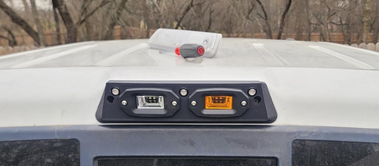

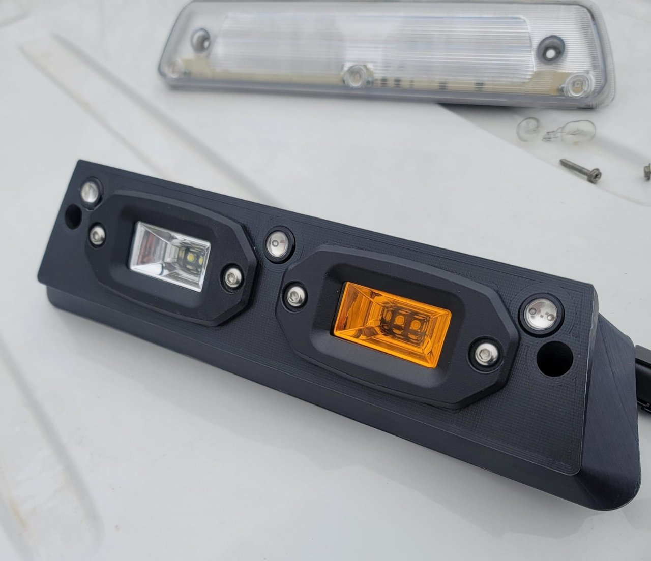

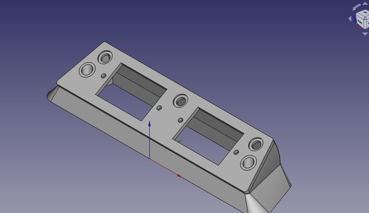

    So, I think this will definitely be one of my next small projects (idea and photos courtesy of a Facebook group member, this unit is for a Raptor):
    7DE2CE1A-74F7-4239-8AB8-DB0C052F50CD.jpg F88B31CF-86A1-4219-B106-271187A9E79A.jpg 482016EF-05A7-43E6-A363-C2A440D05A7C.jpg
    I saw some cool 3rd brake light options for 2nd gens, but most are discontinued or constantly out of stock. The cheap smoked one I got leaks and just isn’t great, and I’d like to add bed lights and more functionality. I have a dialed 3D printer, so I’ll just need to build a simple enclosure for it using ASA.
    I also want to use similar lights mounted in angled brackets, which are then mounted in the t-slot in the bottom of my roof rack. Heck, there are a number of ways I could mount them up, I just need to take the time to draw everything up in CAD.

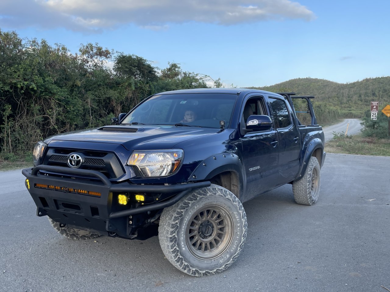

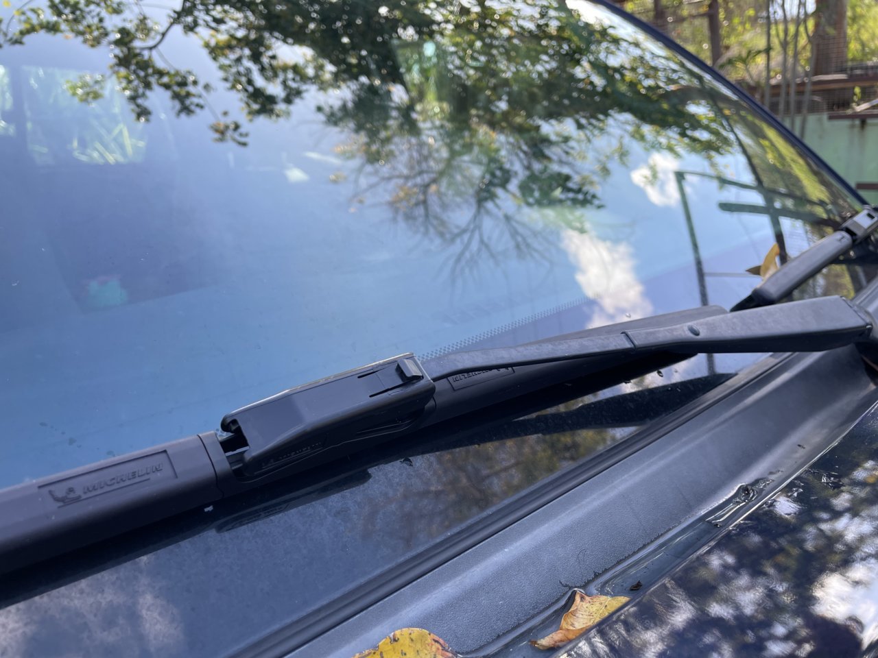

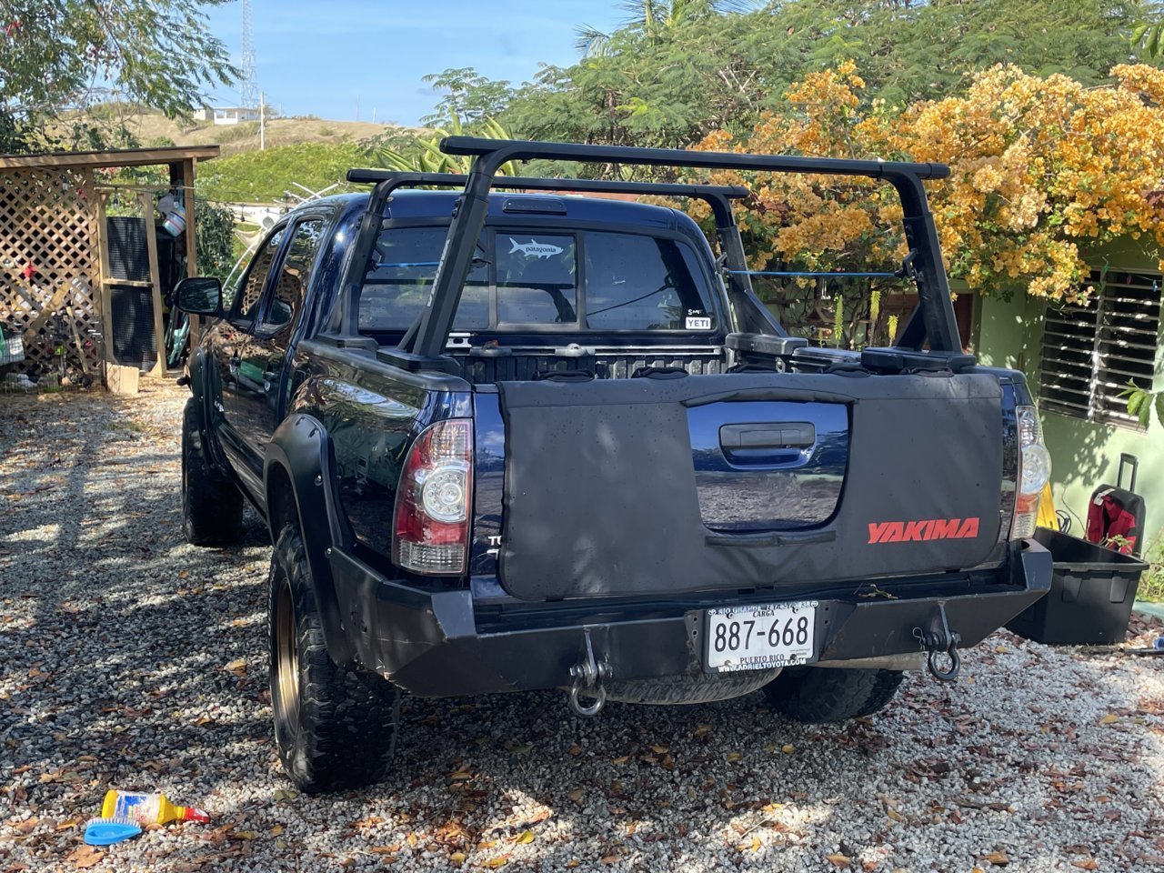

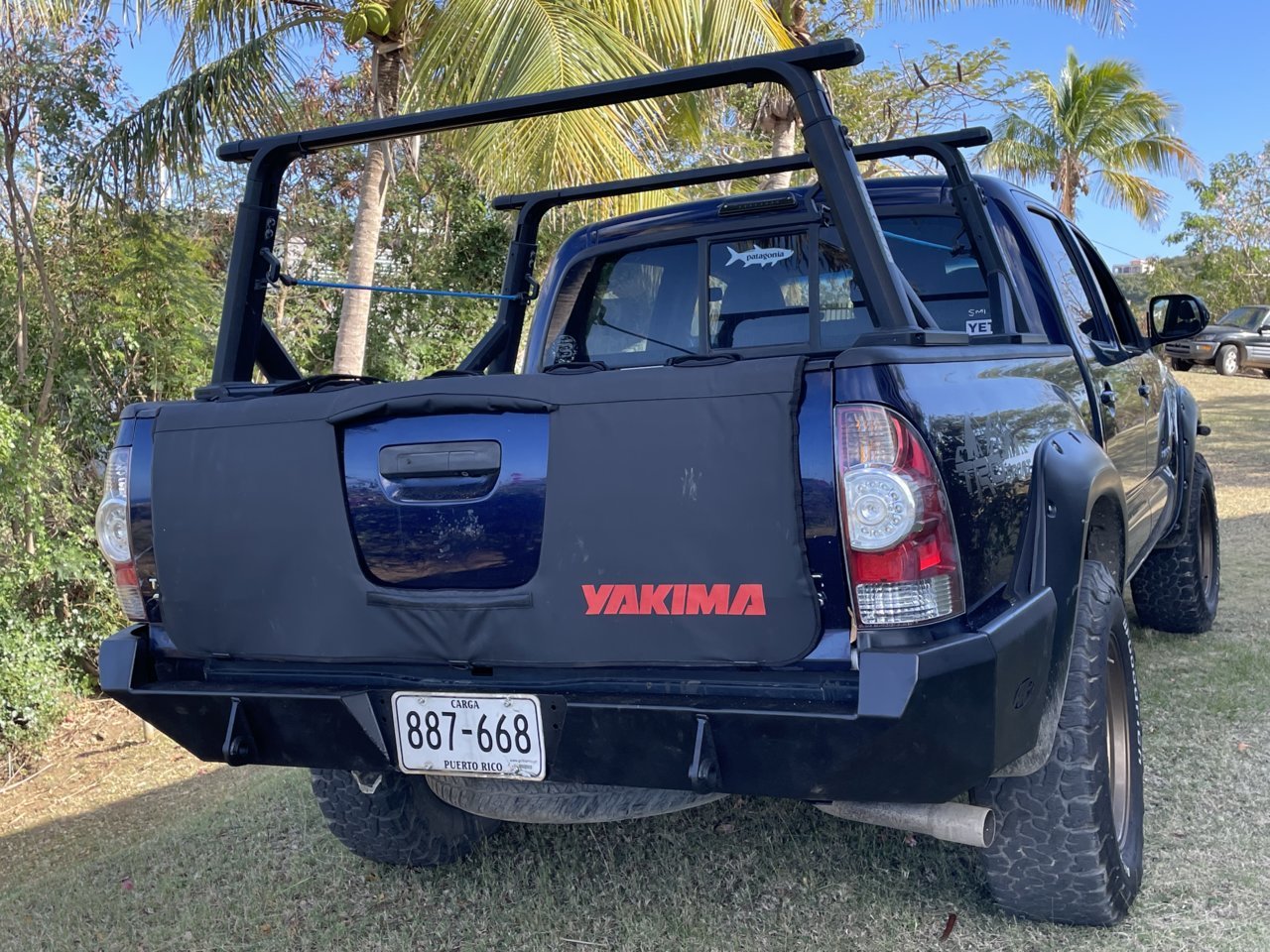

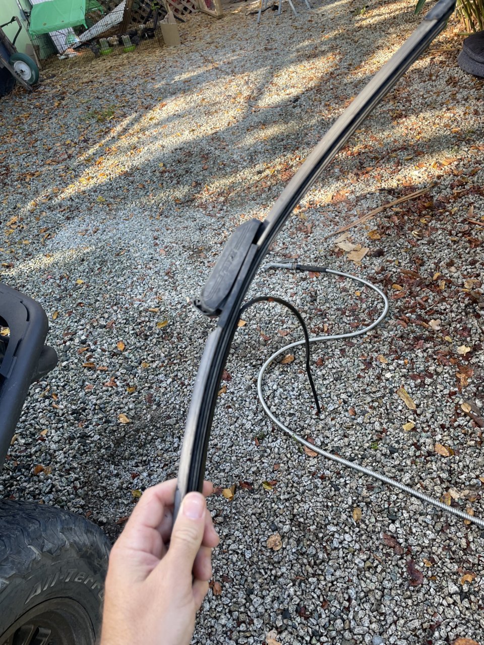

    Wash, ceramic coat and fitted the tailgate pad. Also replaced the wiper blades as a year in the Caribbean destroyed the old ones.

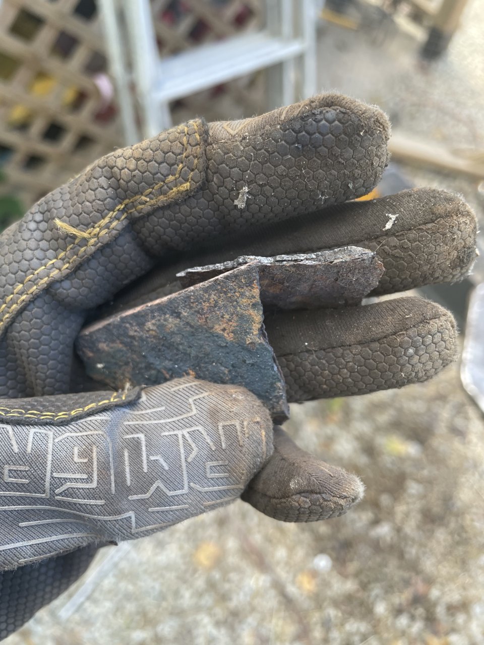

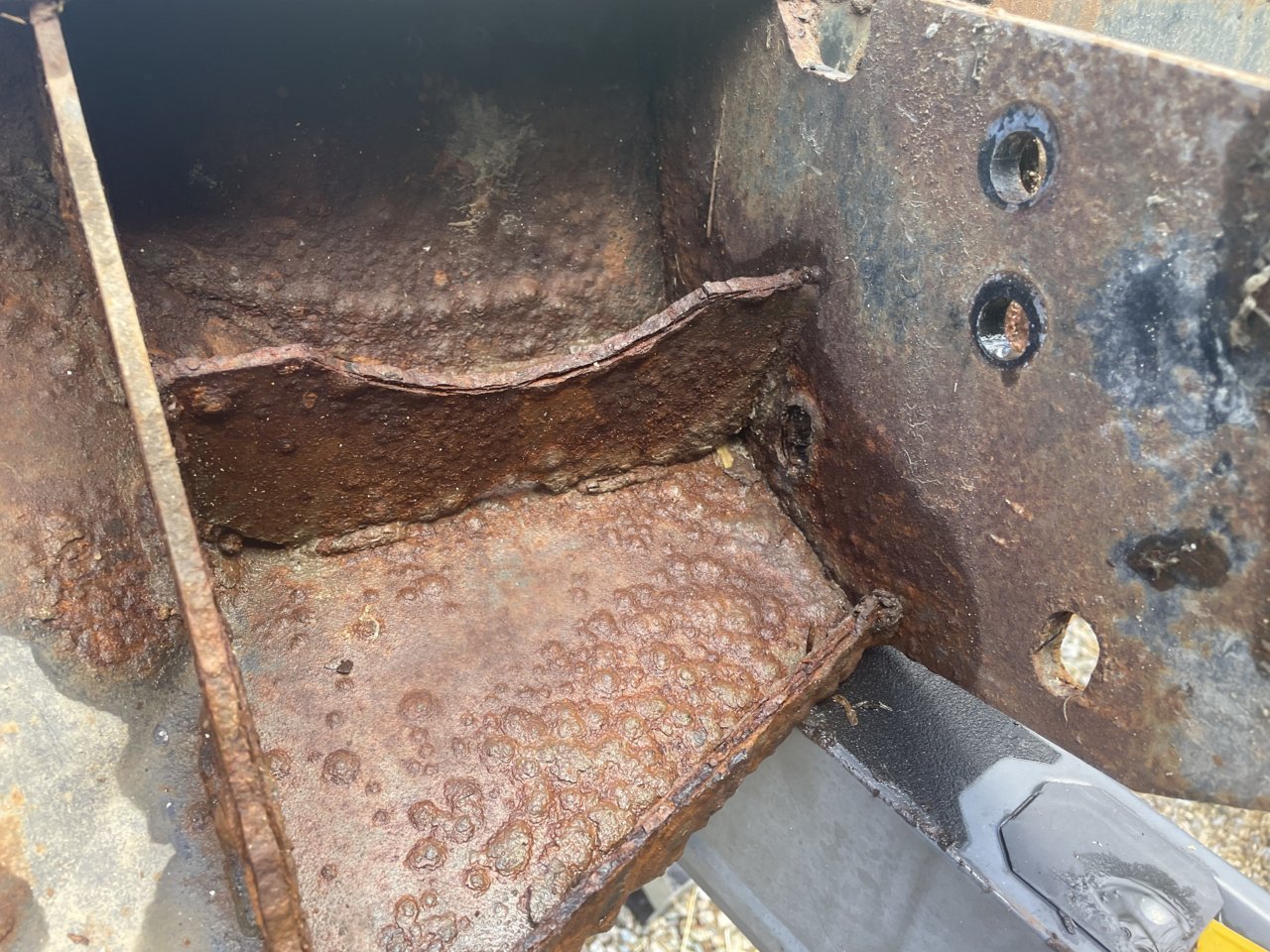

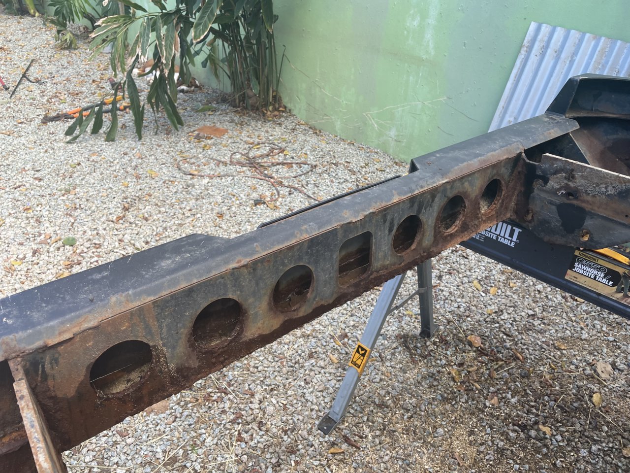

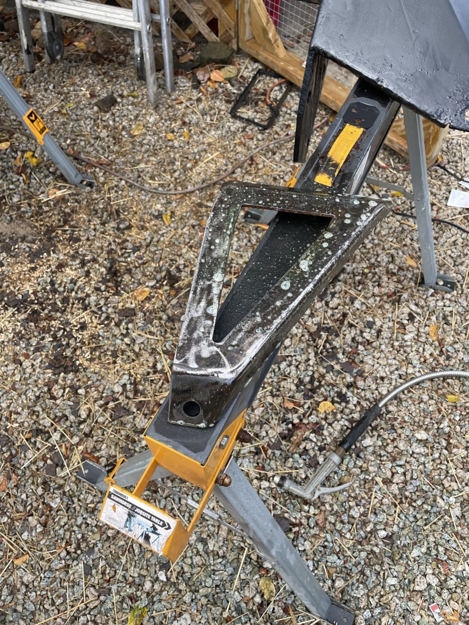

    A project I’ve been dreading (and putting off, thus making it much worse): refinishing my rear bumper. I could see rust forming for a while, and it’s started to swell and chip the last six months or so. Finally pulled it to asses the damage. It was worse than expected. Spent several hours with a hammer, cold chisel, flap disk and wire wheels to remove.
    2E3E3113-F028-49A5-80EC-6A5017E4517F.jpg 3C46FF57-4589-4C6F-B289-25101FD9081B.jpg 1922E4BC-C11D-4831-A863-2D1D2B565984.jpg
    Cont. next post.
  10. Mar 21, 2023 at 3:51 AM
    #30
    Oregonism
    Oregonism [OP] Well-Known Member
    Jun 7, 2019
    #295638
    145
    Vieques, PR
    2012 TRD Sport Prerunner
    After removing as much rust as I could without a sand blaster, I used a few cans of rust converting primer. Then a heavy coat of rubberized undercoat on all the interior surfaces and then a heavy coat of bed liner on the outside. Ten hours later, and hopefully it’ll last another ten years in the Caribbean.
    The big issue is sand and mud catching inside, holding salt and water. Hopefully the undercoat acts as a moisture barrier.

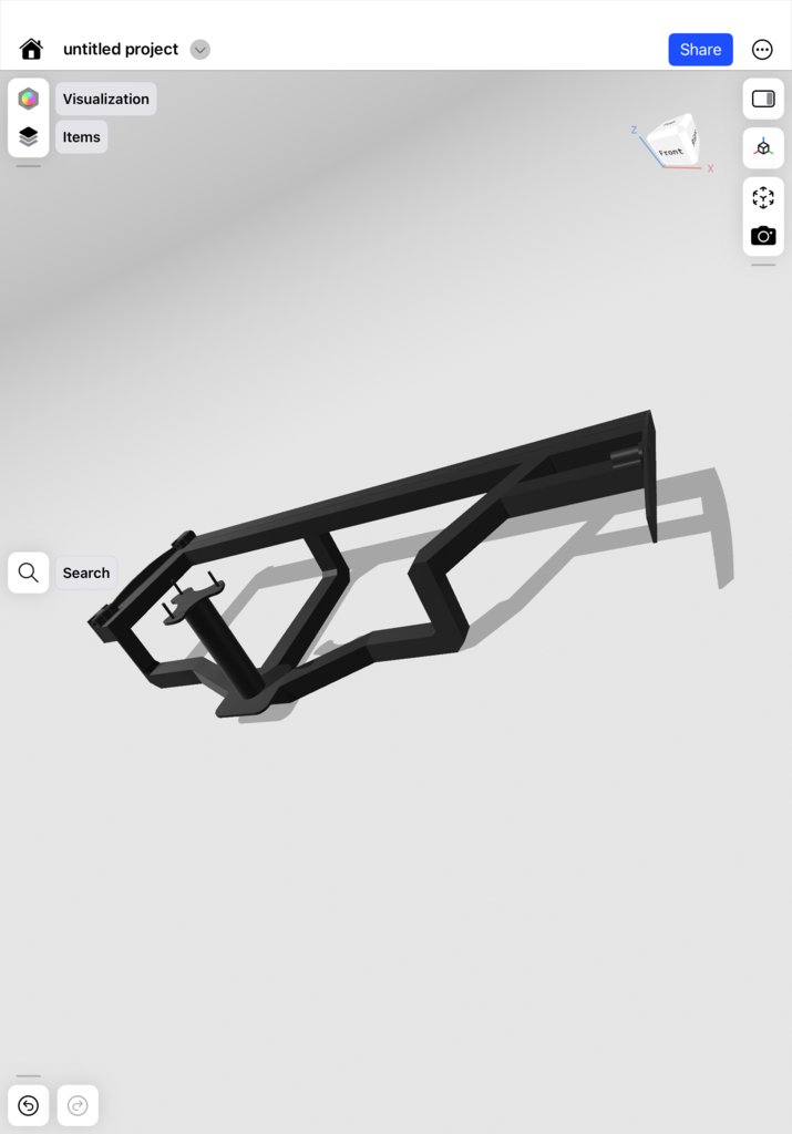

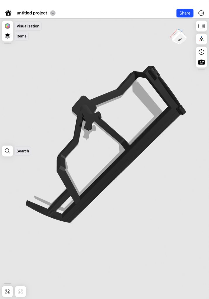

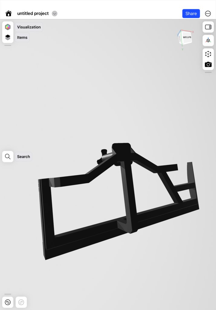

    Working on designing my new tailgate to replace my rusted-through, bent to shit stock one. This is the current brain-storm/iteration:
    There will be a mount for a hi-lift and I think I'll swap the hard mount/studs with a tray and eyes for a strap to hold the spare. I'd also add a bike rack to one of the bed rails, as I currently just have a tailgate pad.

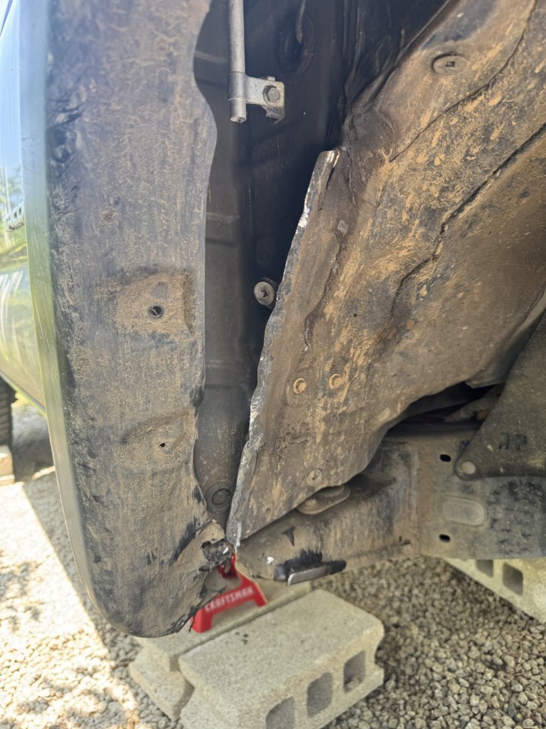

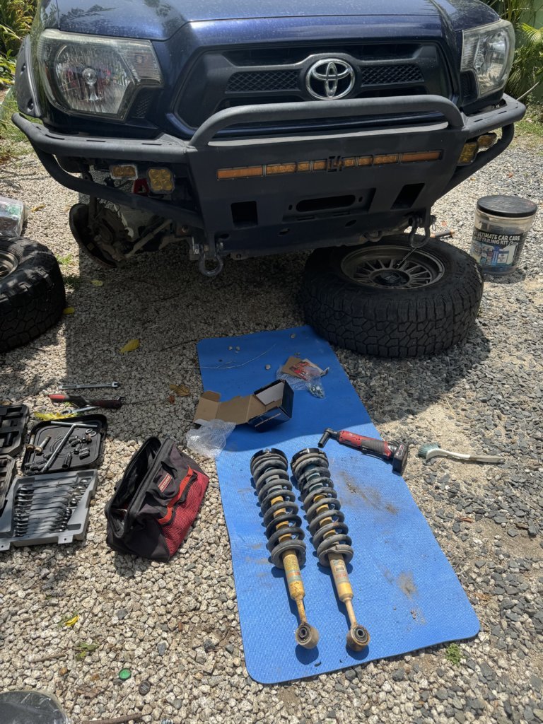

    Installed some lift spacers for about 2" in the front to better clear the 34's. Also hammered the pinch welds. Still need to tinker with the liners a bit more as it still rubs very infrequently, but much better than it was. Basically none at all unless it's flexing and none on the cab mount after lifting.
