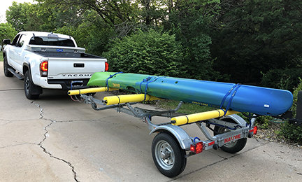

    Bed extender. Malone trailer. Thule Hullavator (spiffy lift assist).

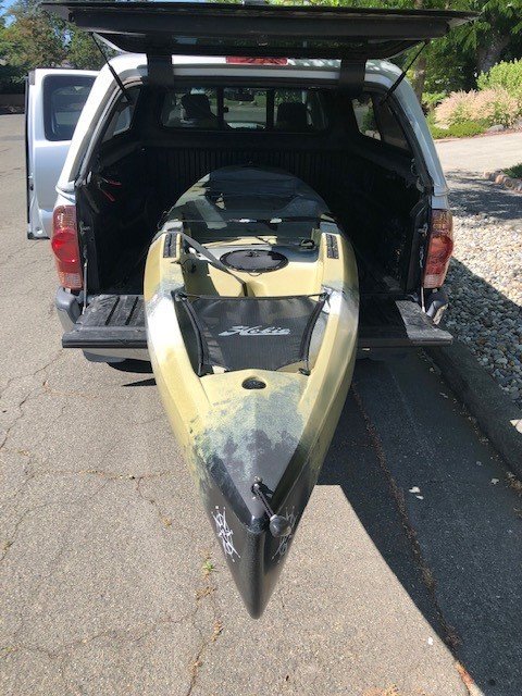

    like everything, i over-thought the problem. it barely cantilevered past the tailgate. approx 3.5'.
    i'll work on the rooftop option as well if i have cargo in the truck-bed as well. i got the boat home with zero fanfare.
