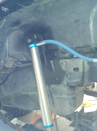

    TC 3.5 LT, RCV axles, Demello sliders, BD light bar/fogs, LP6, DMZ rear, SOS skids, custom bumper, King 16" triples, Locked-on hydro rear bumps...
    I think with lift, the max you could fit would be some tens. I have SUA on mine and I have a shock relocation for 12 inches. It took ever bit of space to fit that 12.

    If you search "Shock relocation" you should find some answers and more pics, you will also need all pro extended rear brake lines. Check out BAMF they have cool shock relocation kit for 2nd or 1st gen that you can run a 12" shock and get full travel from the All Pro leafs...:thumbsup:

    Definitely relocating the upper mount.

    Like that setup! Think I might have to save up for that!
