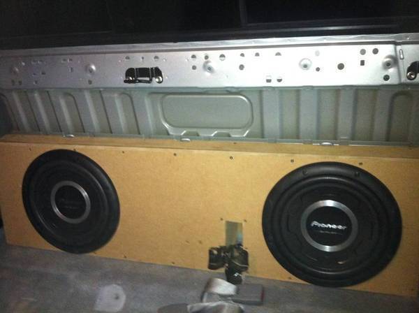

    I'm running 2 12" pioneer shallow mounts. I think they sound great for shallow mounts. I think I have a pic of me test fitting my box in my gallery. I'm on my phone and can't pull it up
    Pre-raamat, ensolite & carpet.
