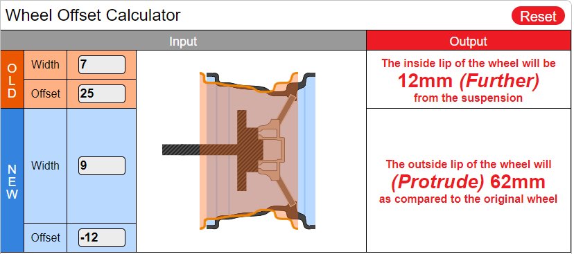

    I’m looking at putting KMC723 wheels (17x9 -12offset) with Toyo open country ATIII tires (265/70/17) on my stock 2019 TRD sport suspension. Has anyone ran the same or a similar setup? I’m trying to find out if I’ll have to worry about rubbing or any other potential issues. Any help/insight is very much appreciated! Thanks for reading everyone!

    @B_D_J23 it will rub when you turn. Zero offset is more common but in some cases you still have to trim the mud flat, or remove them.

    Can you attach a link to that calculator you used?

    @Acwood I do apologize, but the calculator we use is internal and does not have a link to it. The best I could do would be this LINK. I hope this helps.
