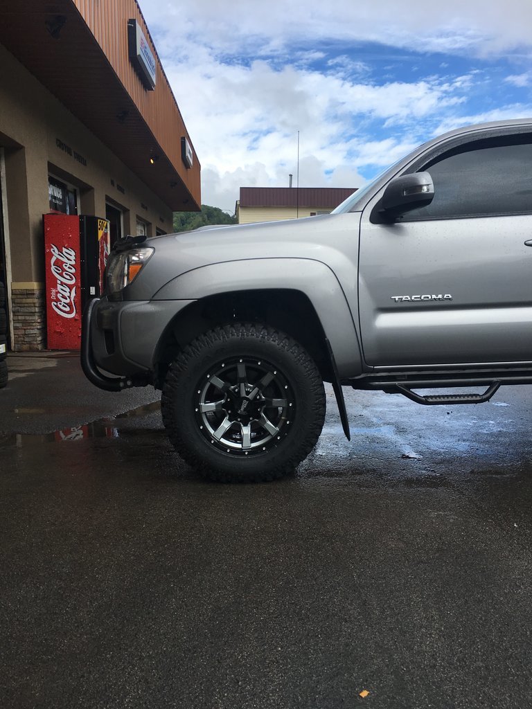

    IMG_0894.jpg Mine seem to rub but can't find it! Has 3 inch lift. Only on certain right turn curves it does it. Any help would be appreciated!

    Mine rubbed on the mudflap on drivers side, just a bit, ended up taking the mudflats off and making sure my caster was around 2

    Very similar to my setup. I took the front mud flaps off and was good to go.

    Thanks I took flaps off already. Have to check my alignment print off to see castor setting

    Welcome! Check those mini-flaps in-front of the tire (not the mud flaps behind). That is where mine rubbed.

    Nope still no rub marks. It seems to be on passenger side. I'm beginning to think it's cab mounts so I marked them with grease. I took the little flaps off too

    Ok not cab mounts. Going to put it on rack and have it checked closer

    Ok all I can’t find nothin!!! Goin to order a new set uca’s And make alignment better. I honestly think it axle binding idk yet!

    I have -12 offset and 265/70/17
    3 inch lift and had to eliminate mud flaps! My tires are Goodyear athouritys

    4.5" backspace is best...but mudflaps most likely will have to go

    17x9 4.5 is my back space

    Hmmm recheck alignment...is your fender well missing any screws and hanging? with your setup having any rubbing is odd..definitely a noodle scratcher

    Yea it only does it ever so often sounds like rubbing but it’s almost like something’s binding. May drive it three days then it will do it . Think it has to be in my alignment ! Gonna go ahead and put ucas on it anyway .
