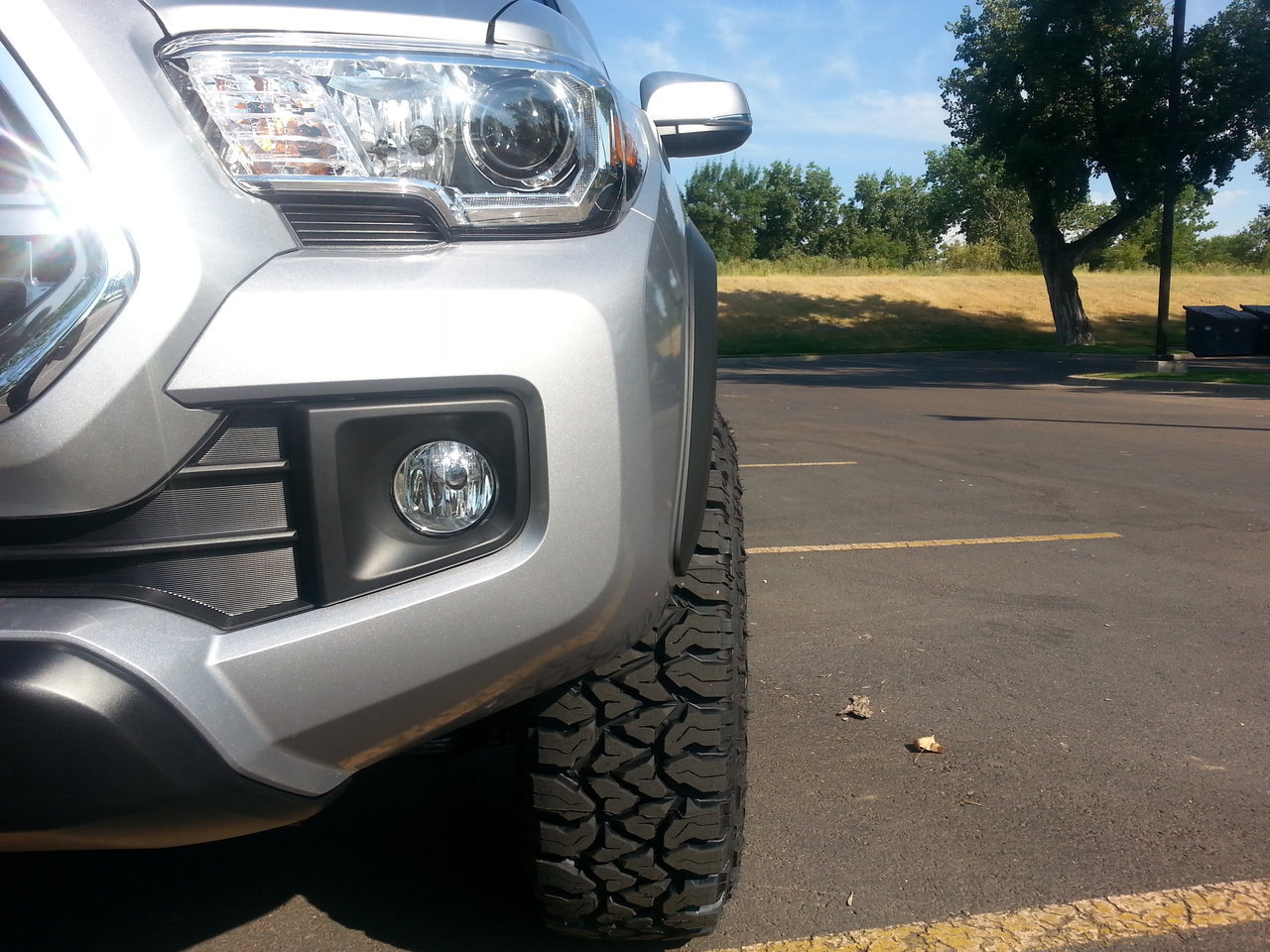

    You've got the offset backwards but everything else is good! Negative offset pokes out further. You should be fine OP, this is what approximately speaking -12mm offset wheels will look like. It's actually stockers on a 1.25" spacer, meaning that the net is +30mm - 36ishmm so approximately -6mm but that's pretty darn close though. 20170827_144821.jpg EDIT: these are 255/85-16 tires

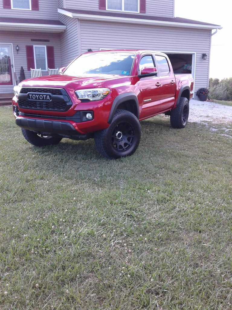

    Hope this helps.. -12 offset 18x9

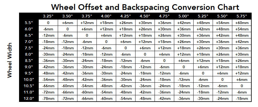

    I'm sure it's been mentioned but if not I'll chime in. You need to know wheel width, offset, and backspace to know exactly how to compare wheel poke/tuck. For example. I currently have a 17x9.5 with -18 off set which comes to a 4.5" backspace. Most likely will be temporarily installing a 17x7 with +4 which comes to a 4.25" backspace. By just going off offset it's a 26mm difference, or 1" of tuck but actually I'll really only be pushing my wheel in by .25". Here is a chart to give you an idea of how to compare all the measurements.

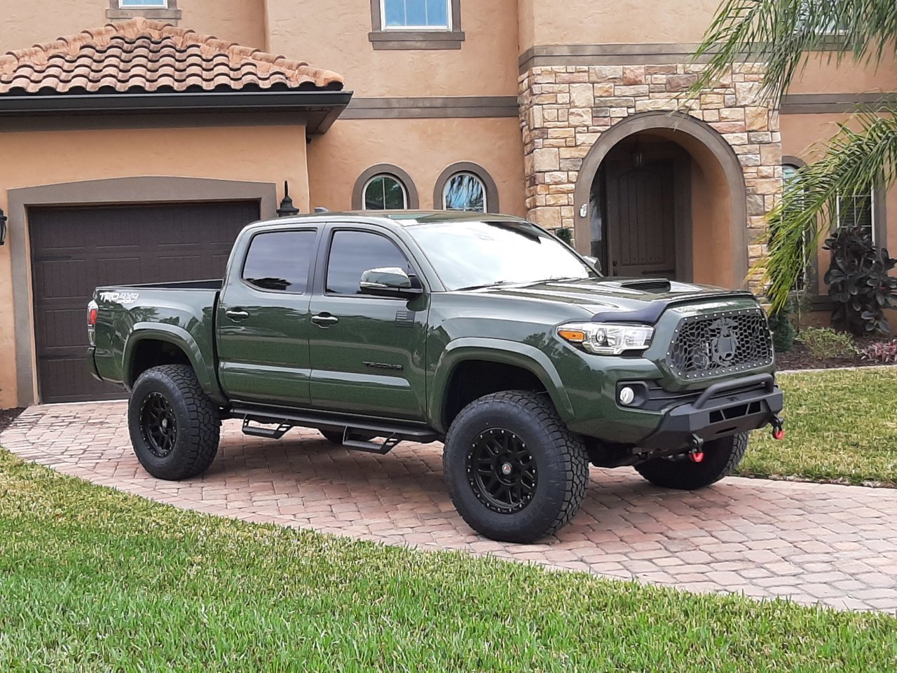

    -12 offset with 285/70/17s. Just ordered RDJ fender flares, which should give me more width over the tire. I fling a lot of debris up on the paint and I don't want mud flaps.

    Sweet ride and I love that green! Do you have a lift? Also just because I am looking at that same font bumper what is the weight of it?
  20. Mar 28, 2021 at 10:36 AM
    #20
    ljh824
    ljh824 Regular Guy
    May 8, 2012
    #78409
    1,038
    Lou
    Kabul, Afghanistan / Oviedo, Florida
    -21 AG Sport 4x4 DC
    Yes, 3in front, 2in rear. that's a Body Armor HiLine bumper. I think it's only around 45lbs or so. Cant really remember. didnt add too much weight to the front.
