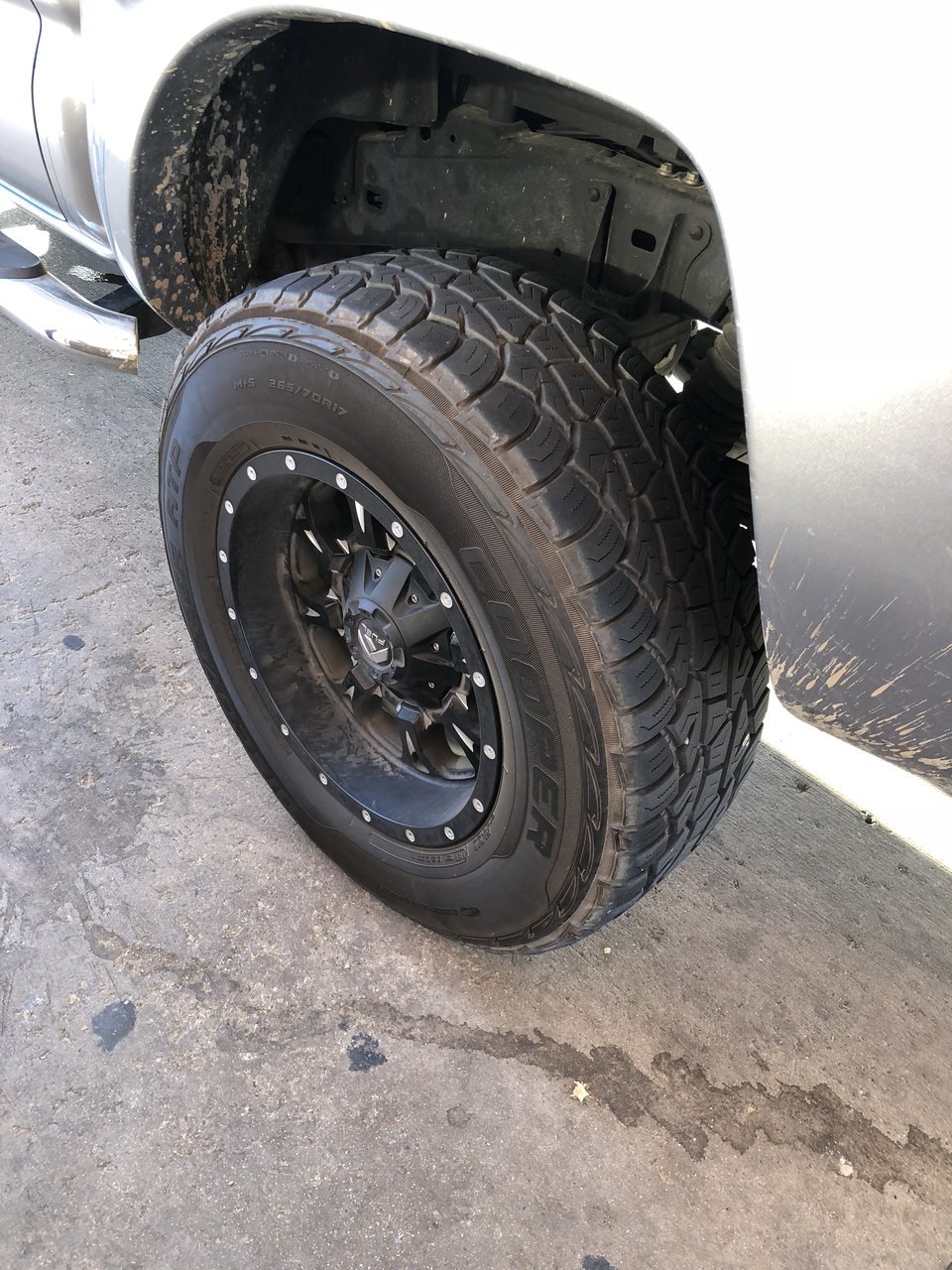

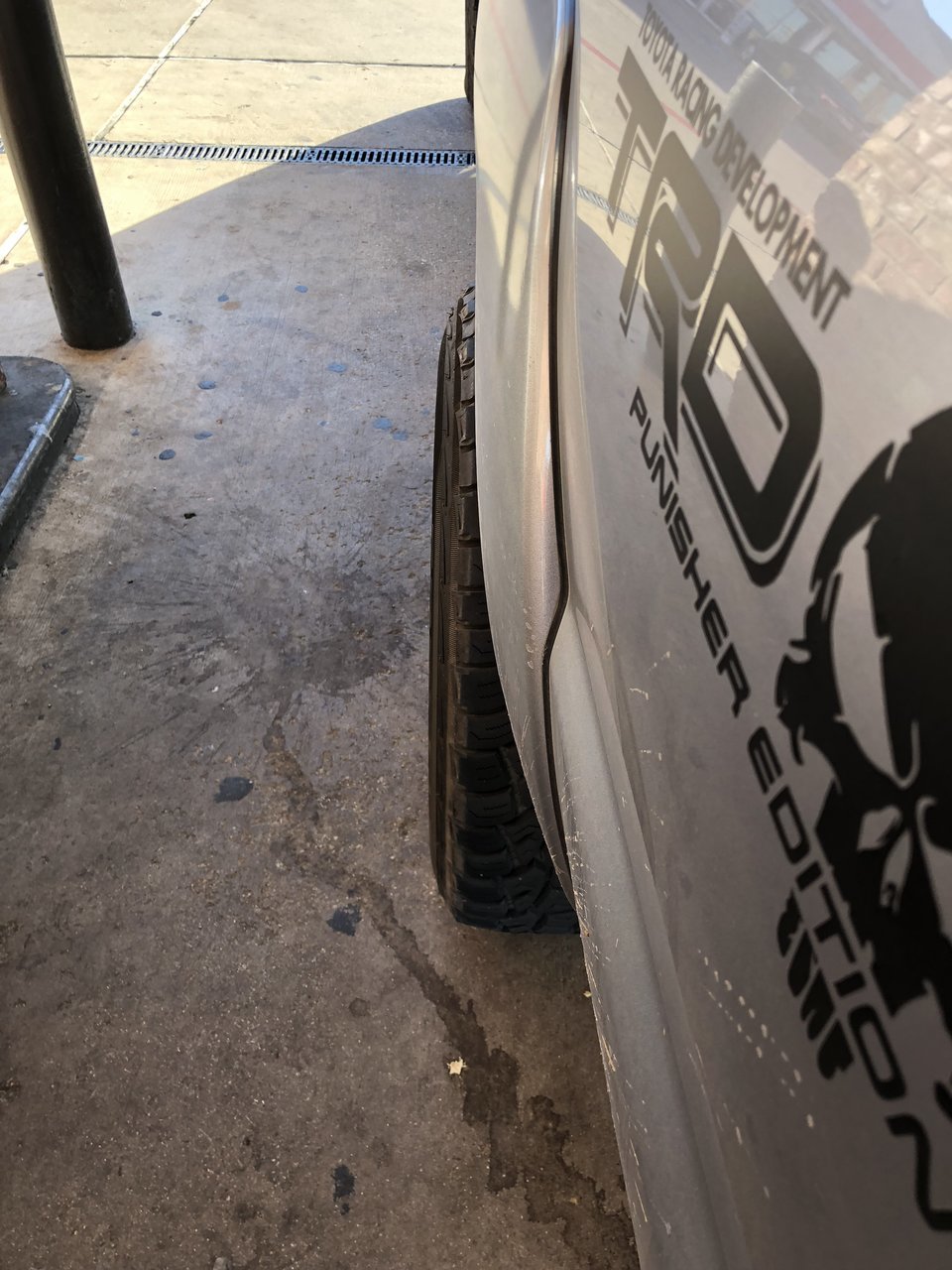

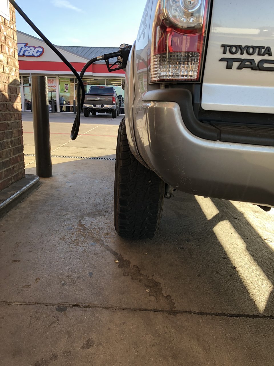

    3 in lift, 17x9 -12 offset Fuel Krank wheels,New decals, Bull Bar,
    BD1C82A5-518A-411F-9CEE-7F85FBC96E71.jpg 766E504A-2A05-48B2-BFB6-A2A603E2F9AB.jpg CF7459CF-3940-466E-9679-621242C0561C.jpg These are Fuel Kranks 17x9 -12 offset with 265/70/17

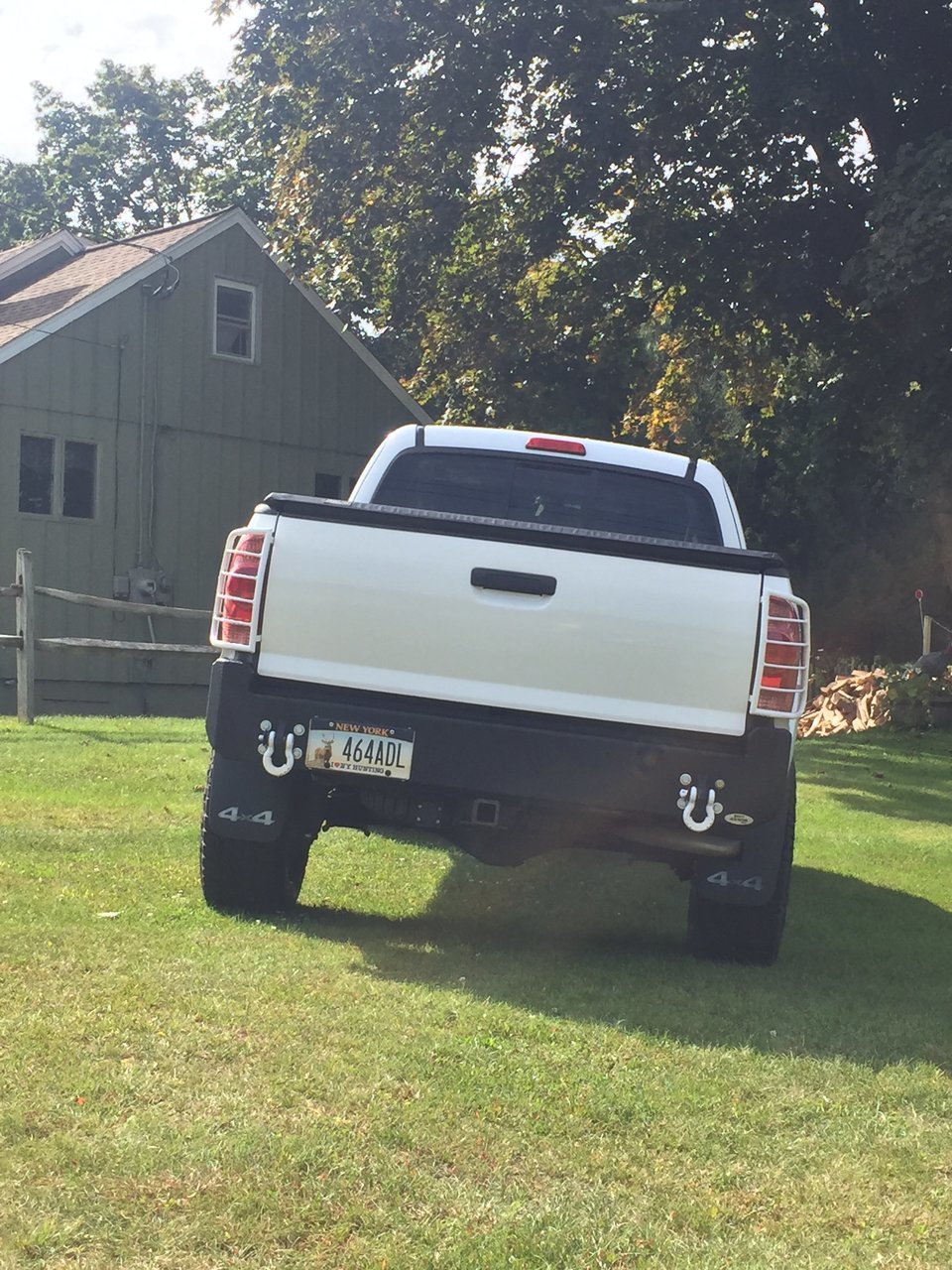

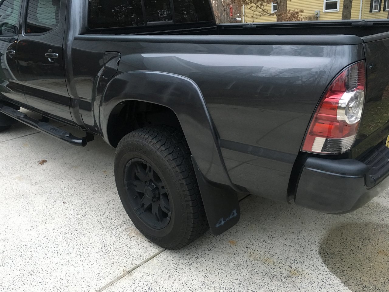

    E9CBAE7C-008F-493B-81BB-AAE7EC9AE18B.jpg4.5 backspace , -12 offset 285/70 17

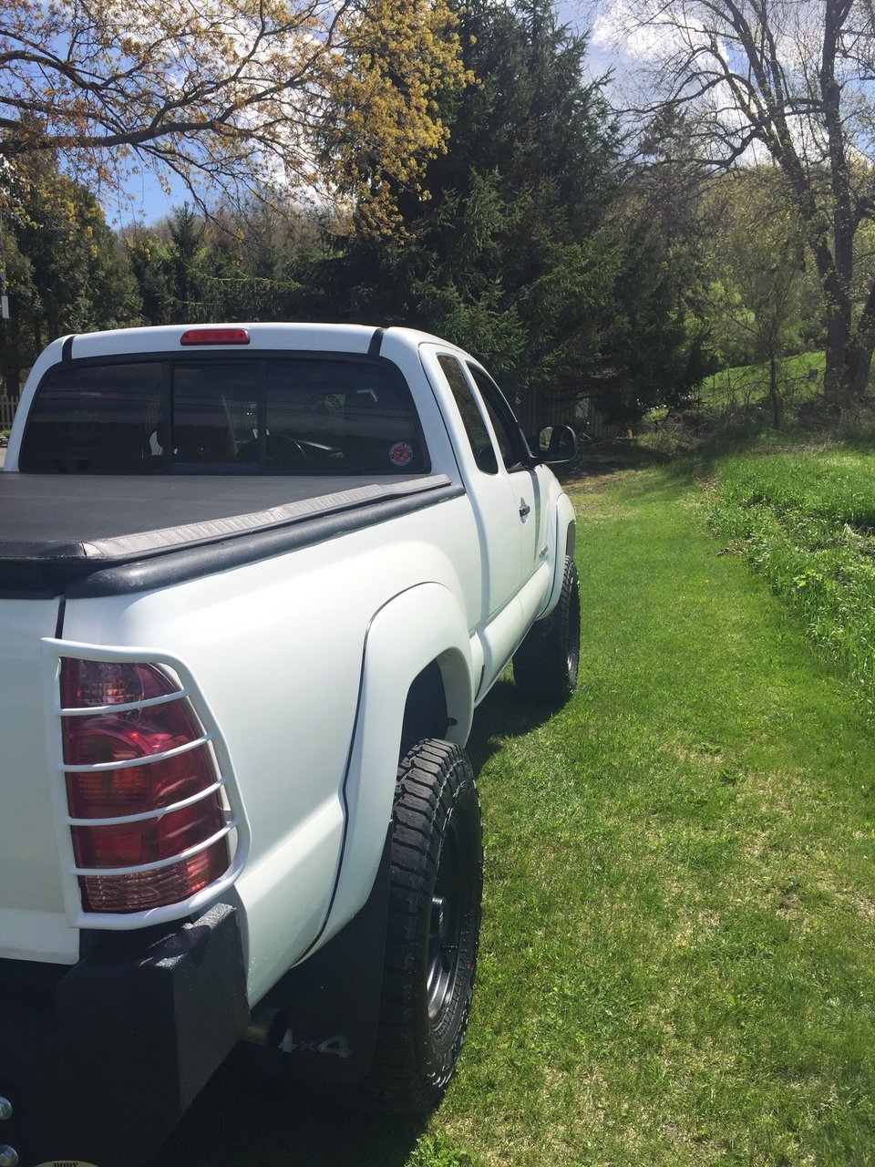

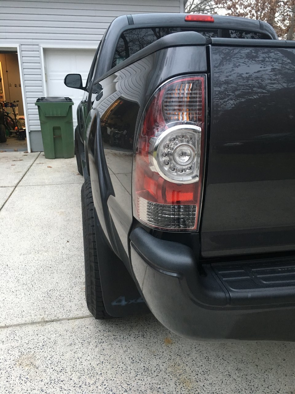

    76E8864F-AA59-40A0-B0BD-D7DE3EEADC38.jpgwheels are 17x8

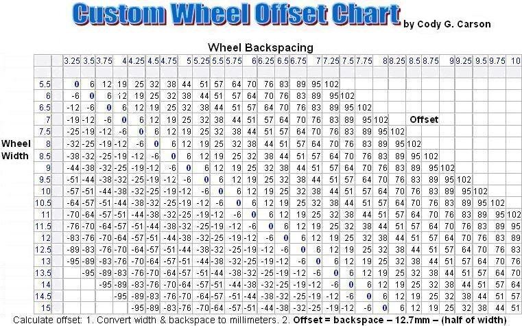

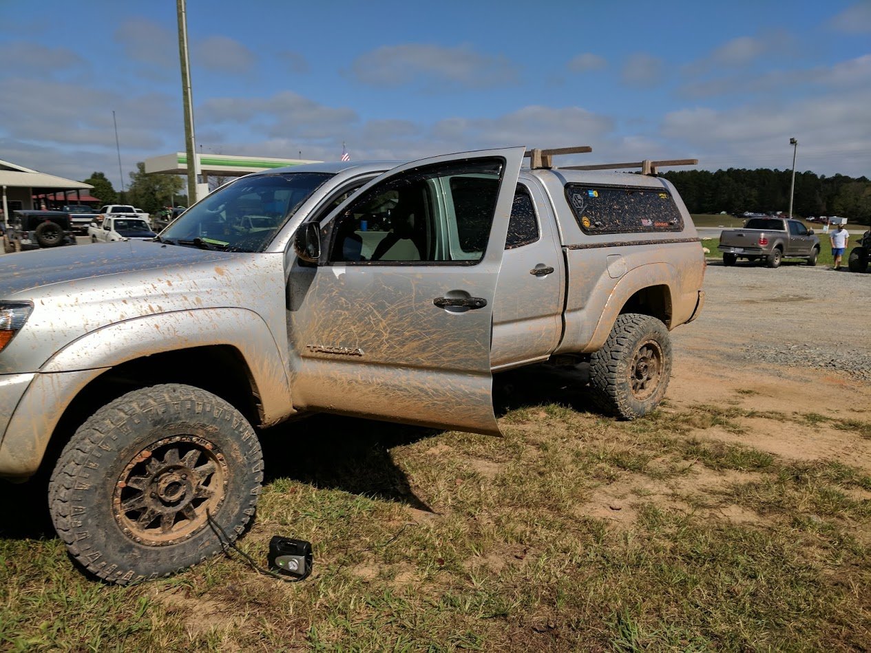

    Some
    -10 offset w/ 4.30 back space
