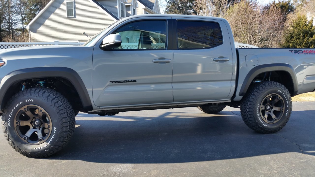

    I went with -12 offset. Had 3 seperate alignments till I got it right and basically only rubs at full lock

    Yours is a 3rd Gen...

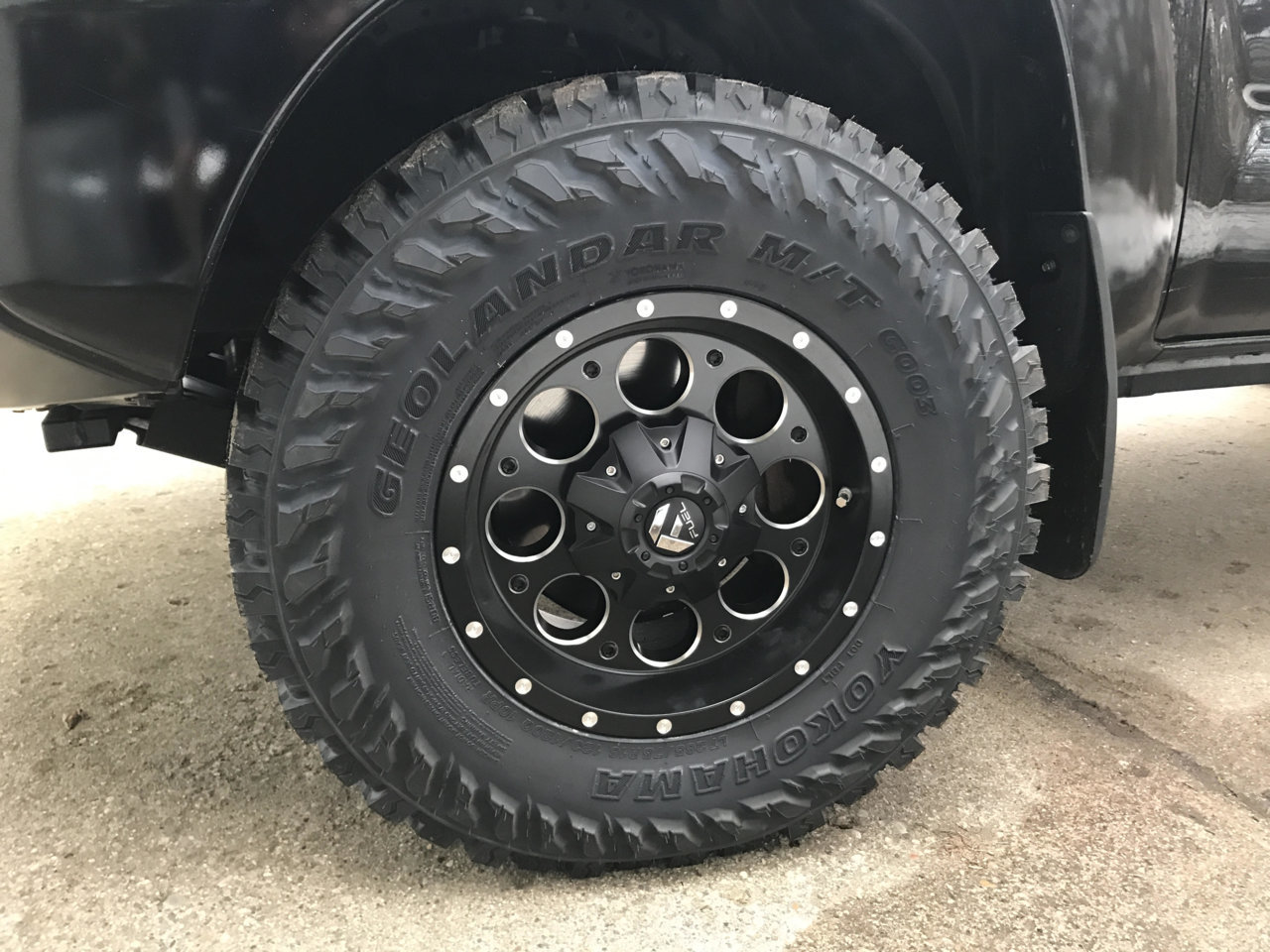

    @Rydah I had to remove the front little aerodynamic flaps on mine, just so you know. I think my issue is the aggressive tread nubs were knocking on it at full turndrivers front.jpg

    Yeah, not planning on running MT, just AT right now. Looks like you might be running a lift though? Thanks for the help

    just the third gen suspension take off I bought on here...about an inch and a half or so in the front and I run ATs in the winter with the stock wheels. Just about ready to swap them over in the next month or so actually
