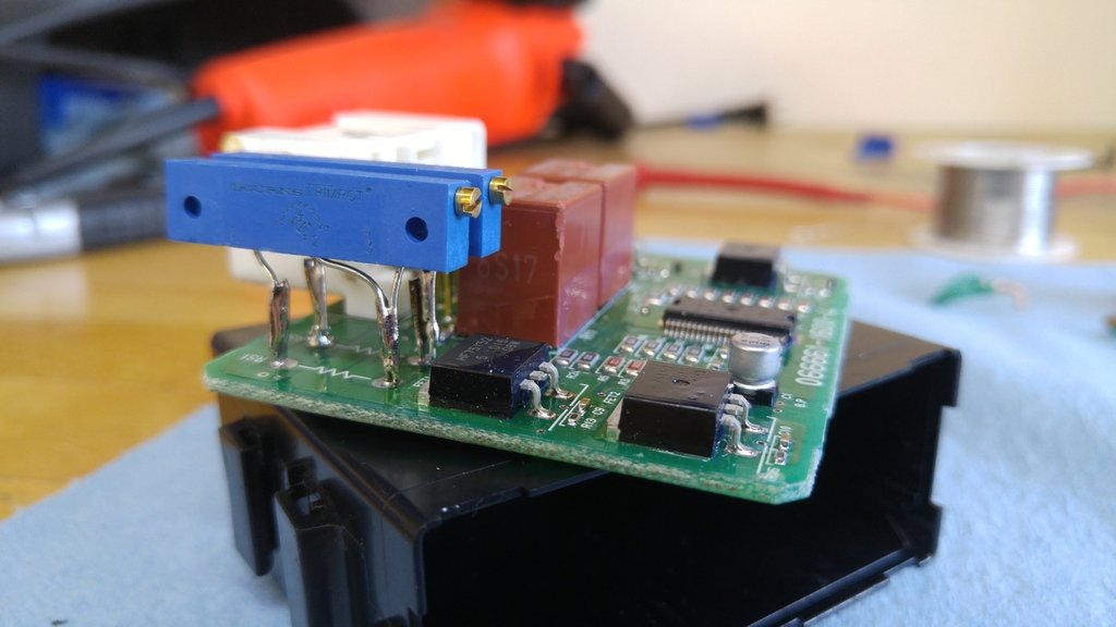

    So I figured as an experiment I would get the trimpots and give them a try. The best solution I could find was this:
    https://www.digikey.com/product-detail/en/bourns-inc/3059Y-1-100LF/3059Y-1-100LF-ND/2535059
    It is 0-10 Ohm and has 25 turns, so I was hoping it had enough resolution (really it's 'unlimited resolution' but you need to be able to hit that with a screw driver..)
    It worked! I tested it off the board first and while my MM isn't super high quality it allowed me to find the low side of the adjustment (theoretically should be 0 Ohm but probably isn't). It read 0.5Ohm but I don't think the MM is accurate below 5ish
    I installed just one at first to see if it would work and then left the board hanging under the dash so I could adjust the screw. To my horror, at first it wouldn't work. It would only go one blink and then stop, indicating it was still too much resistance.
    THEN I realized I had left the incandescent rear blinkers in so that my front LEDs wouldn't hyperflash (I had already modified my shunts but couldn't get the resistance low enough - went all the way through them multiple times)
    Swapped in my rear LEDs and voila! Hyperblink, which is a good sign because now I knew somewhere in the middle of adjustment was the sweet spot. I turned it up about 3-4 turns and it started to blink normal, go too far and it goes once and stops. Confirms everything everyone has found out so far.
    This way of doing it is nice, because not only can I adjust it so that I'll still get the light-out indication - but also if I change LEDs in the future or go back to incandescent - I can just adjust the pot. I also didn't have to do 20 trips to the store for resistors and resolder everything a bunch of times.
    These are rated for 1W, but they have a cheaper 1/2W version that would probably also work - its also 25 turn:
    https://www.digikey.com/product-detail/en/bourns-inc/3296Y-1-100LF/3296Y-100LF-ND/1088082
    I got both, but kept the 1W in since I tried them first. So if anyone needs a pair of the 1/2 versions PM me
    Oh and FWIW, I used the same LEDs as @12TRDTacoma above
    GilbertOz, three west and YOTA LOVER like this.
