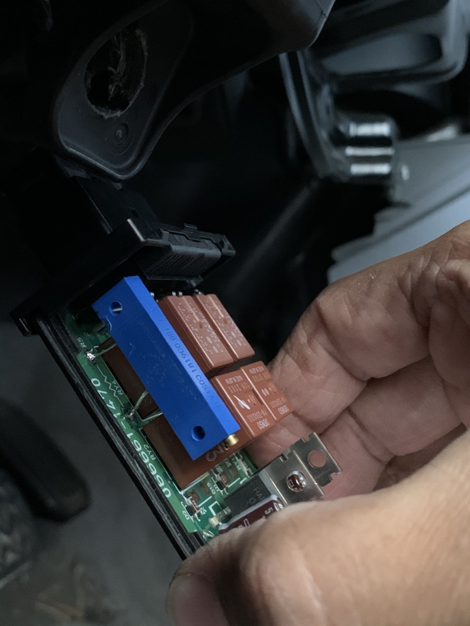

    Instead of 10 ohm 25 turn, a 5 or 2 Ohm multi turn would provide greater resolution for the resistance needed.
  4. Jun 25, 2018 at 5:58 AM
    #84
    teg33
    teg33 Member
    Mar 14, 2018
    #247267
    7
    Yes it would, but I haven't been able to find anything lower than 10 ohm. Do you know of a source?

    I threw in .15 ohm resistors and it was too much resistance so I was getting the single flash.
    Before I could get in to fix it they stopped flashing all together and even with changing the resistors I cannot get the flash to work
    The hazards also don't work. Any ideas?

    Aloha,
    Used just two leads, cut off outer one closest to trimmer. Works great! All LEDs (DRL, signal)

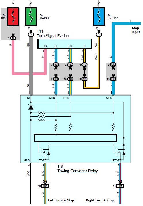

    The added load of trailer lights does not go through the flasher. Trailer lights are operated through their own fuse, and their own relay run by the flasher output.
