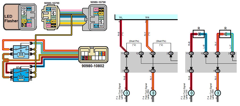

    Where can I find a 12-pin LED flasher? My truck has DTRL, so the 8-pin won't work for me.

    I don't see anything about LED in either of these descriptions.
    How can I be sure that they won't hyper-flash like my original one does?
    Actually, the one link that pictures the one without a mounting bracket appears to be identical to my original flasher...

    No such item as a 12 pin LED Flasher, especially not from Toyota.
    You'll have to add some resistors.

    That's disappointing...but what I suspected with all the checking that I've done.
    Thanks for the confirmation.

    You could assemble a harness which would include the 8 pin LED relay. It would require an additional (x2) 5 pin relays to switch from ON at IGN (DTRL) then to TURN select to front TURN bulbs.
    Something like this:
