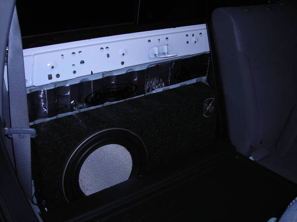

    Spend the money and get the shallow mount. I got a 12" Kenwood sub with a free Sound Ordinance box for 140 (Crutchfield, only because they ship free to Hawaii). It barely fits but it sounds awesome.

    In the first gen double cab there was much less space, and you could put a cabinet behind the rear seat if you utilized the rear wall as the back of your cabinet (a poor option IMO). With the second gen double cab you get about 7" to work with so you can at least build a cabinet out of 3/4" MDF and as long as you find a driver with a mounting depth less than about 5 1/2".
    It's not like there aren't any options right?
