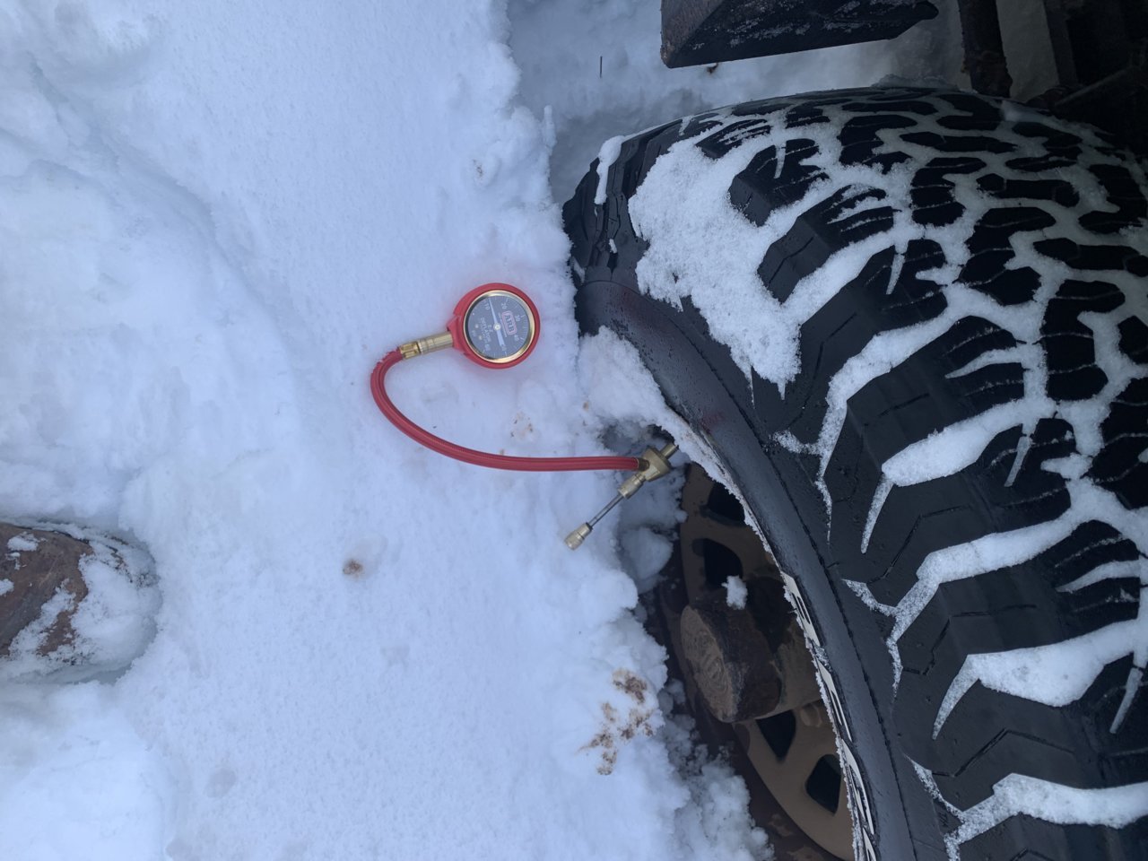

    Haven’t made it anywhere on the Tacoma, but did take the 4runner out to play in the snow.
