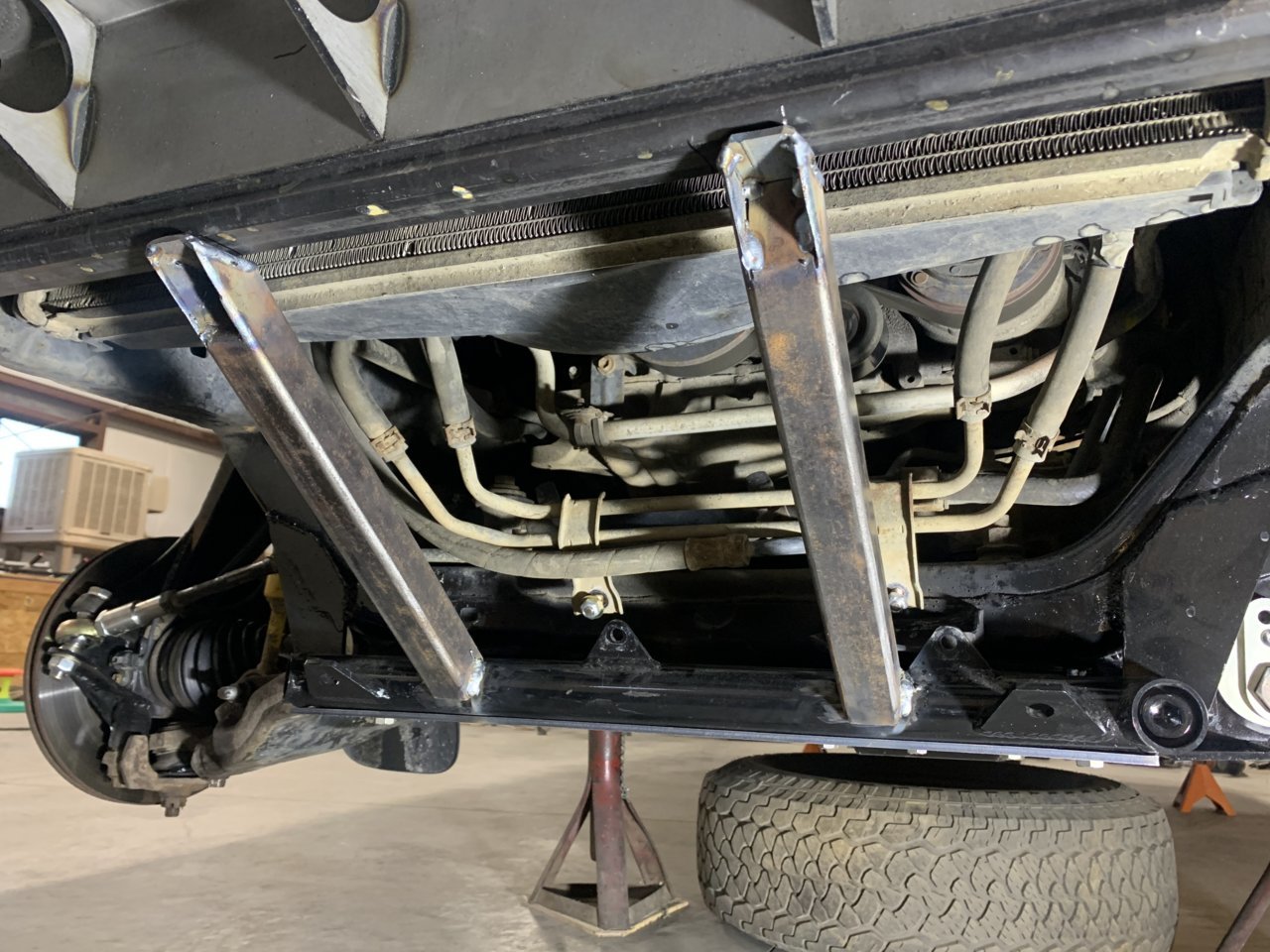

    Waiting on rivnuts to bolt the top but I think this will hold. Now to build a plate to go over them725E482C-325A-43FF-9324-DFC3EC181977.jpg

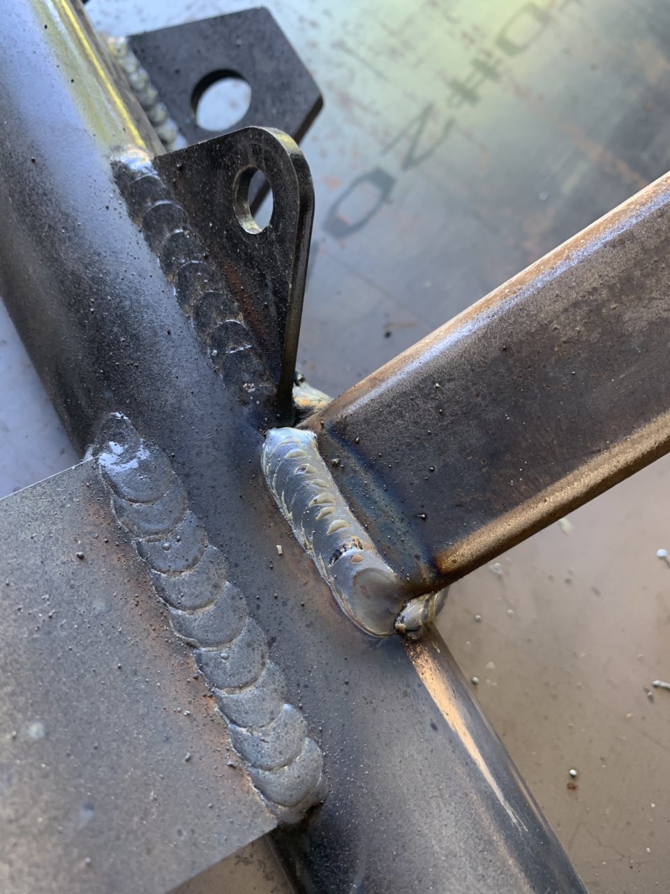

  4. May 16, 2021 at 4:16 PM
    #64
    Offthewall
    Offthewall [OP] Well-Known Member
    Jan 28, 2021
    #354363
    200
    Southern OR
    12 tx pro
    That’s why I’m here
    58277CDD-4139-465A-AFE9-896020A8615E.jpg With all this practice my welds can at least be in the same picture as Harry’s :rolleyes:

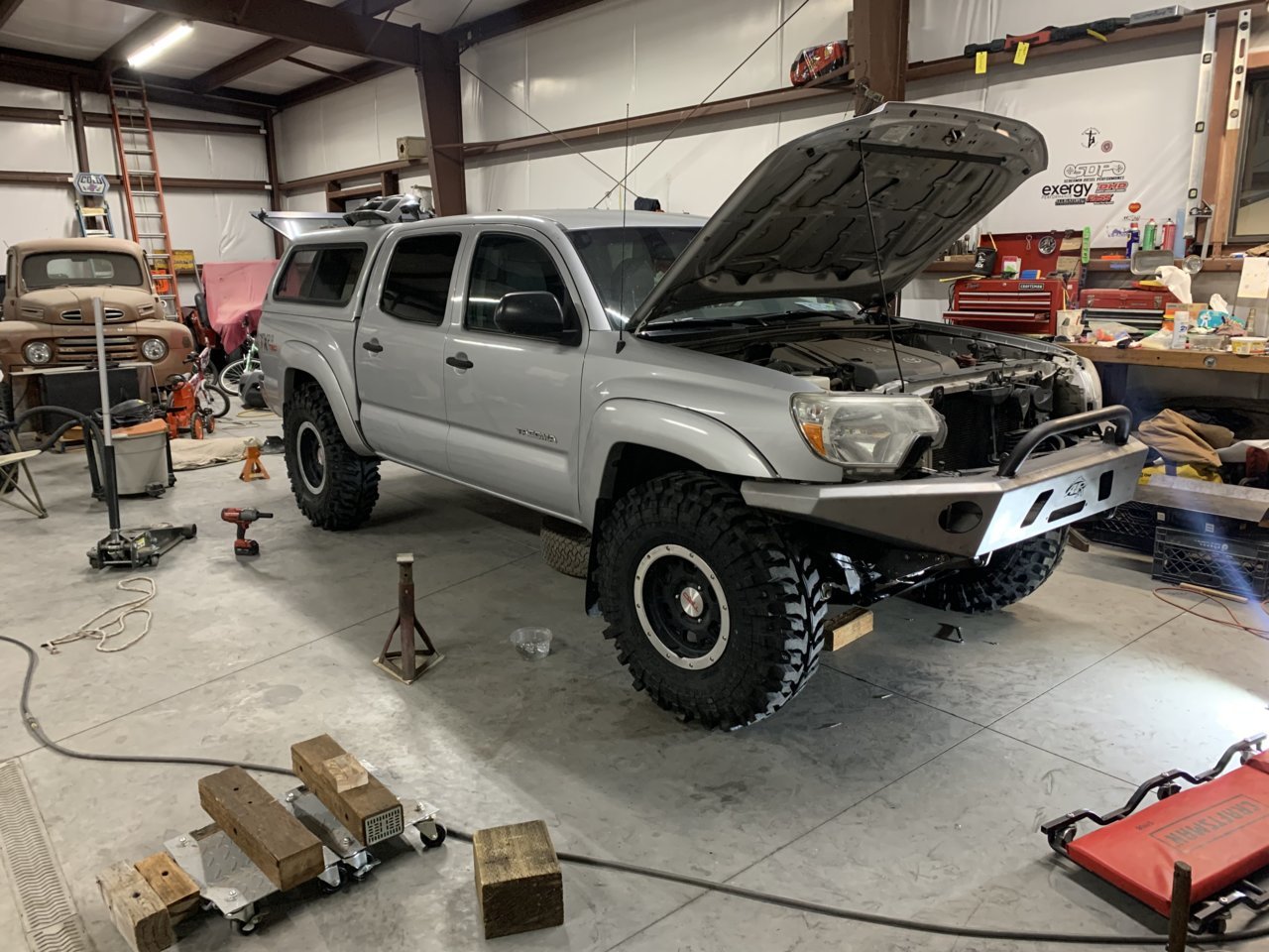

  8. May 18, 2021 at 9:15 PM
    #68
    Offthewall
    Jan 28, 2021
    #354363
    200
    Southern OR
    12 tx pro
    That’s why I’m here
    ABA2529D-E73B-4036-88B0-20ED9F5DEF4D.jpg Still have to trim all the fenders, finish my skid plate, and do a cmc. But had to see what it was going to look like with the tires on. Almost ready for the mall :bananadance:
    snowsk8air2 likes this.
  9. May 18, 2021 at 9:19 PM
    #69
    snowsk8air2
    snowsk8air2 how hard can it be?
    Sep 16, 2011
    #63607
    10,503
    Flagstaff, AZ
    Supercharged TX Pro
    2011 S/C and basic mods
    Them super swampers are meaty. Needs more ride height
  10. May 18, 2021 at 9:22 PM
    #70
    Offthewall
    Jan 28, 2021
    #354363
    200
    Southern OR
    12 tx pro
    That’s why I’m here
    Definitely need a little more height. Not decided how I’m going to do it. Hoping with a 2” fender trim everything will clear. We will see...
    And they are just swamper knockoffs. Swampers were 90 days out and about 450 more for the set so I figured I would give these a try

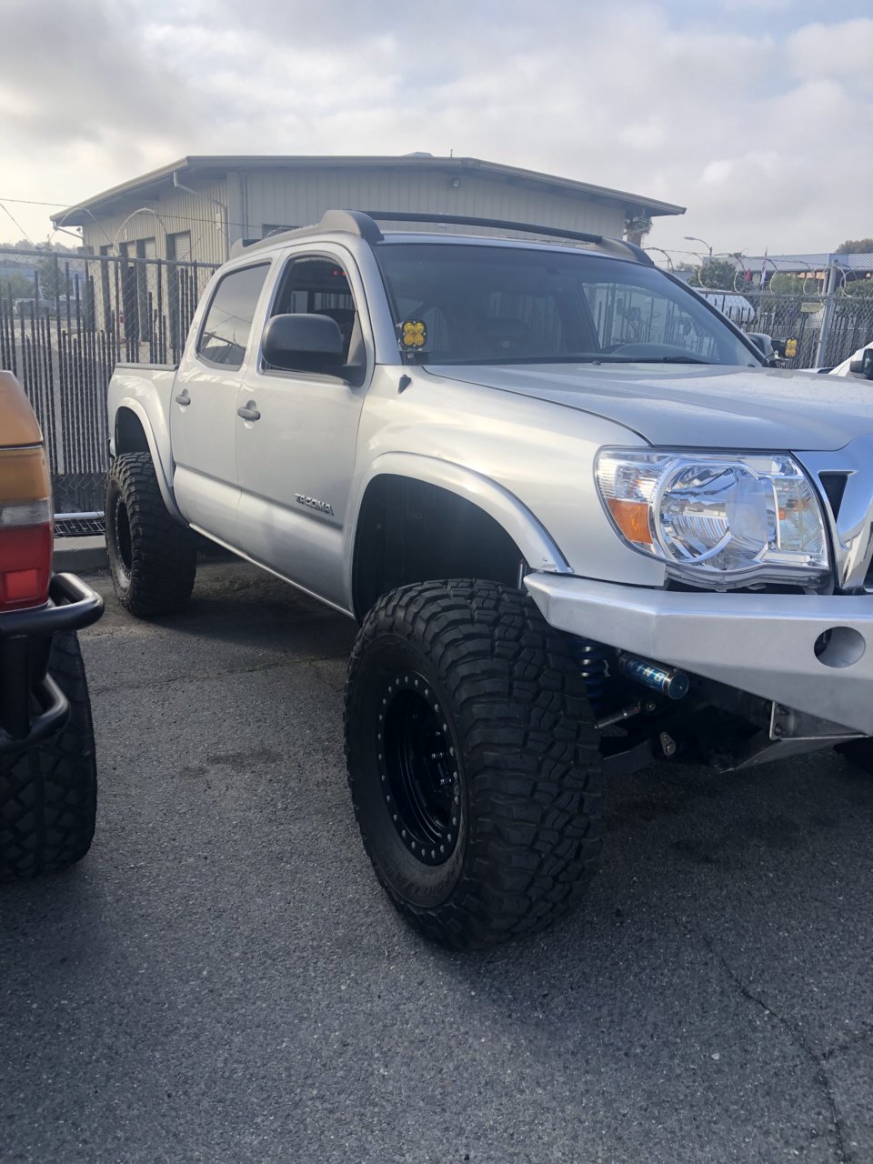

  13. May 20, 2021 at 7:21 AM
    #73
    81Trekker
    81Trekker Well-Known Member
    Aug 25, 2019
    #303299
    3,750
    La Jolla SD
    81 Trekker and 2015 CCSB Tacoma
    Too many to remember
    This is with 2” left on the OEM flares

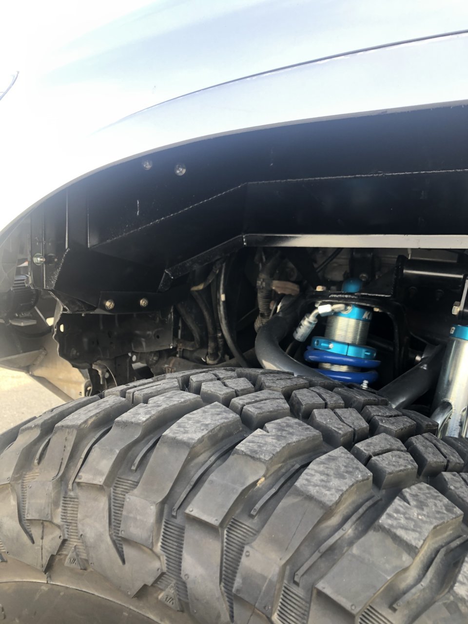

  15. May 20, 2021 at 7:35 AM
    #75
    81Trekker
    Aug 25, 2019
    #303299
    3,750
    La Jolla SD
    You need to do this

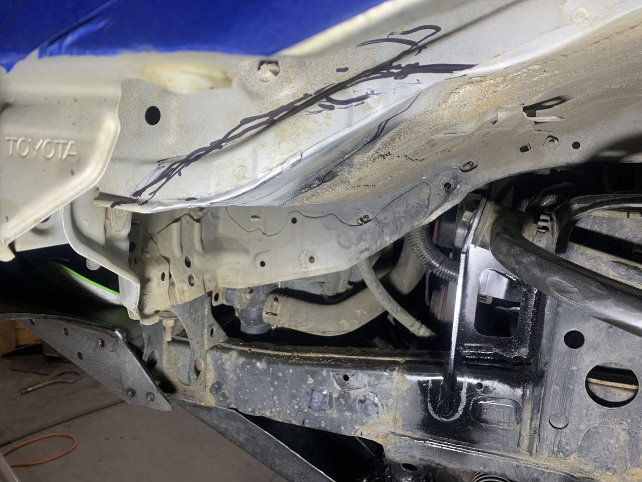

  16. May 20, 2021 at 7:37 AM
    #76
    81Trekker
    Aug 25, 2019
    #303299
    3,750
    La Jolla SD
    Or this :)
  17. May 20, 2021 at 7:43 AM
    #77
    Offthewall
    Jan 28, 2021
    #354363
    200
    Southern OR
    12 tx pro
    That’s why I’m here
    Ya waiting to get my 4Runner sold to see about the fender liners. For the others did you just cut out and weld in a piece of sheet metal? Did you go all the way to the battery tray?
    I thought about cutting along the seam and folding stock sheet metal over each other and welding it back together. also @81Trekker what did you do with the washer fluid reservoir?

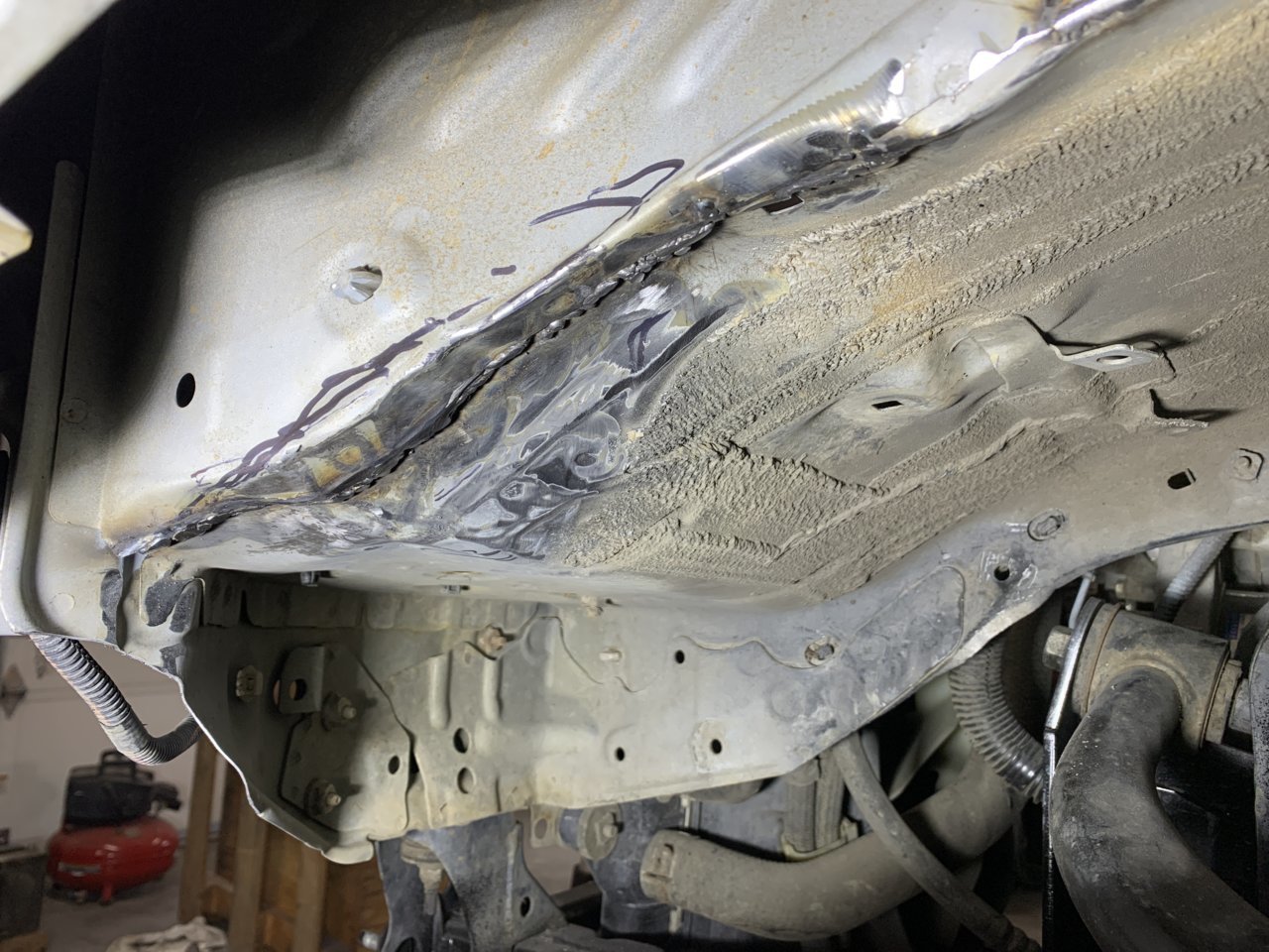

  18. May 21, 2021 at 9:57 AM
    #78
    Offthewall
    Jan 28, 2021
    #354363
    200
    Southern OR
    12 tx pro
    That’s why I’m here

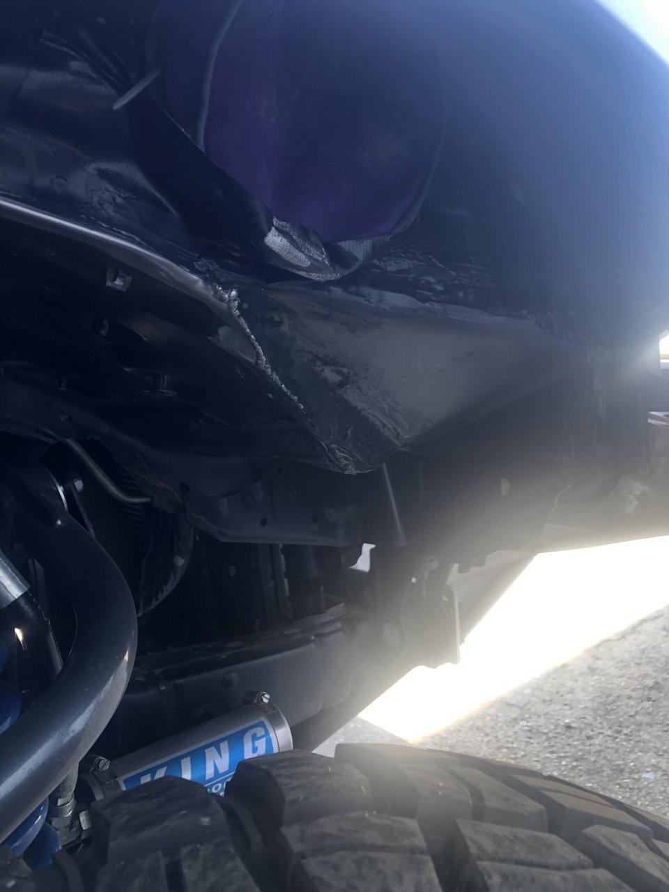

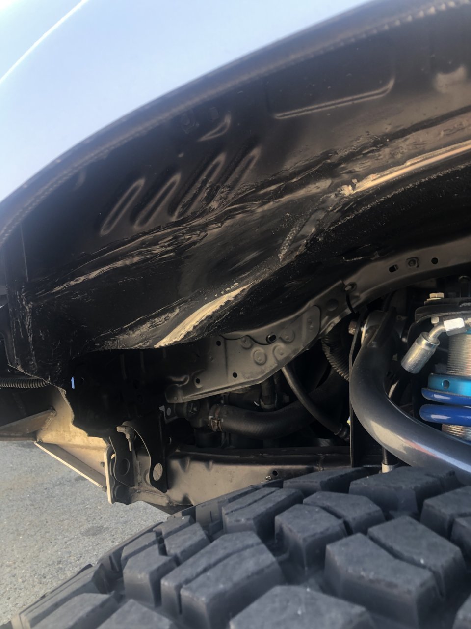

    Cut, reshaped and welded. Have to run to get some seam sealer. Starting the other side now just hope I can get the washer reservoir to fit back afterimage.jpg
