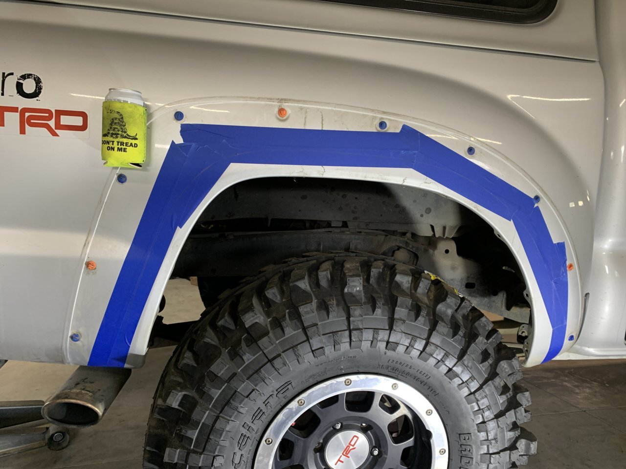

    It’s honestly not that bad. I drilled a hole and used a jigsaw. For mine. I used a dremel on the flares.

    The first cut is always the hardest. Then you get to my point where cutting stuff is towards the top of the options list

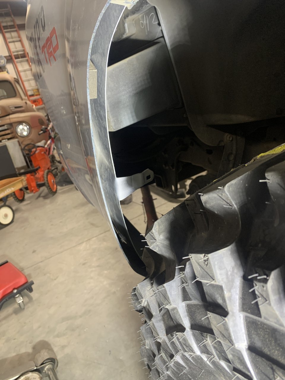

    I used a jig saw on the fender and the flare. Trying to get one corner done to see how I like my cut and how things fit back together. would love to do the same cut as @81Trekker but it wouldn’t like up with my front bumper at all. Just cut one taking 2” off. I like how it looks except the gap between the flare and fender, seems like it would catch a lot of crap. image.jpg

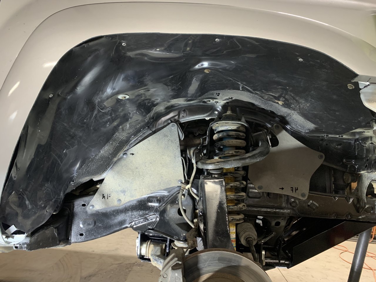

    Going to have to redo it because it didnt turn out just like I wanted but made a plastic fender liner to protect the air intake for now 30E174EE-B7D9-466E-A8B2-62E6A2B924DF.jpg
    Got all the fenders cut and everything clears so now to get it out of my shop and see how it does

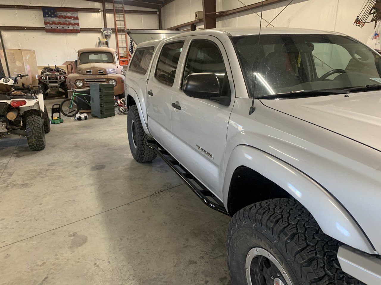

    Couldn’t wait to get it out so we took one of our normal drives. Just forest service roads up through the mountain next to the house. Easy trip but had to get a picture. Hoping to get the tires changed this week so we can take it out farther. 530D157C-DFA1-4E34-BF1B-13B209F1A7AC.jpg

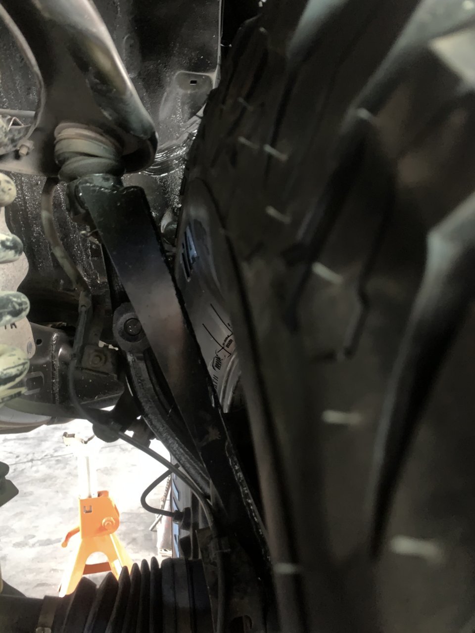

    My current wheels are 4.5BS and rub spindle and a arm with a 315. Is there that much difference 16”vs 17”. Hate to buy wheels and then the tires still won’t clear

    Thanks to @snowsk8air2 my front tires will clear the spindle. Now to make sure they clear everything else. 0E596A98-B683-4615-8DDD-34BE485BAA00.jpg

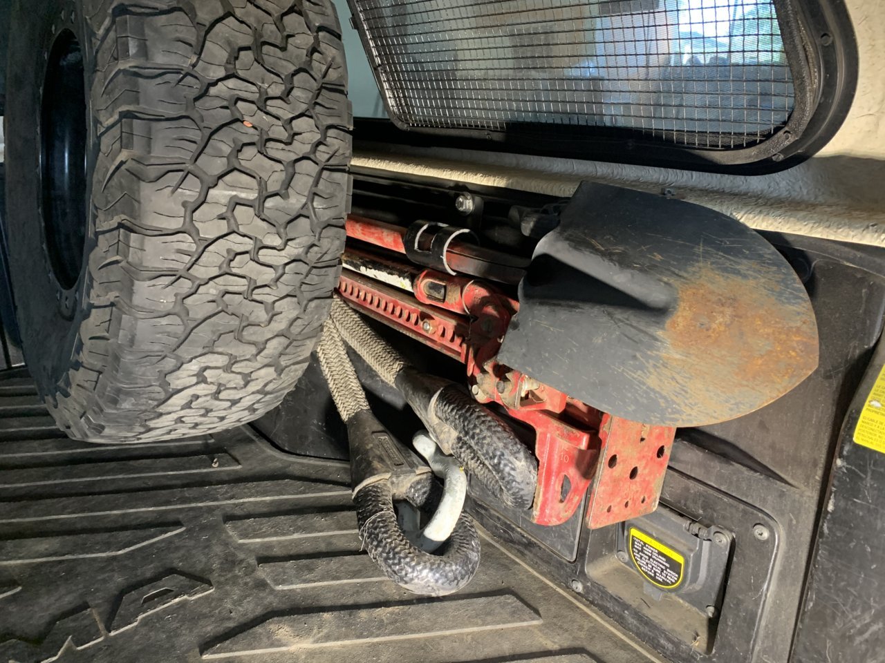

    Got my hi-lift/shovel mount installed. Just some sheet metal and pvc I had laying around

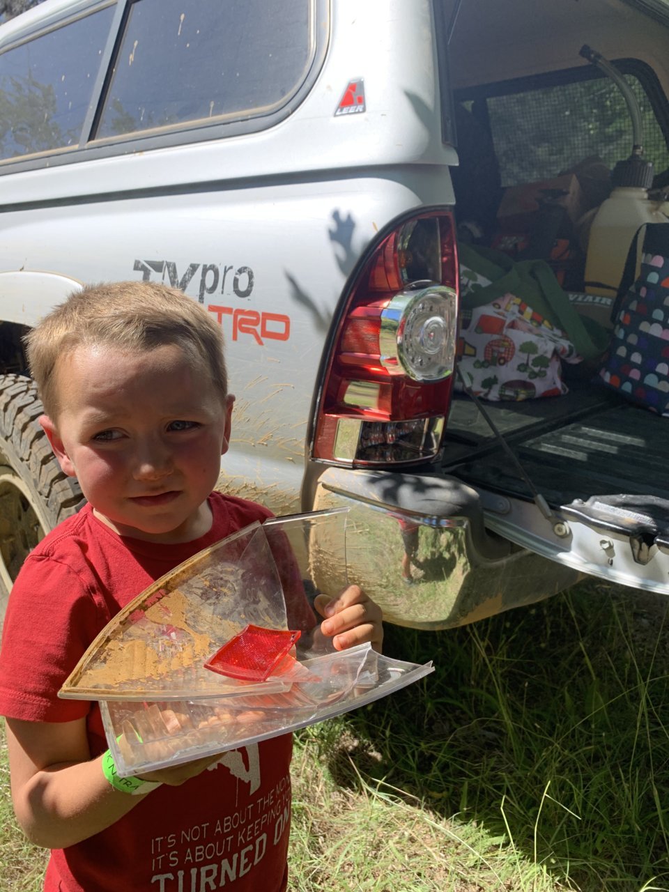

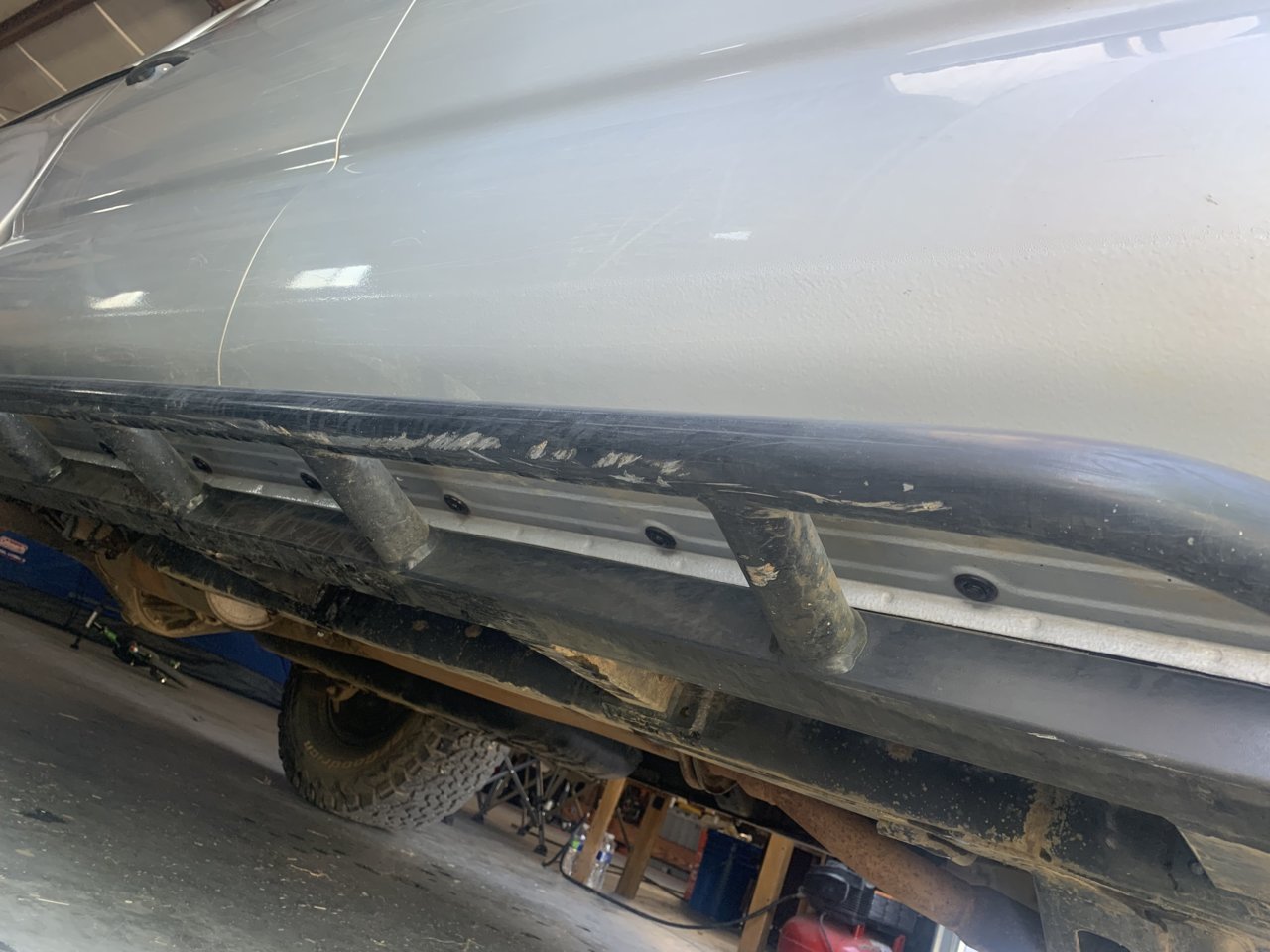

    202DC291-B948-443E-9ECE-6D5A7E86CF33.jpg 599D5458-C45C-4B8E-8832-B64C22DF8BD7.jpg Put the rock sliders to use this weekend on the McGrew trail. And I need to upgrade my rear bumper. Stock one came up and popped the outer cover off my taillight.
    what HC read bumpers does anyone suggest?
  20. Jun 21, 2021 at 8:57 AM
    #100

    10,503
    Flagstaff, AZ
    Supercharged TX Pro
    2011 S/C and basic mods
    If you can weld then look at the coastal offroad diy kits. Their rears are a decent design, just heavy. Otherwise build something out of tube if you can. I’m building a new tube one for a buddy here in a few weeks
