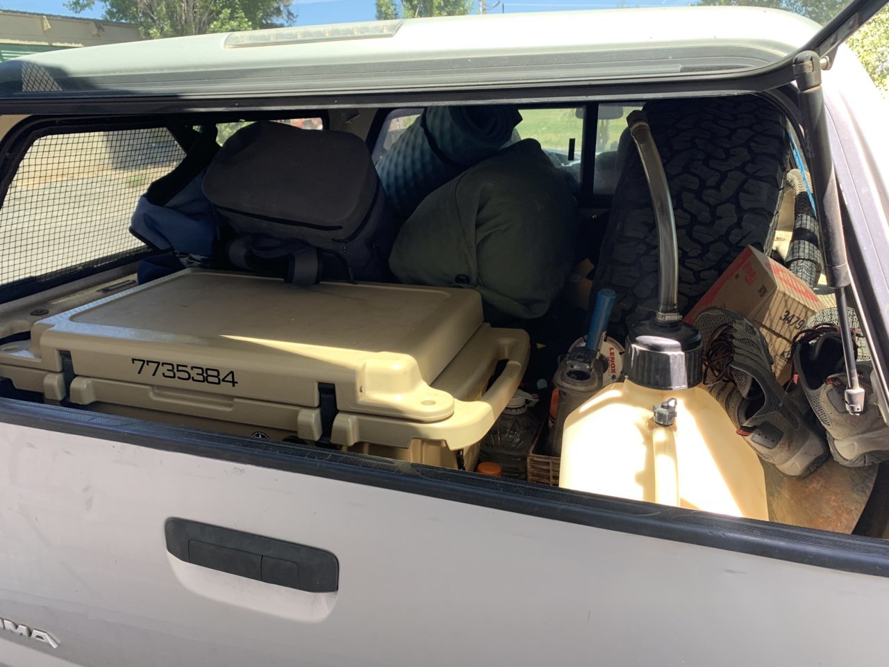

    I drive too fast for them and in too steep of terrain when crawling personally. For your overlanders, mid travel guys and guys doing medium difficulty crawling they are fine. But anything more extreme then there is just too much weight with too much leverage when bouncing around the desert, or you have to mount things so high up for departure angles in the rocks that it’s ridiculous. It’s hard because a short bed doesn’t have a ton of storage space, especially when you have big tires, but if you get creative with storage then you can still fit a ton of stuff.
    Here’s my truck on the rubicon a few years ago. 315/75/16 spare tire, 2 coolers, all cooking and camping gear, chairs, beer, fire wood, water and spare tools and parts. It’s tight and a pain to pack and unpack each day, but it worked. Bedding and clothes stuffed in the back seat.

    Ya we made it work but the back seat stays full with 2 boys. And there is no way to bring the dog like this. I wonder if anyone makes a removable swing out that you could lift off when you plan on going harder wheeling and put back on when your going just backwoods camping. Either that or it’s time for a roof rack.
    @snowsk8air2 how do you have that spare mounted in your bed?

    I’ve added a bunch of tie down points in the bed for all my gear. So the spare is up against my bed rack and then strapped up and over. All coolers and totes and what not are tied down to the bed as well. I should be able to at least flop on my side and not lose too much gear. But don’t want to test that theory lol.
    I mean they make hitch mounted tire carriers that you could probably modify to hold some extra gear for family camping and then pull off when harder wheeling.

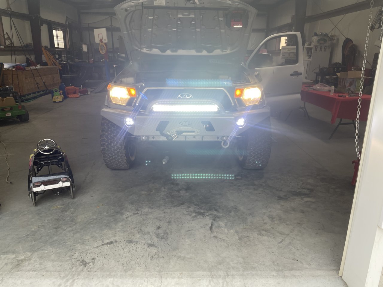

    Got the fogs I won in a raffle and the light bar I found in a ditch installed. Can’t wait to get out to see how they work. 3E97B319-4E7D-43DB-B936-4AE7EE652E10.jpg

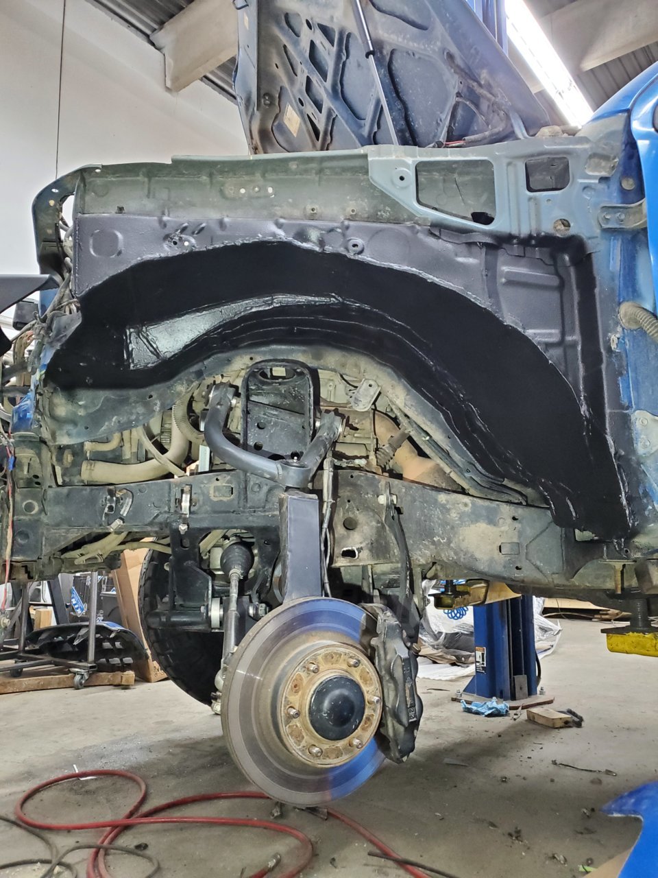

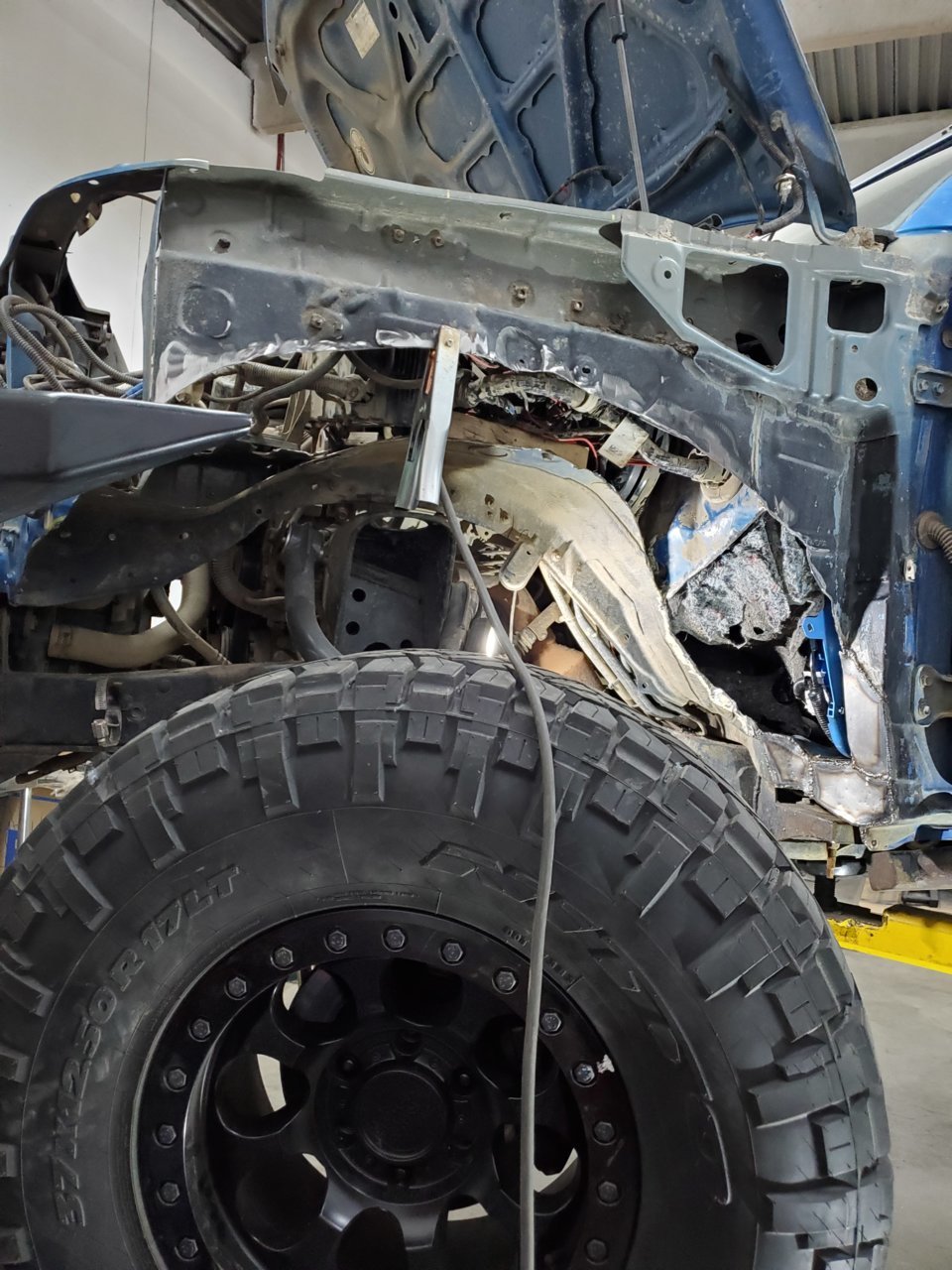

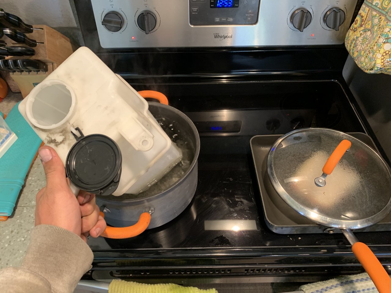

    How did this turn out? Did you melt and reshape the reservoir?
  11. Dec 23, 2021 at 5:16 PM
    #111
    Offthewall
    Offthewall [OP] Well-Known Member
    Jan 28, 2021
    #354363
    200
    Southern OR
    12 tx pro
    That’s why I’m here
    Ugly but it fits and it hasn’t leaked yet. Ya I just heated it up and flexed it in until it fit with the modified inner fender

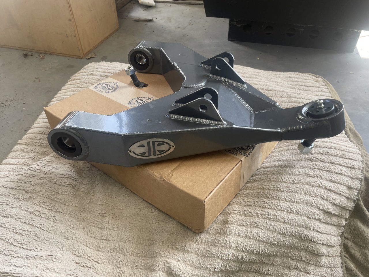

    7A9187AA-12EA-429C-BA93-09F283AAED98.jpg Parts are starting to come in. Hopefully the shocks come in soon.

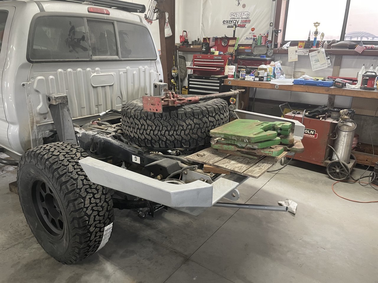

    797AAF59-94BA-480B-B148-A9E0386AFBDF.jpgComing along slowly. Setting pinion angle, glad I had some tractor weights

    What did you paint/seal that with?
  19. Jul 30, 2023 at 2:43 PM
    #119
    WormSquirts
    WormSquirts Armageddon
    Dec 18, 2015
    #172583
    2,848
    Braeden
    BC
    I used a light behind to make sure there were no holes in my welded seams, then used pro-form European texture gravel gaurd. It worked really well and lasted nicely, no complaints
  20. Jul 30, 2023 at 3:37 PM
    #120
    Offthewall
    Jan 28, 2021
    #354363
    200
    Southern OR
    12 tx pro
    That’s why I’m here
    Auto body seam sealer, then spray paint
