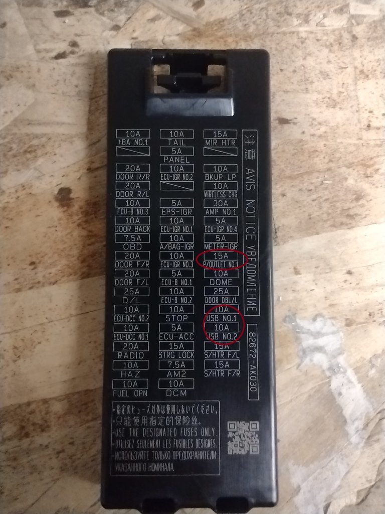

    The fuses for those outlets are under the dash on the passenger side.

    Wow, have to remove that plastic plate by air outlet and LED and then a third fuse panel?

    Yep. It's not too hard to pop off (it's under the glovebox) a little tricky to get the tabs lined up when putting it back on.
    Edit: I suppose it could be different for an SR5 so you might want to check the manual first.
    PS: there's one under the rear seat too (for non-hybrids at least).

    Thanks! I took it in today because we checked the engine compartment ones while on vacation. We took it to one dealership who didn't know where the fuses were while travelling, but said they were all in the engine compartment, so we looked at all those and they were fine. It must've been this one.
    The dealership while travelling said they didn't know where it was located. We called a second one that was an hour away and they said they couldn't help, so waited until we got back home. It's fixed now. We tried to talk to the mechanic that did the work, but they were already gone for the day and the service desk couldn't tell us which one or where, so it had to be the ones under the glove box.Now we know!
