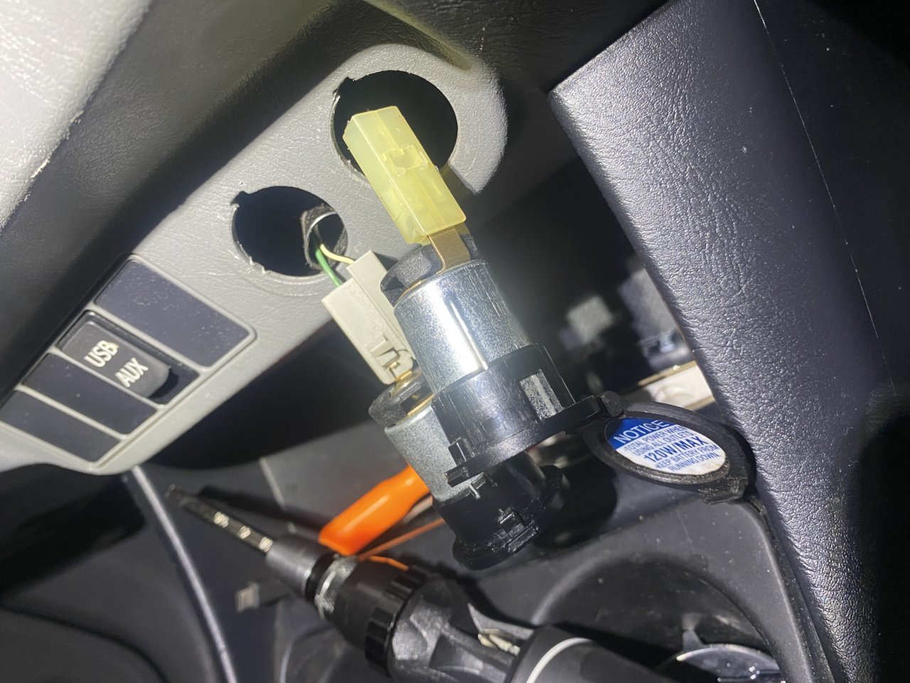

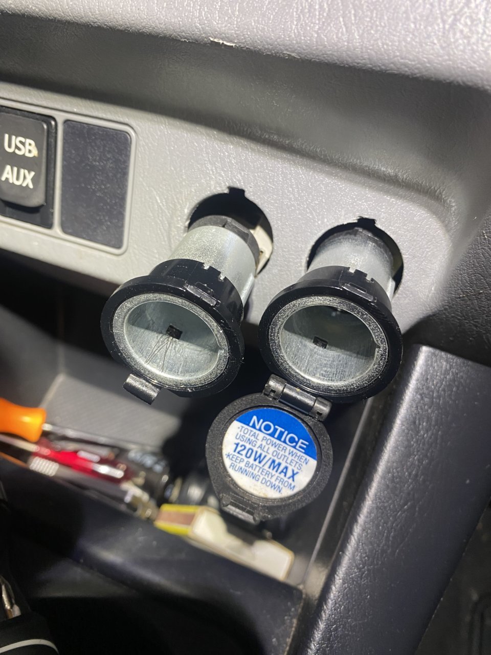

    Will replacing the plastic cover hold the socket in place?? Not sure what mechanism is what’s holding the sockets against the panel ?

    The black sleeve is what holds it in to the dash
    I’d have a look ad see if the tabs are broken or rounded off that hold it in.
