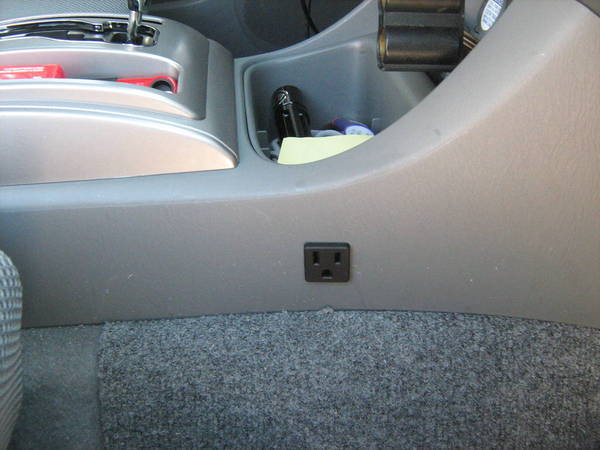

    just installed this today[​IMG]

    Very nice and clean. How did you wire it up? I've been looking to do something similar.

    i took like 20 mins from start to finish and i also did the 400 watt anytime mod while i was in there...
    just removed the center console like 4 screws and then follwed the directions from the mod section on here and cut and taped the wires they tell you too....then i got a snap in outlet and used the dremil to cut the hole.....
    i also added 12 volt outlets 1 with lead acid battery box installed in the bed and 1- 12 volt outlet from the truck battery
    here is the link i used
    http://www.tacomaworld.com/forum/technical-chat/4838-cheap-free-mods-5.html

    looks great! Where do you get the snap in outlets?

    thanks............ i got the outlet from the electric supply place...its a levitton snap in outlet for $1.79........
