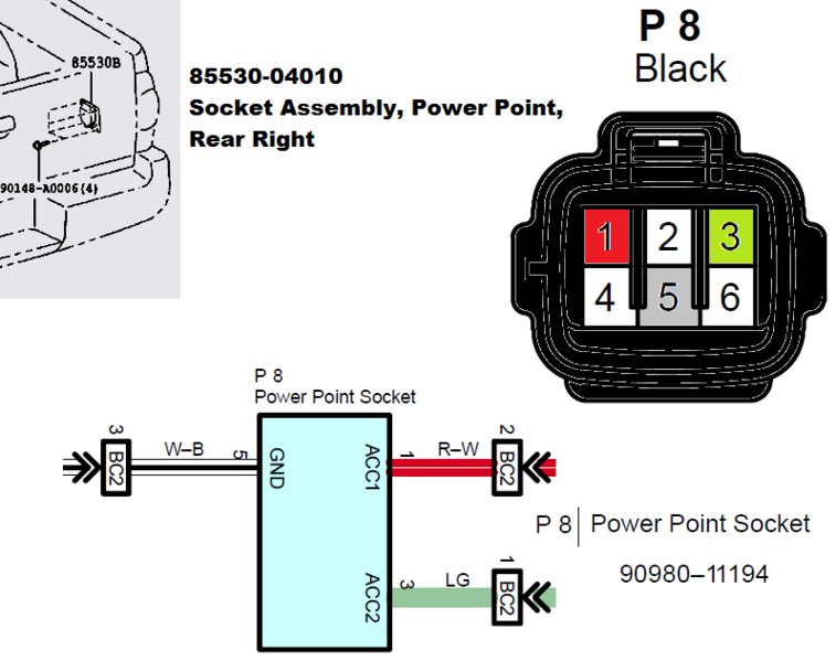

    I am looking for the part number for the plug for the 120v bed socket.
    Said plug pictured below -
    Thanks

  7. Aug 12, 2016 at 7:18 PM
    steveo27
    steveo27 [OP] Ask me about my weiner
    Aug 12, 2013
    #110326
    6,067
    Steve
    Pittsburgh
    '11 TRD Off Road & 1992 VW GLI
    The same shit everyone else has.
    buelller?

  9. Aug 12, 2016 at 8:04 PM
    steveo27
    Aug 12, 2013
    #110326
    6,067
    Steve
    Pittsburgh
    THANKS!

    What happened to it? Rewiring harness?

    I added a 2nd power point socket to the center console from a 4 Runner. I believe the Tacoma plug is the same as the T4R plug
