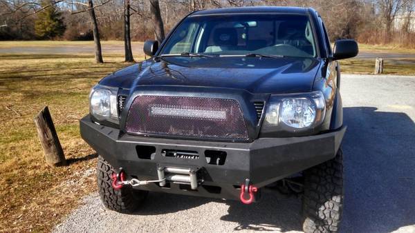

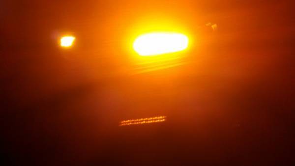

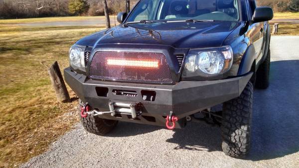

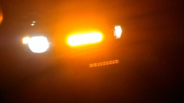

    Sorry for the delay, I work 12 hour swings...
    Daytime
    Nightime, (And they are bright!)
    It is mounted to a BAMF lightbar.
