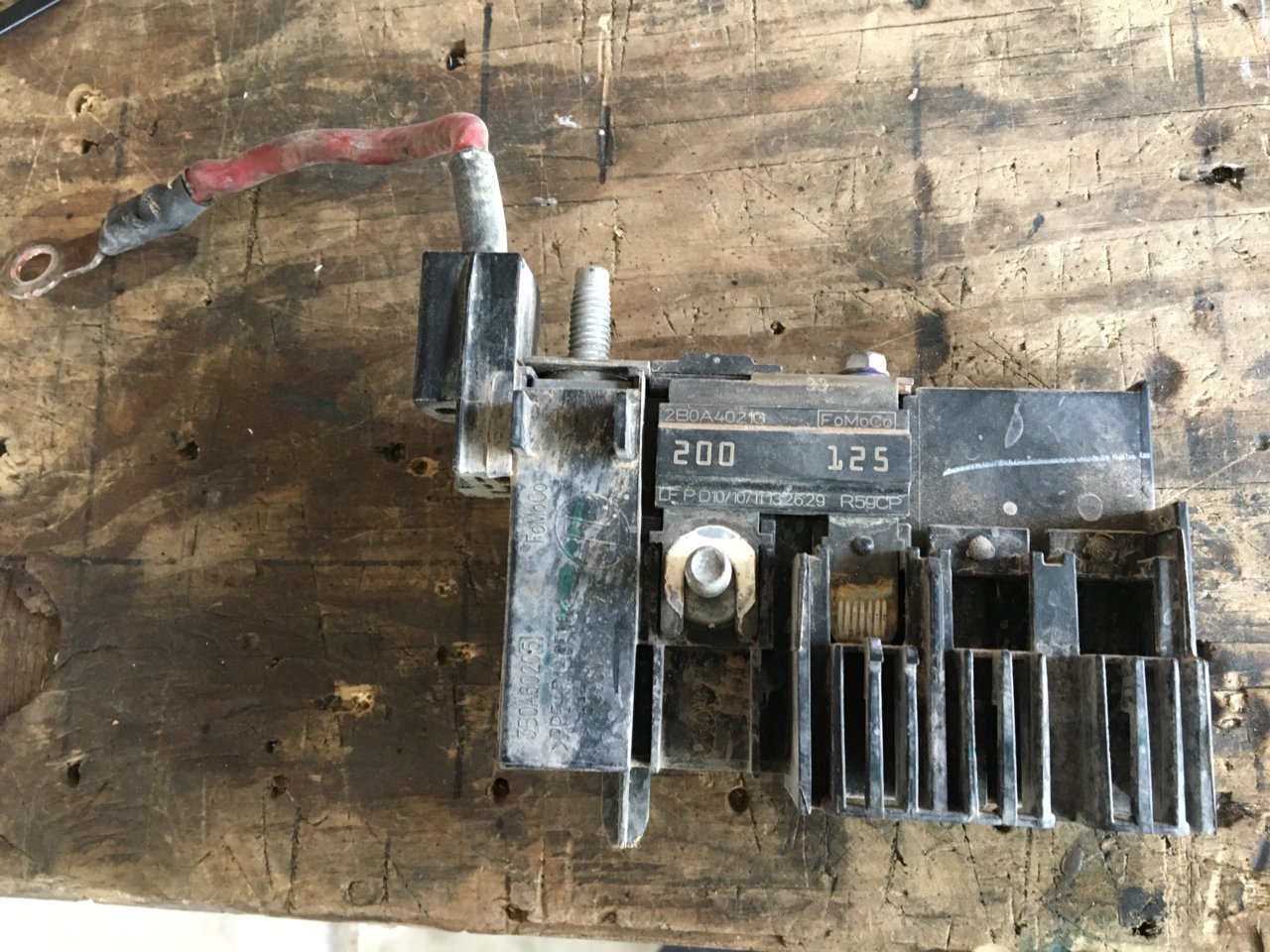

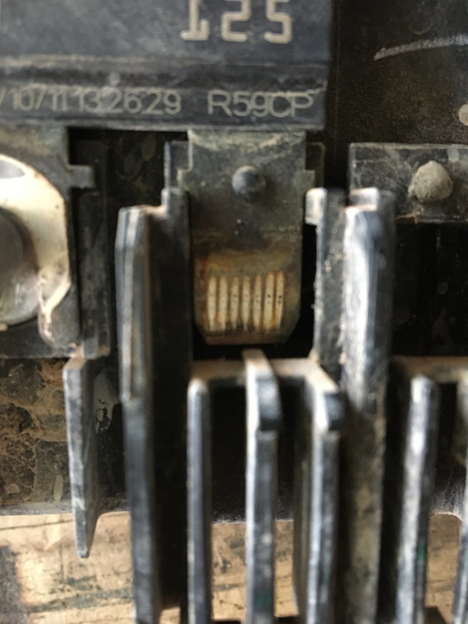

    Funny that I stop by here and see another thread about crazy car electrical shit. I just went thru this with my truck (not a taco). Had the issue for a week.
    Here's what started it.
    So cut that out and replaced it. Acid creep is hard to detect. I have found it only in the middle of a cable, not at either end. Just in the middle.
    Here's a look at a fuse they use to protect the system.
    IMG-1910.jpg 67356442491--141F2538-8775-4C58-AAB1-25652F5A998A.jpg IMG-1909.jpg
    My power probe was going crazy when you moved any of the wires going into, and out of this fuse/breaker.
    Took all this to work on it.
    Cleaned all the contacts, fixed the resistance in the cables and ended up with this.
    Turned the key and nothing.
    REPLACED THE BATTERY, AND BOOM! CAR STARTED, RADIO PLAYED, LIGHTS WORKED AND EVERYTHING WAS GOOD IN THE WORLD.
    Moral of the story. Four years is about all you can expect for a "secure, trustworthy" battery. Anything after that is gambling with your ability to drive.
    This truck only has 60,000 miles.
