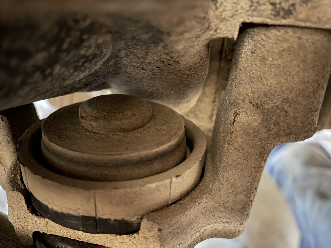

    I’m trying to remove the front diff to swap in the new gears. The 12mm Allen bolt is spinning but the entire bushing is also spinning.
    it won’t free. Any tips? The 2nd pic show the top and that large diameter bushing / sleeve spins with the bolt. I assume it should break free and the bolt will come out but that’s not happening.

    You may be forced to remove the mount off the diff instead of just the single bolt. It will be tough up there not much room to work.

    Interesting. I have an 05 so maybe they added that bolt. I just have a flat top with nothing to grab. Definitely no but on top.
    I’m going to try to grab/vice the larger diameter piece and see. Otherwise the 2 bolts are coming out.

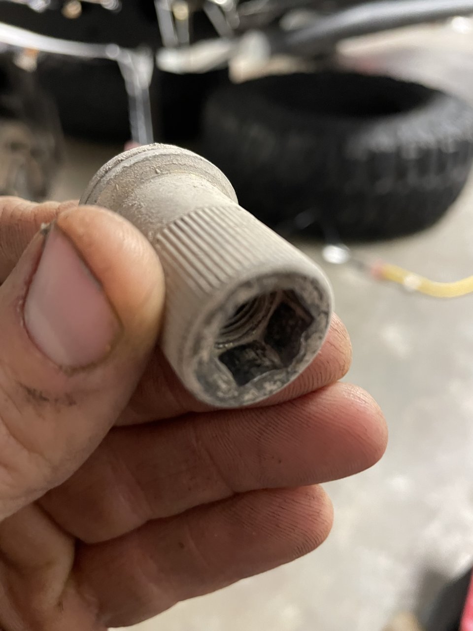

    I got it. Was able to clamp the wide part with a vice. Crazy bolt.

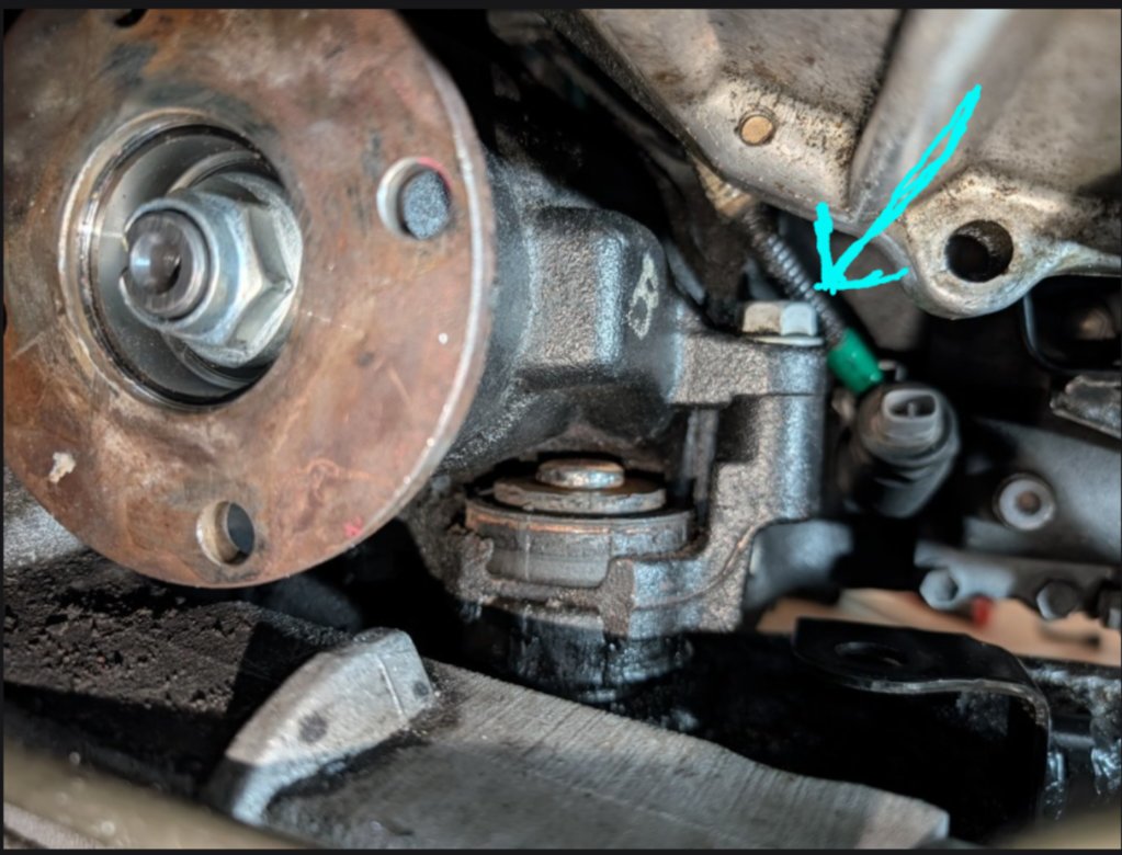

    Maybe try removing these bolts.
    A flex head ratcheting wrench will come in handy here.

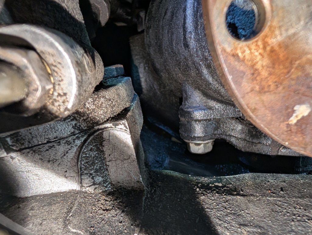

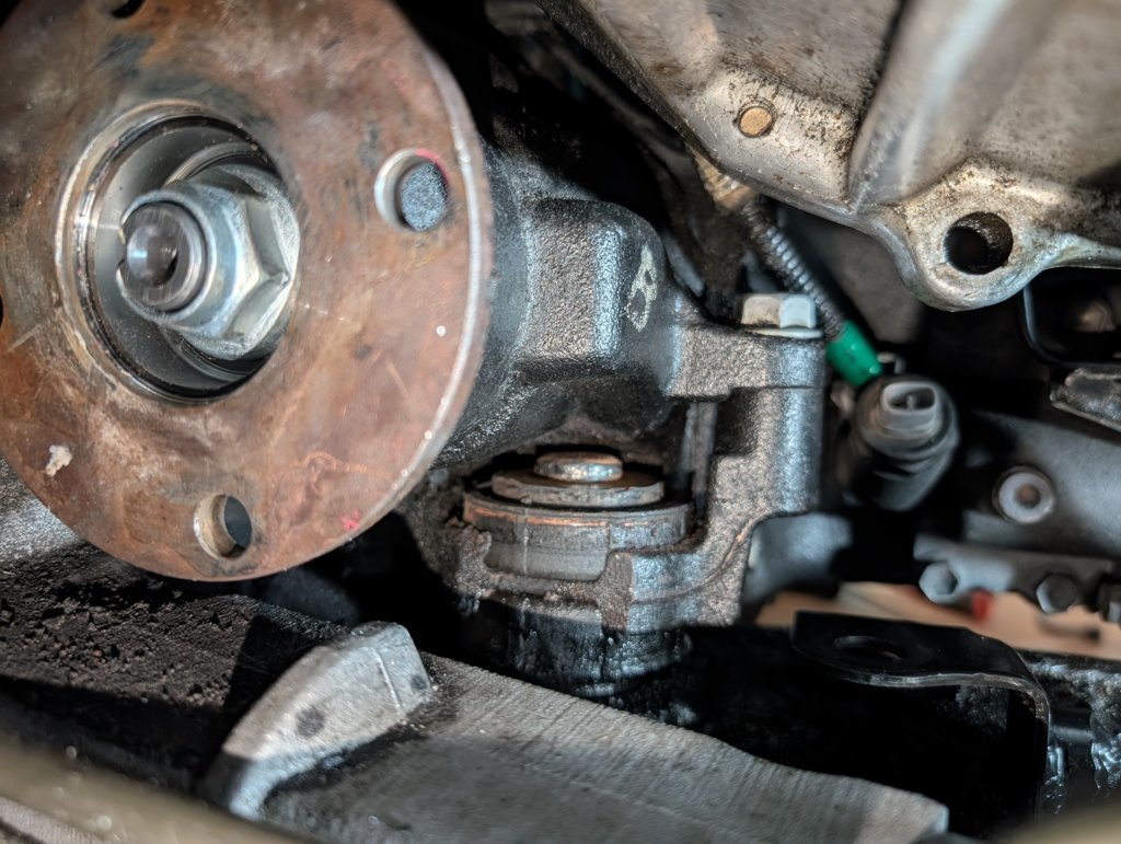

    Thanks. That one you arrowed is probably removable. The other one though faces down and right into the crossmember. I'm working on an oil pump reseal, this is the last step to get to the oil pan, unreal.PXL_20250627_224128280.jpg

    That hex head "bolt". Looks to be a "Nut" in actuality.
    Look up into the bolt (nut) and see if you see the bolt in there.
    Maybe spray some WD or lube in there and hope it creeps up the threads and helps loosen it up a bit.
    See post #7 above. Take a look at the "Nut" to see what I'm talking about.

    You might also try loosening those bolts on the mount.
    They might not come out, but it might drop down just enough to help get a better grip with vise-grips.

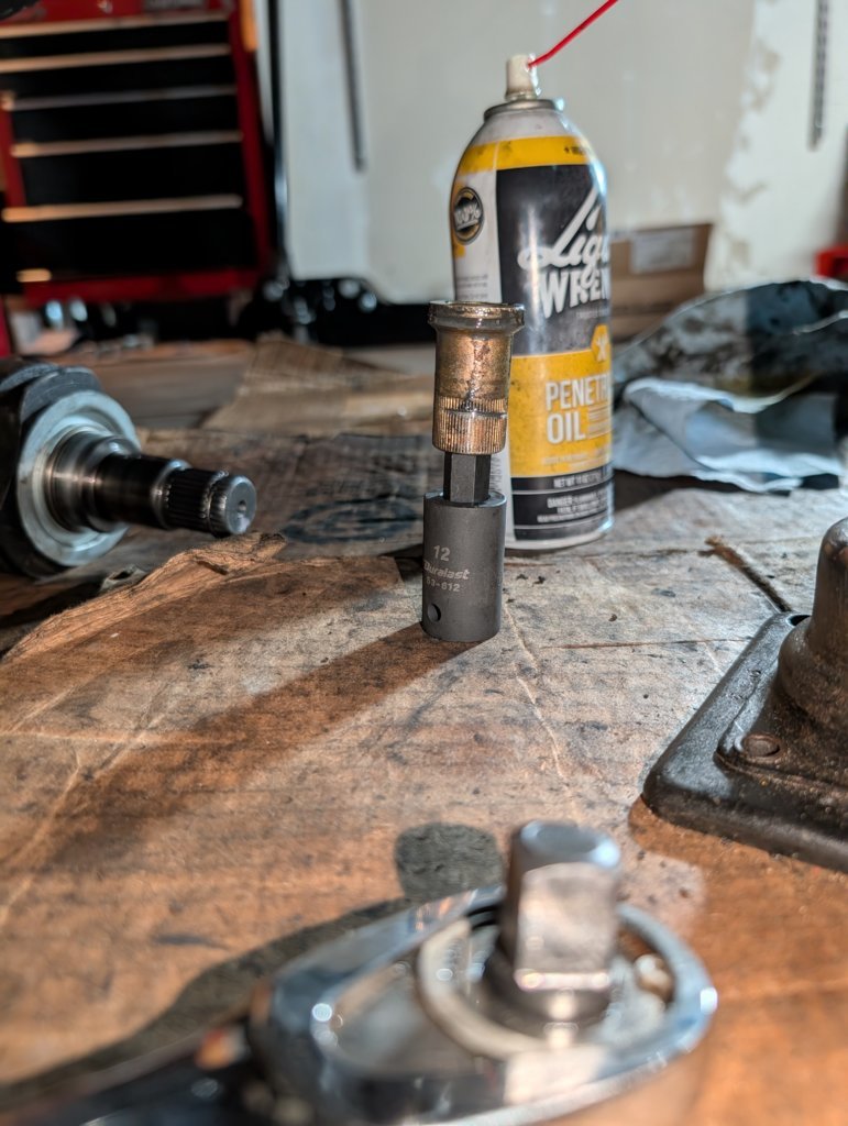

    Thanks man. Yeah, the FSM calls it the rear mounting nut. I've sprayed it all down with Liquid Wrench (can't handle PB Blaster smell).
    I had been putting this job off, knowing it would be a bit challenging. Was expecting the worse part to be lowering out the differential and then putting it back in solo. I wasn't expecting this. Been working it a while. I don't like getting defeated but if I can't get it may have to put stuff back just to get it towed to a shop. Think it's a good idea to get a tow without CV axles back in? I may also go to HF and pick up their beefiest impact the "Earthquake XT" and see if it's more capable than this Aircat I have.

    I was the last one that had the problem a few posts above. I wish I wrote more about how I got it off. I assume it was getting a vise on that outer part but simply don’t remember.
    I’m not tracking how an impact wouldn’t turn it but a socket will spin the whole thing - strange - but it’s been a few years and that’s definitely a unique bolt

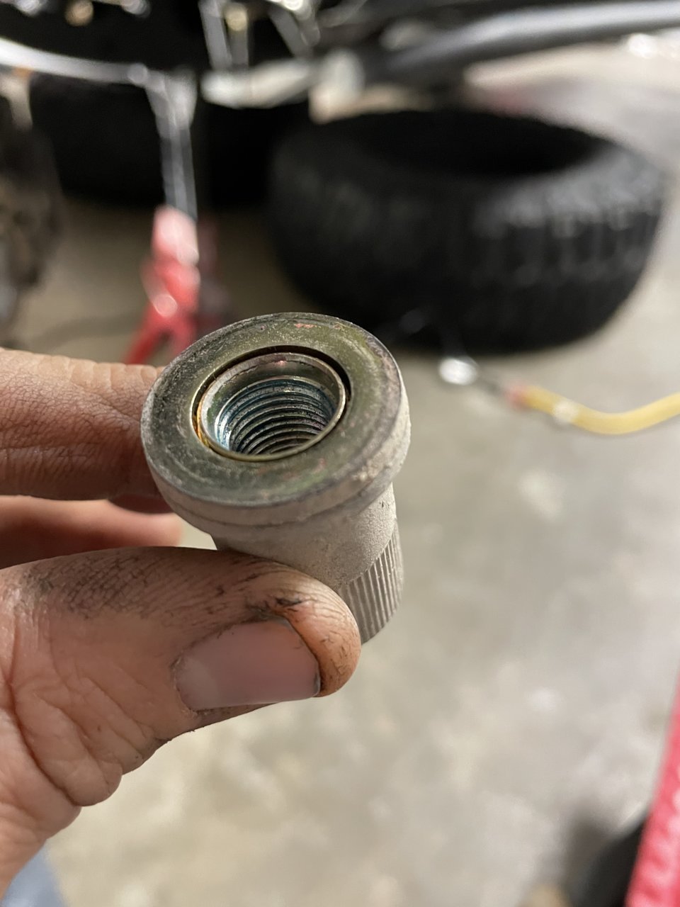

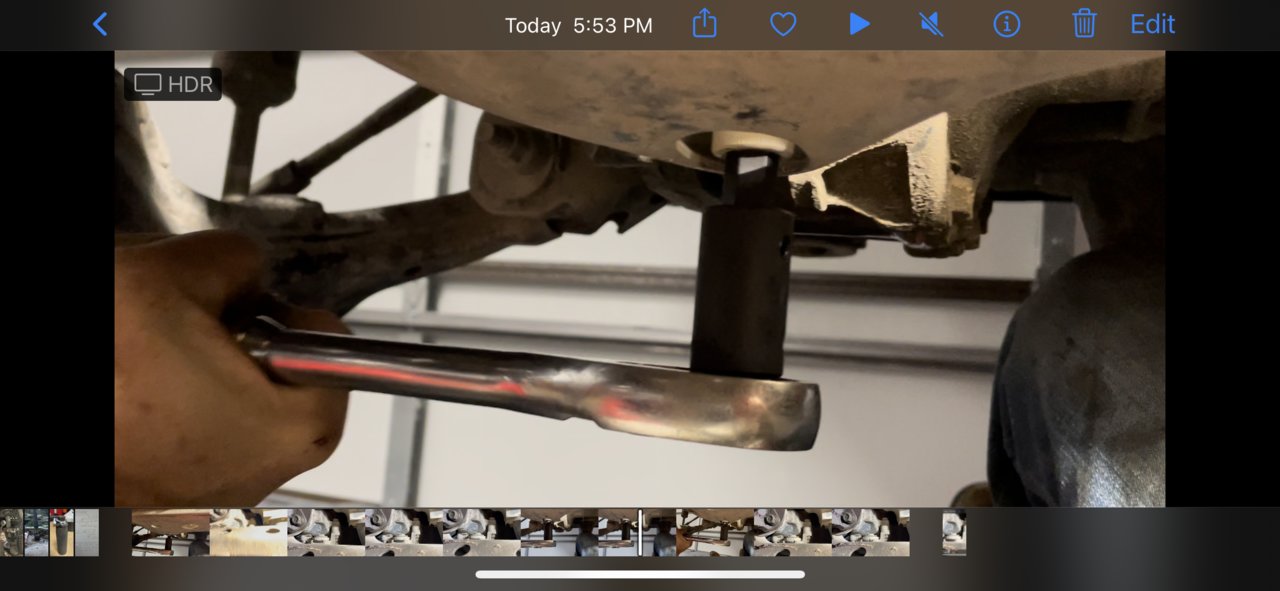

    We're in business fellas. After some Liquid Wrench soaking, repeated tapping of impact socket with hammer, and jamming a big flat blade in between part of the bushing and differential and prying with all I could one-handed, it yielded. Now onto the fun part. I figured out also this is technically the wrong forum, I'm working on a first gen, but it seems this applies to both. Wondering what Toyota's reasoning is for using a stud with a round head there instead of a typical bolt head. Would be a lot cooler to get a wrench on it
