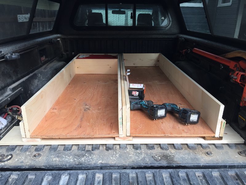

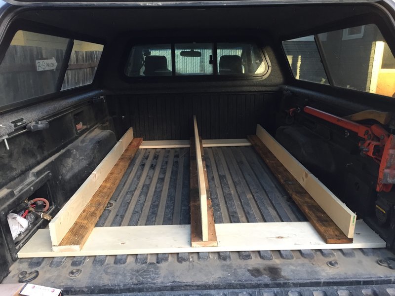

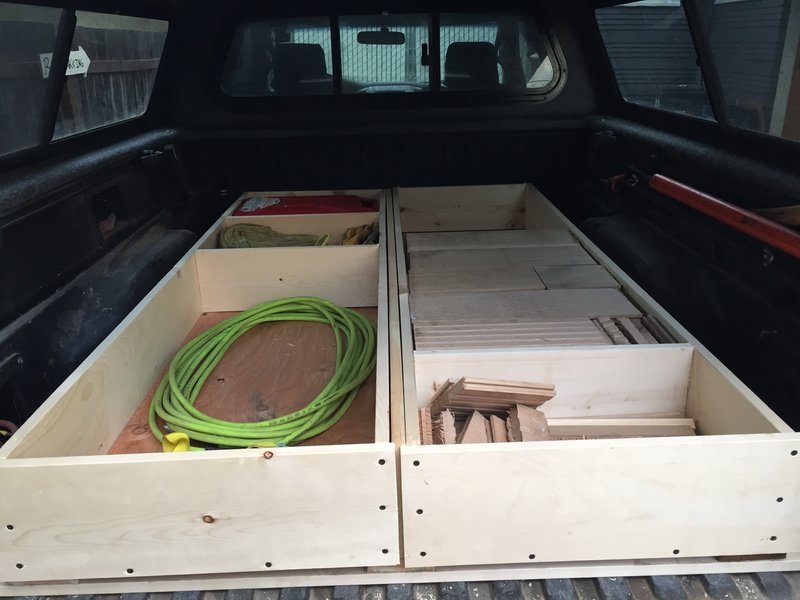

    In preparation for my Moab trip next week I figured I better find a way to utilize the space under my sleeping platform. I settled on a super simple design using 1x8's and some scrap 1x4's from the pallet that my front bumper came on. All said and done I spent about $100 dollars on it. I probably could have got it done for cheaper but I just wanted to pound thing thing out.
    The rough framing:
    Got the drawers built
    Put some dividers in there to keep things organized. That jerry can fits perfect!
    And the final product. It isn't perfect, but it gets the job done.

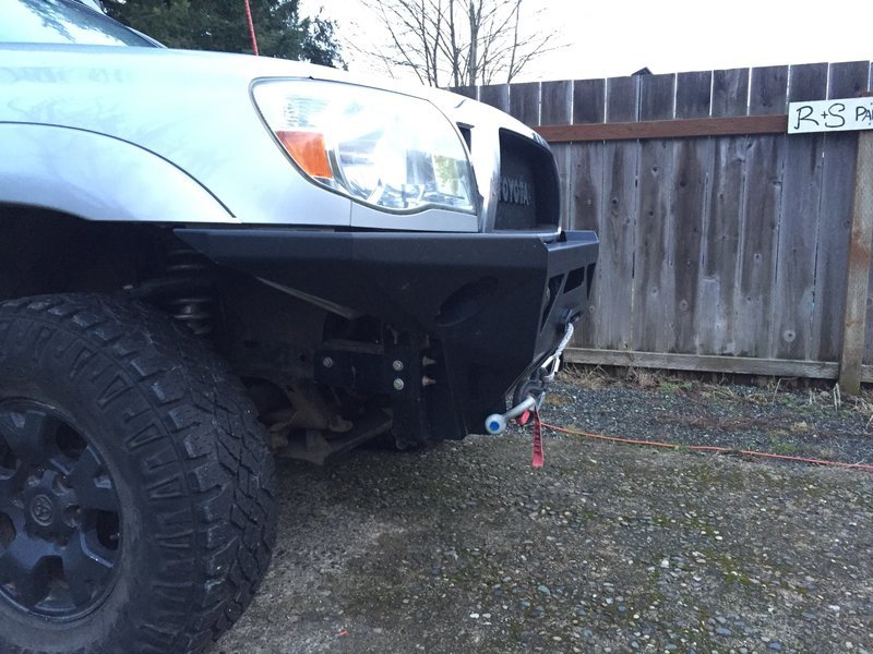

    Do you have more pictures of your front bumper? I am looking to get the cbi bumper with no hoops too but can hardly find pictures of it!
  7. Feb 20, 2017 at 7:46 AM
    #27
    12thmanhawkfan
    12thmanhawkfan [OP] Well-Known Member
    Mar 13, 2013
    #99628
    1,077
    Robby
    Bellingham, WA
    Access Cab 6-speed
    It's got some Mods
    Here ya go:

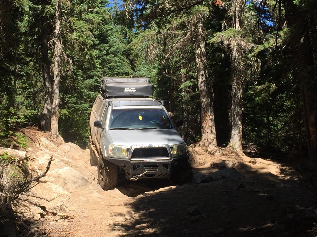

    Some pics from a recent run up the Whipsaw Trail. What a fun trail!

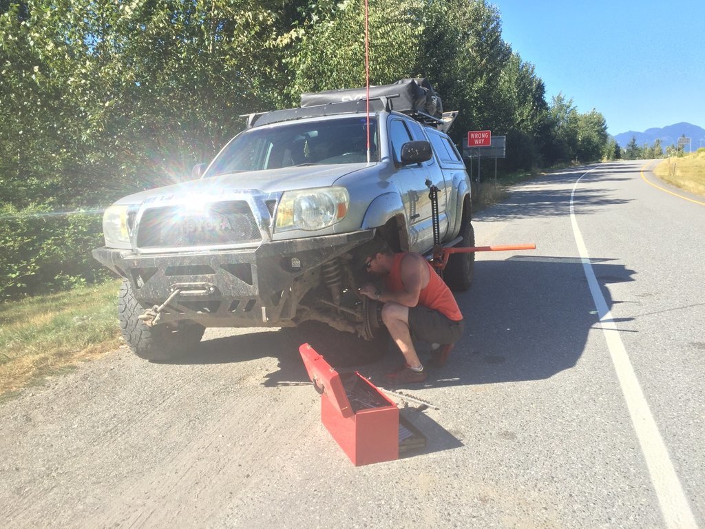

    ...And of course I had a wheel bearing crap out on me on the way home. I wasn't too worried though because I carry a spare hub/bearing assembly with me. I was really thinking I was going to score points with my wife until I found that the hub had seized itself onto the spindle or whatever is behind it. I ended up having to call my dad and have him drive up into Canada with his trailer to come and rescue me. What a guy!

    What was happening that you needed to address the hub on the side of the road? I've got one on it's way out again. I've got about 18k miles on one of bamas units.

    I had even less miles than that on this bearing. Probably about 10-12K. It was my original hub with an OEM bearing pressed in by a local shop. There was nothing wrong with my hub but I had to take it off in order to get the new hub/bearing assembly installed. I never did find out what caused it to get stuck, I'll hopefully see the mechanic's report this week.

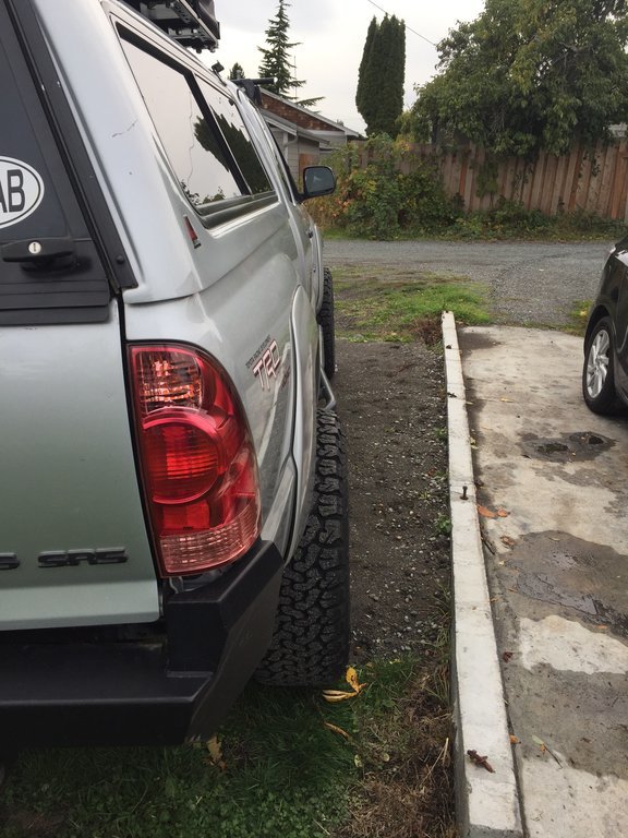

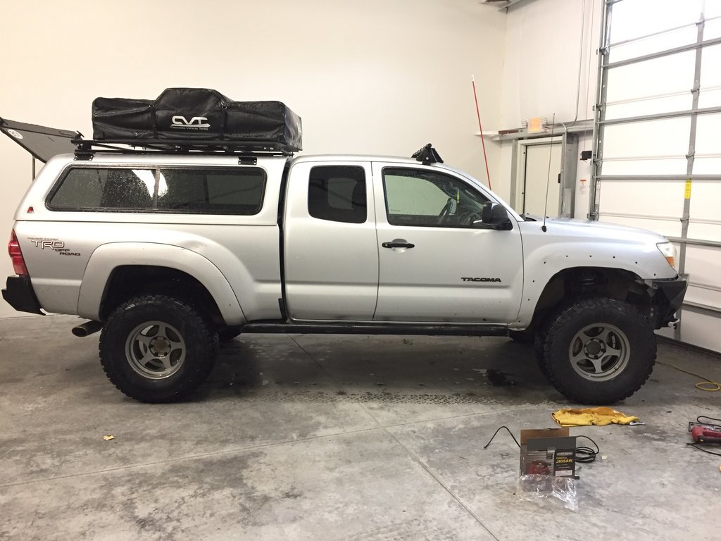

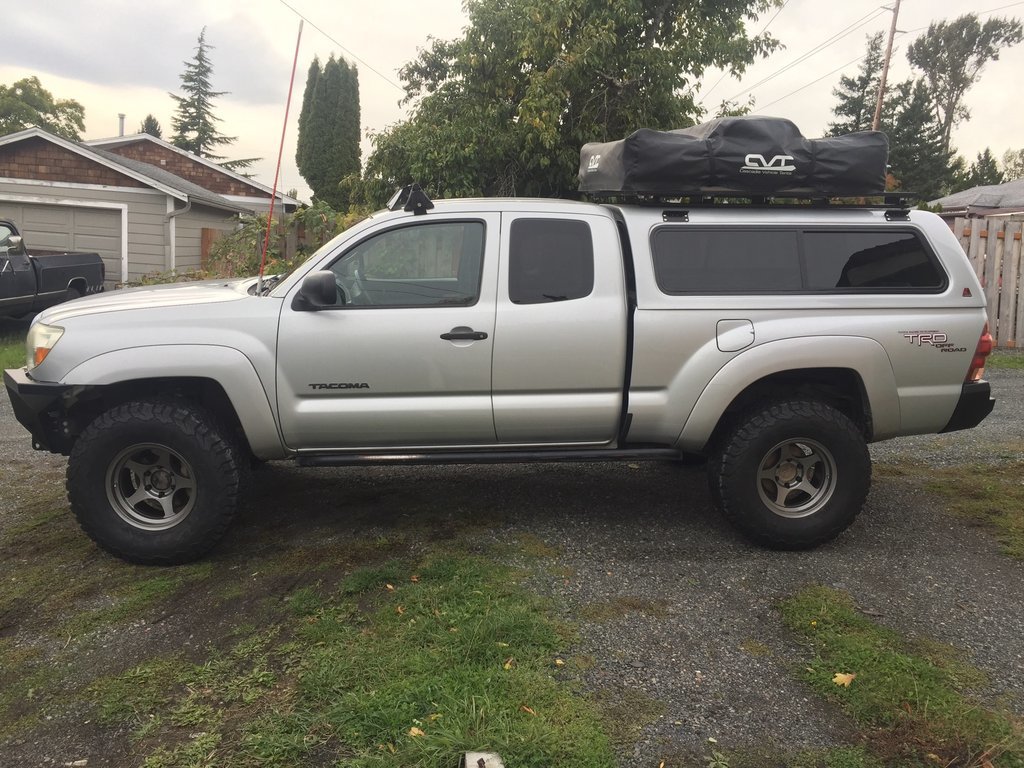

    Today I got some new wheels and tires mounted. FN 5 stars with bfg KO2's in 305/70/16. I did the cab mount chop and beat the pinch weld back this last weekend to help with the rubbing. I still rubbed the fenders like crazy pulling out of the tire shop so I'm thinking I'll have to cut an inch or two out of them.
    Love that wide stance though!

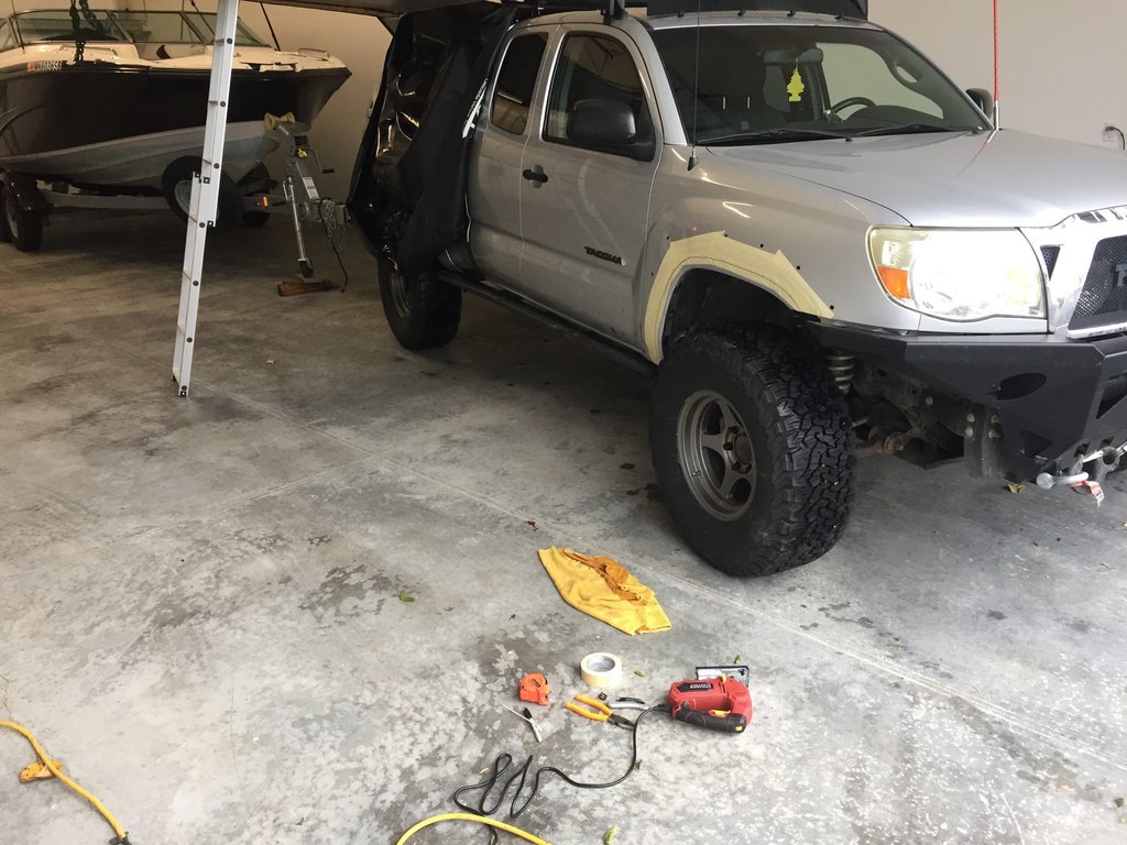

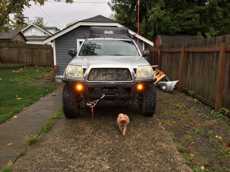

    In an effort to stop the rubbing from the new tires I cut 1.5" off of the front fenders. I think I'm going to keep the flares off for the time being since I broke pretty much all of the clips.
    I did the cab mount chop a week or so ago and I'm finding that i still rub it at full lock. Since I haven't had the BAMF plates welded on yet I guess I'm going to hack some more off before the welding begins.
