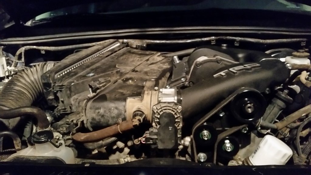

    Speaking of which here is progress as of right now. Book time for 6 hours is a damn lie unless you know these installs like the back of you hand. From 2:30 to 12 I was installing this thing and I still need to install the fit kit. After that this will be good to go. So as of right now, I would say 80% complete. Tomorrow I'll hit it fresh and knock out the remaining few quirks and fit kit and make it in time for my dealer flash install.

    Nice bro!!! Looking good!! Yea that's usually why inexperienced dealers super overcharge for like 12 hours on installs. Unless they've got a master tech that's done it a couple times, they charge alot. That actually makes me scared to take it to some places, if some dude is figuring out how to install from the instructions for the first time. I don't want that on my truck lol! To many horror stories of loose/missing stuff from the stealership.

    I don't blame them. It's really hard when you have zero experience with these things. It didn'thelp in my case that it was hot as shit yesterday either but hey, its coming along! I made myself a checklist of all I have left to do last night and now I have to head back to where it is and continue on.
