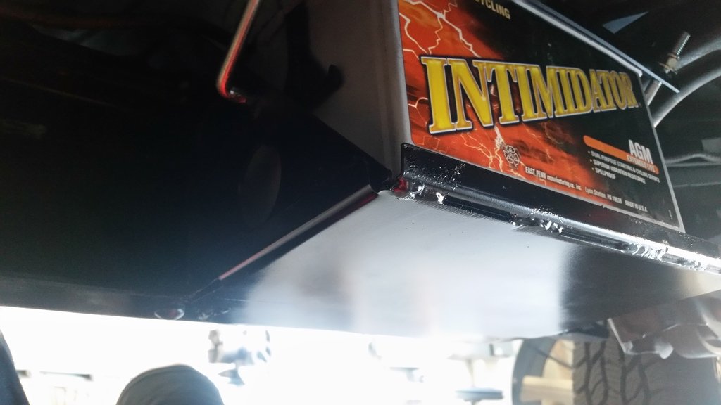

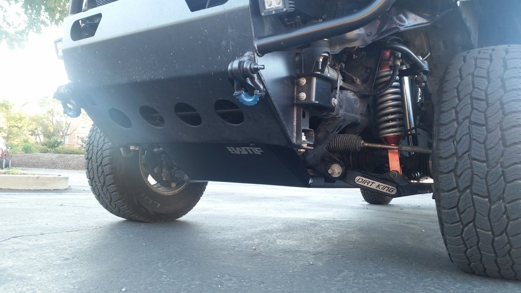

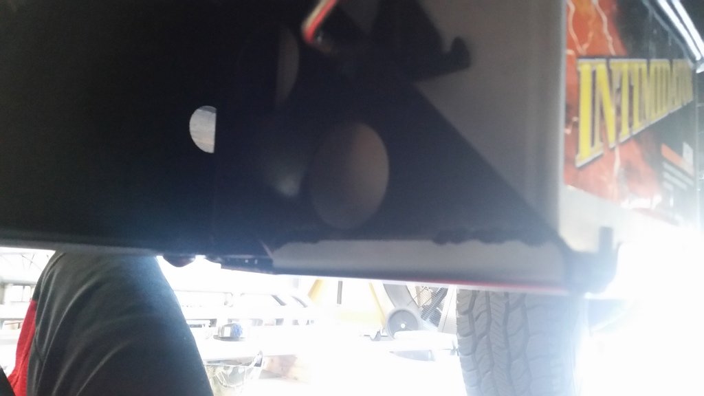

    Got my battery box braced up with some additional 1/8 plating today. This thing isn't going anywhere now.
    2nd gen IFS skid is back on and stronger than ever. Ready for some serious abuse. Thanks @JLee!

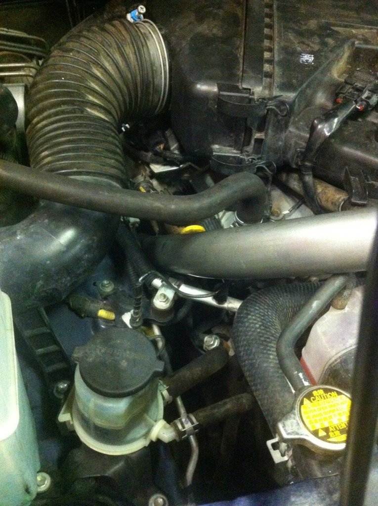

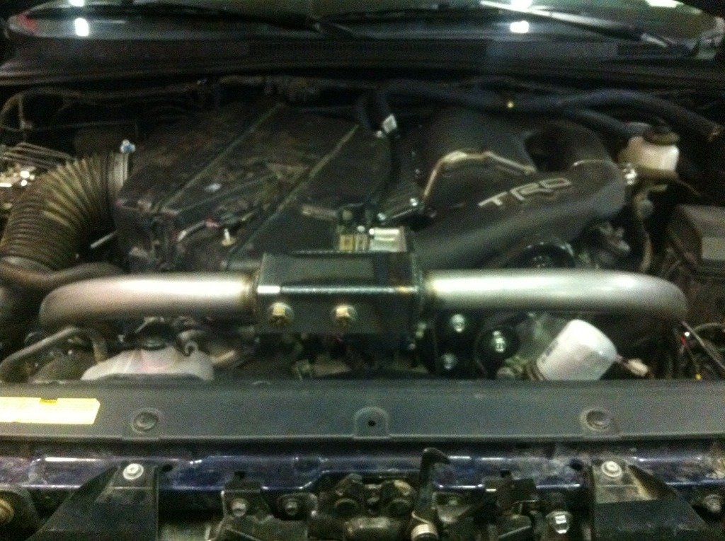

    Well. Here is what DTF has gotten done for me this weekend. I still need the bracing for the core support done though, I wouldn't assume thats too hard to make if he has the measurements. Maybe I can swing by before my trip back home and have some prefabbed bracing for the support made and all done by the time I show up.
    @ckeene9
    Looks like a big fat 'ol piece of tubing in there. Always a good thing.
    Biscuits, ckeene9 and Basikbiker like this.

    Front- Camburg 4x4 Long Travel 2.5" King Coilovers 2.5" King Triple Bypasses Wheelers Superbumps Rear- DMZ SUA 16" 3.0 King Triple Bypasses 3" 2.0 Fox bumps Wheels and Tires- 295/75/16 Toyo ATII XTREME SCS SR8 Dark Matte Bronze 16" Lighting- (2) 30" Combo light bars (4) Iggycorp diffused pods Tepui Ayer TRD Supercharger URD Mark III 3" Exhaust URD 4x4 Y Pipe URD CAI URD 2.85 Stealth Pulley Hurst Core Shifter with Hurst T URD Stage 3 clutch URD Lightweight flywheel URD Throw out bearing upgrade AEM Wideband AFR Gauge Speedhut Boost Gauge Craven Speed Flex Pod mount Weathertech Floor Liners BAMF Sliders Ultragauge sPod SE ARB CKMTA12 Hella Supertone horns Relentless Tailgate Reinforcement
    Just a single bar? Im gonna see if he can run one along the fire wall as well and then connect the two...hmmmm. Tim at DMZ strongly recommended double tubes connected for a crossmember like that.
    Obviously because of Supercharger thats not as easy, but for bashing on these trucks, i want every bit of strength I can get

    I was under the impression he would run two as well. If he only did one he must had done it for a good reason though. I go pick it up at 11, so I'll get to see if that might had been pics prior to completion and get to talk to him about it if it wasn't two.
    Yea...I'd definitelt ask about that. I was under the impression from Tim that a single tube will just bend under to much strain, whereas double tubes connected will be much stronger. Im no fabricator by any means, but i trust the guy that builds race trucks knows what hes talking about lol. Lets see what Tony says about it

    Can you grab a pic of the inner fender area as well?

    Yeah I know. I mean I don't know either, but it looks like he is using a single heavy duty tube in there which is much larger in diameter and thicker walled than the DMZ cage.
    I can a bit later man! These were pics snapped straight from him.

    Yea I noticed that. My only concern is that because you can't run tubing directly over/across because of the SC...having a tube run at an angle, even larger tubing, just doesn't promote good angles and strength...i was thinking there would be one like that and one on the fire wall with brackets connecting the two around the SC. Thats at least what im gonna request for mine lol.

    Well regardless, you are just sort of fucked anyways because of the large uptravel the tubing has to take, which isn't ideal in the first place but we have to do it because of the design. Because the tube is forward like this it does work in my advantage later on if I want to possibly tie in the radiator support brackets to it though!

    Yea agreed, hence the double tubes for more strength, but oh well. Huck your truck and let me know how it goes :D :thumbsup:

    Looks like 1.75", prolly DOM... It's pretty beefy.....better than nothin, plus u got those secondary hoops in there too which help
