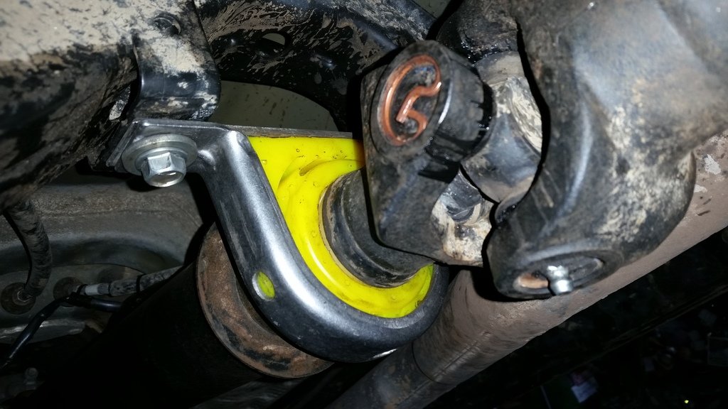

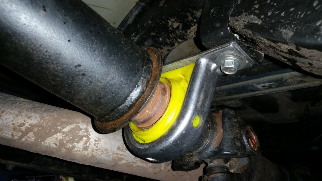

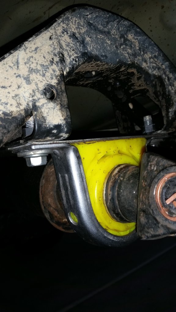

    Been a little busy lately...
    Feels awesome to drive and at take offs. All take off shuddering has disappeared.
    More info on this mod on this thread:

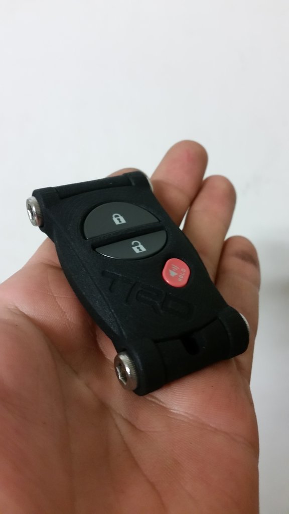

    Did this as well today. It's the little things that matter sometimes. I must say, it is VERY well made, and the tolerances inside to fit the guts of the remote are PERFECT. Very pleased with it.

    Millions

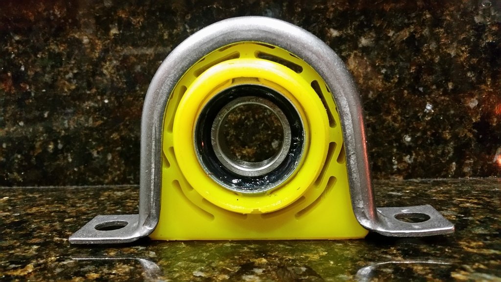

    Details on the poly carrier? I've not seen that one before. Looks good! Thanks.

    Front- Camburg 4x4 Long Travel 2.5" King Coilovers 2.5" King Triple Bypasses Wheelers Superbumps Rear- DMZ SUA 16" 3.0 King Triple Bypasses 3" 2.0 Fox bumps Wheels and Tires- 295/75/16 Toyo ATII XTREME SCS SR8 Dark Matte Bronze 16" Lighting- (2) 30" Combo light bars (4) Iggycorp diffused pods Tepui Ayer TRD Supercharger URD Mark III 3" Exhaust URD 4x4 Y Pipe URD CAI URD 2.85 Stealth Pulley Hurst Core Shifter with Hurst T URD Stage 3 clutch URD Lightweight flywheel URD Throw out bearing upgrade AEM Wideband AFR Gauge Speedhut Boost Gauge Craven Speed Flex Pod mount Weathertech Floor Liners BAMF Sliders Ultragauge sPod SE ARB CKMTA12 Hella Supertone horns Relentless Tailgate Reinforcement
    Hows the install on that? Is the poly piece halved so it fits right on, or do you have to break down the driveshaft to get it on?

    Boosted
    You have to break down the DS regardless to pull out the old carrier bearing. Then you press on the new one and the poly surrounds it. It's all one piece except the metal housing which surrounds it. Then obviously you have to create the upper crossbar to keep the poly and CB from bouncing up and down as you drive around.
    Ahhhhh ok. So hand tools work?
