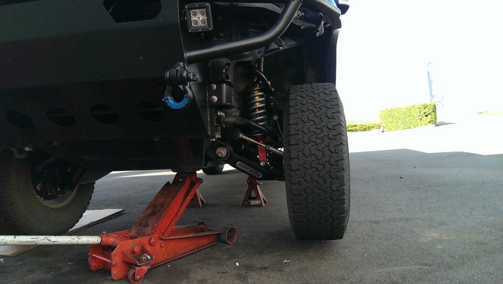

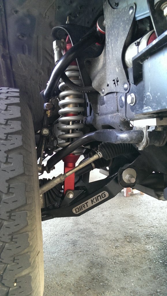

    Well, it was a long day.. after hours of cursing and sweating the truck is back together and good to go for Pismo!
    In this photo, the tire IS jacked off the ground.
    I know for a fact that I gained some suspension travel and tire clearance as well because when it came time to throw on the tire back on the fronts I was unable to do so unless I jacked it up some more. Where as originally the tires came off at the level I originally jacked it to with some inches of ground clearance to drop them onto.
    The ride is SO much different with lowers and uppers. I also believe because the lowers are uniball as well, that I was able to obtain some more free range of turning motion. The tires turn to the sides so much more then they ever did with stock. So much so that my 32's rub on my mudflaps :eek:

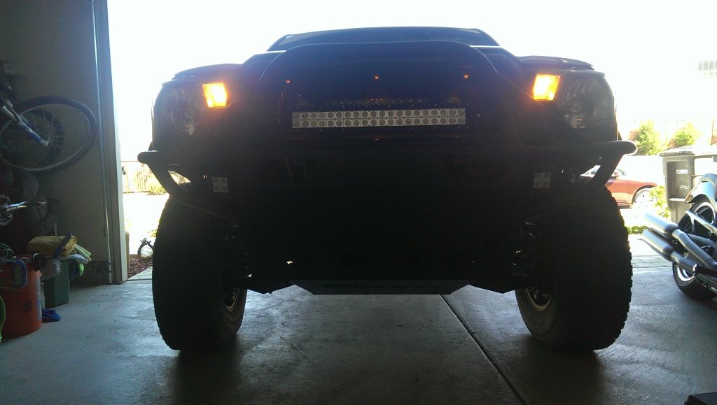

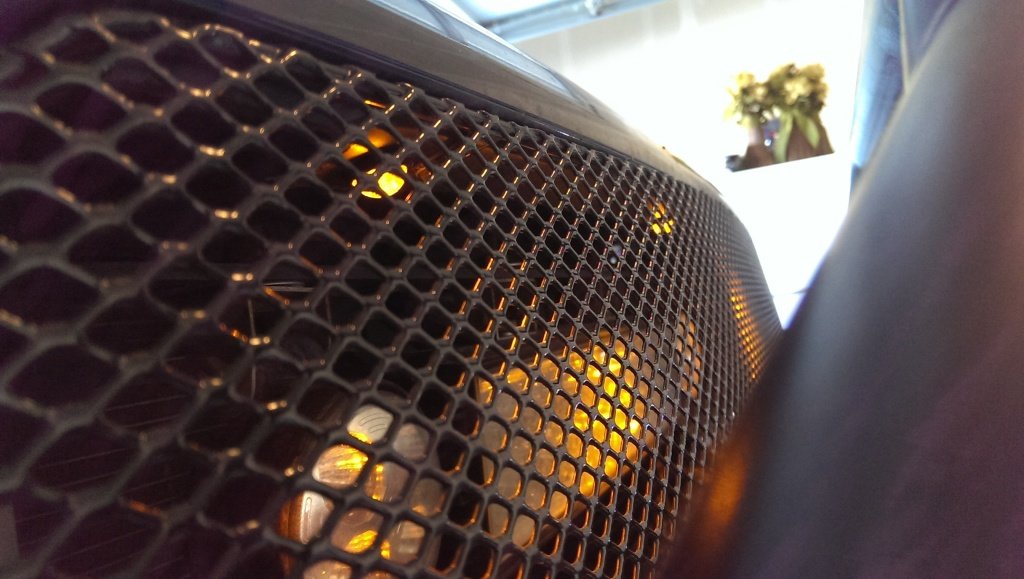

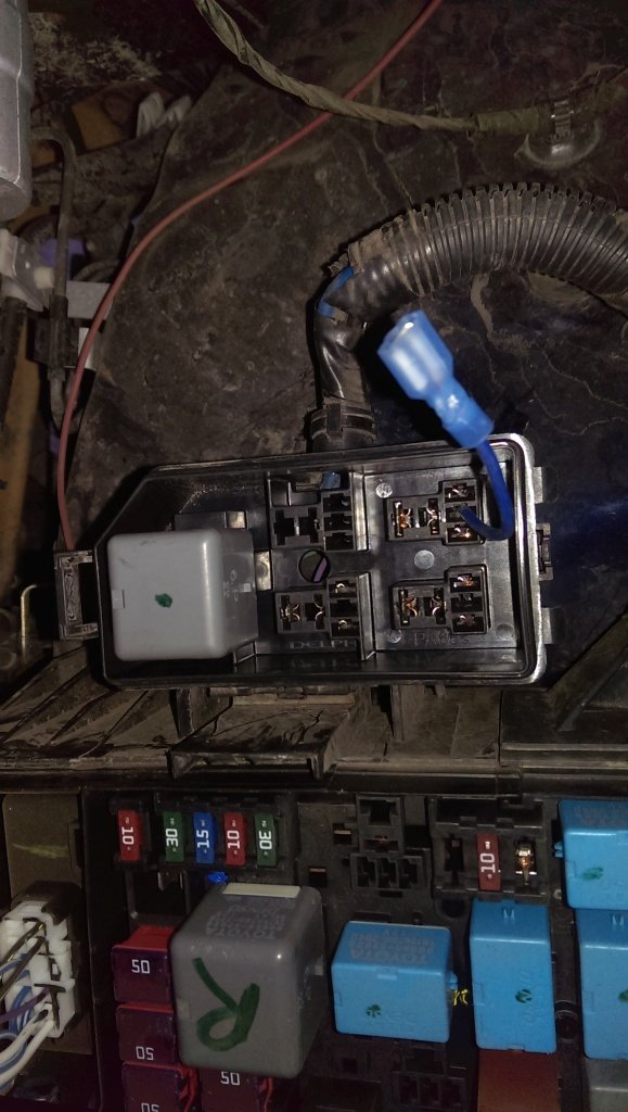

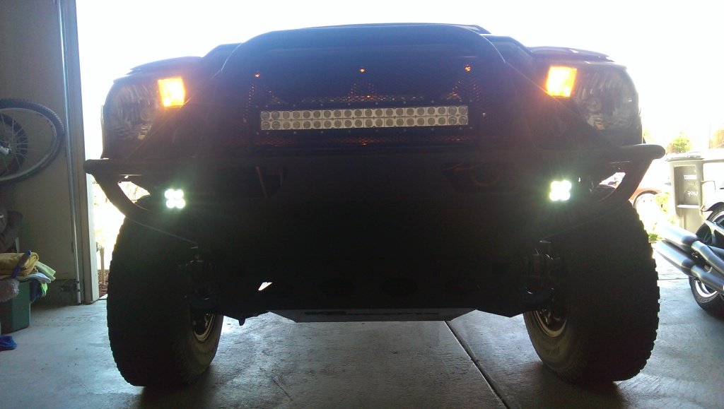

    Here is the new Raptor Grill LED light mod that I did a little while ago. What's the general consensus?? Wired to the DRL's, or to the DRL Anytime fogs circuit??
  4. Sep 14, 2014 at 3:07 PM
    #44
    Gaunt596
    Gaunt596 Well-Known Member
    Jun 19, 2013
    #106627
    5,790
    Matthew
    Central Maryland
    Need to be wired to the parking lights, the DRL lights are also your turn signals, and will make your raptor lights flash as well depending on which side you wire them too....
  5. Sep 14, 2014 at 4:50 PM
    #45
    12TRDTacoma
    12TRDTacoma [OP] Powered by Ford, GM, VW, and Mercedes
    Aug 20, 2012
    #85133
    16,671
    Rob
    Concordia
    12 TRD Sport DCLB 4x4 Supercharged
    Boosted

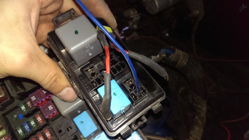

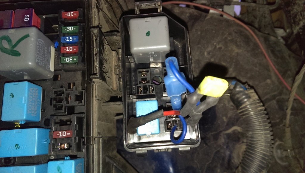

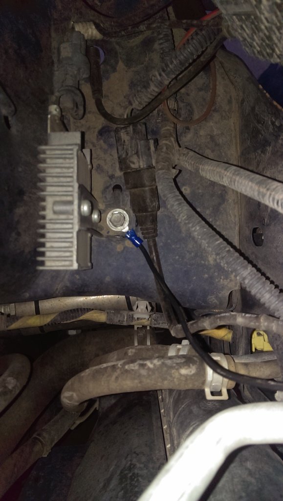

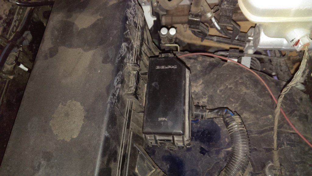

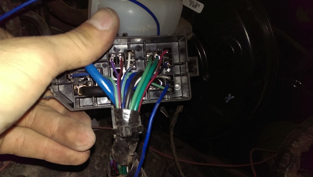

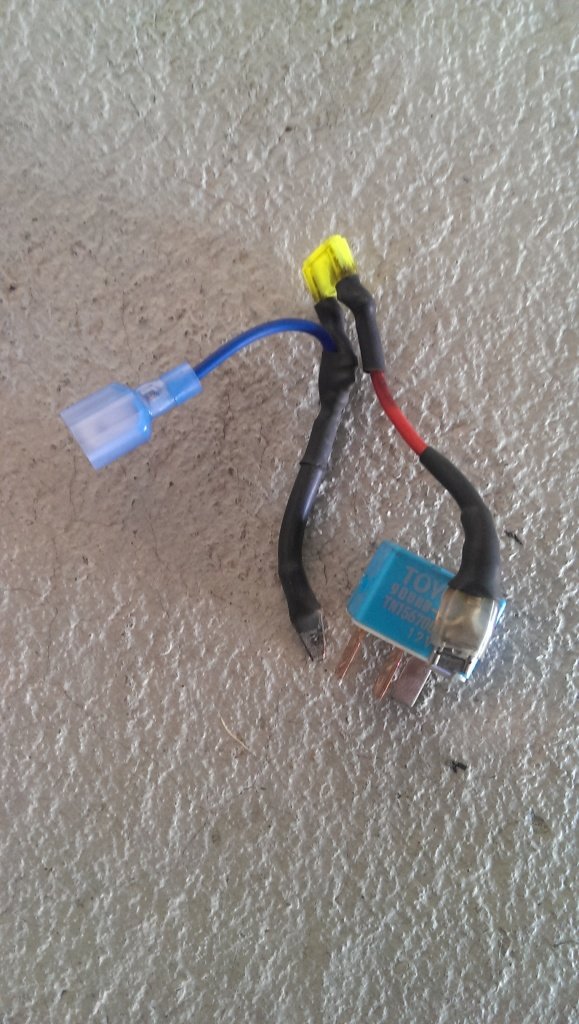

    Here's how I wired them. I started by tying all the wires in parallel and wired tied them to some small holes I drilled into the back of the grille. This part wasn't difficult, just tedious and time consuming.
    After that I ran my ground to the body.
    Now here came the hard part, just trying to figure out how to wire the power. Initially, I wanted to run it to the DRL only, but the issue with that more then anything was that the DRL uses some kind of funky setup to run, its not just simple power on power off. So I got to thinking, maybe I could just run it with my current DRL fog anytime mod!! Back to wire routing and working I went.
    I pulled the secondary fuse box off of the main box, then pulled off the lower cover as well to expose the bottom where the wiring runs to and ran my wire through an open pin which was coincidentally right next to the pin where the power to the DRL anytime runs to.
    I then snipped the wire to length and added a quick disconnect plug to it.
    Here is where the magic comes from. I took my current DRL anytime relay setup and decided to run a quick disconnect plug from it also. I soldered a loose wire from the one I snipped and this is what I turned out with.
    Plugged it all up and it turned out very clean and simple. You cannot even tell there's much of any wiring there outside of stock at all.
    Final product.
    Thinking about it in retrospect, I will need to add a quick disconnector set to the power wire by the grille and maybe to the negative side as well to enable quick disconnections when re-installing and removing the grille.

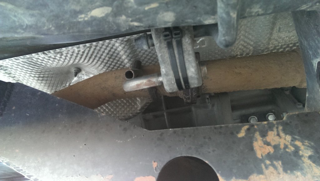

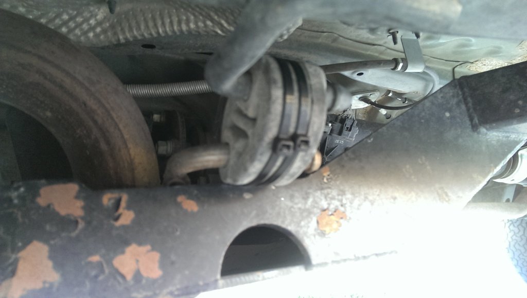

    My Relentless Fab T-case skid (like many others) plagued me with the most annoying rattling exhaust in reverse and at certain RPM's in drive for the longest time! I actually gave up for a while and just decided to live with it as annoying as it sounded, but today I got an itch to do something about it, so I started looking at polyurethane exhaust hangers to combat that, after a while I got to thinking to myself, why not just take a different approach to fight the stupid rattle?
    The cheap, yet effective solution:
    Alternatively, you can also use radiator hose clamps on them, as they would be much stronger, but honestly, these work just perfectly! :)

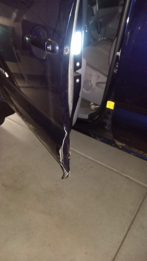

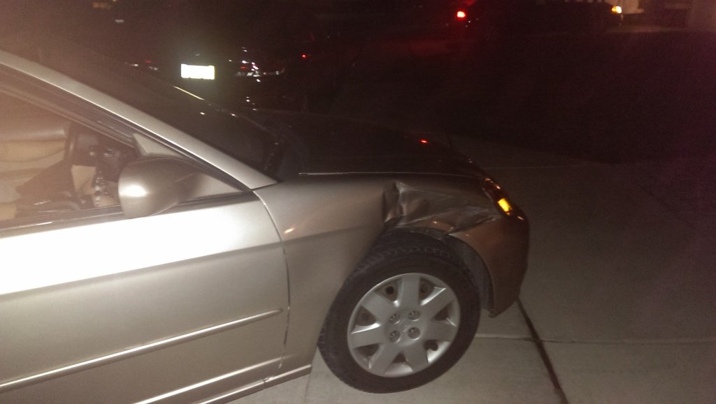

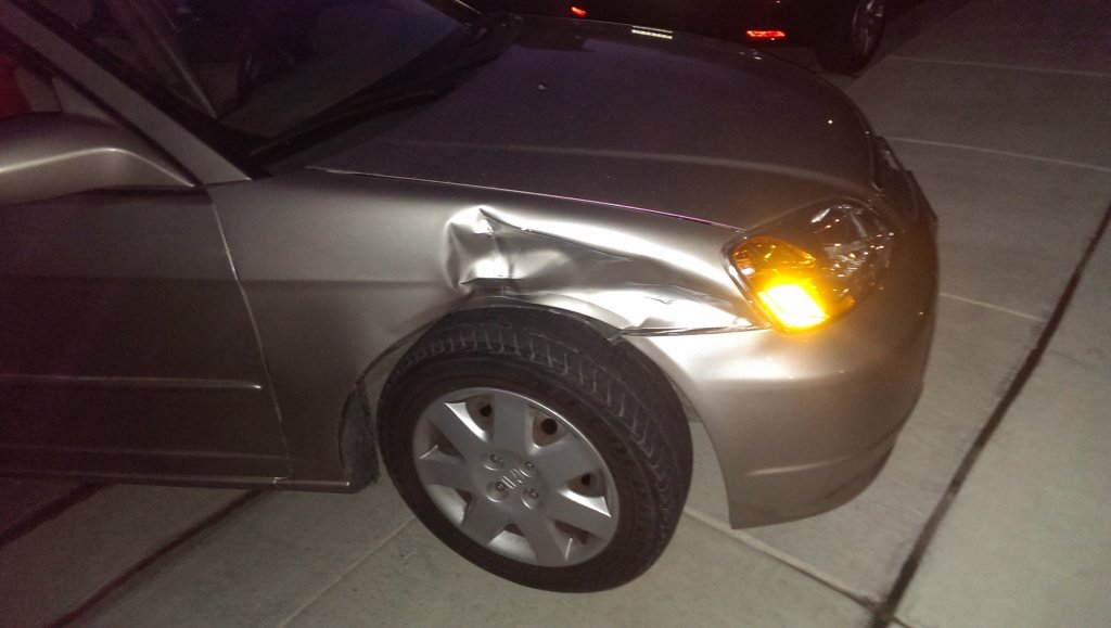

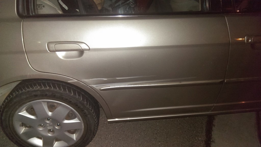

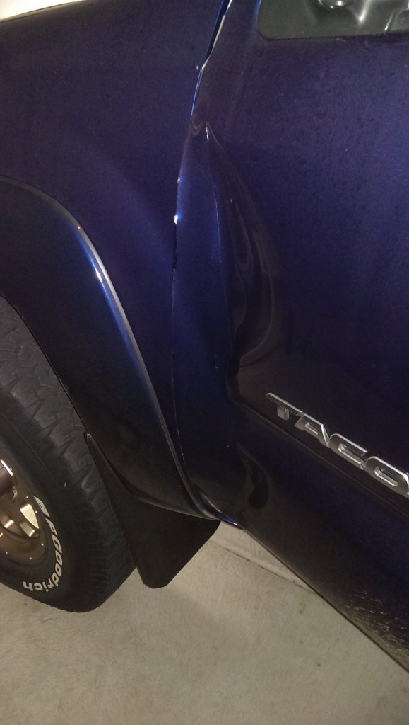

    Well, close to three years into ownership. This finally happened. Thanks to this dick off I can now no longer drive my beloved truck. :'(
    This is why I'd rather be wheeling then out on the road next to dumbasses. This was right in front of my damn house, I was standing right at it when it happened, I wasn't even moving!!

    I'm pissed. I've been dealing with it since 6:15 this morning. I'm still dealing with it too. Phone call after phone call.

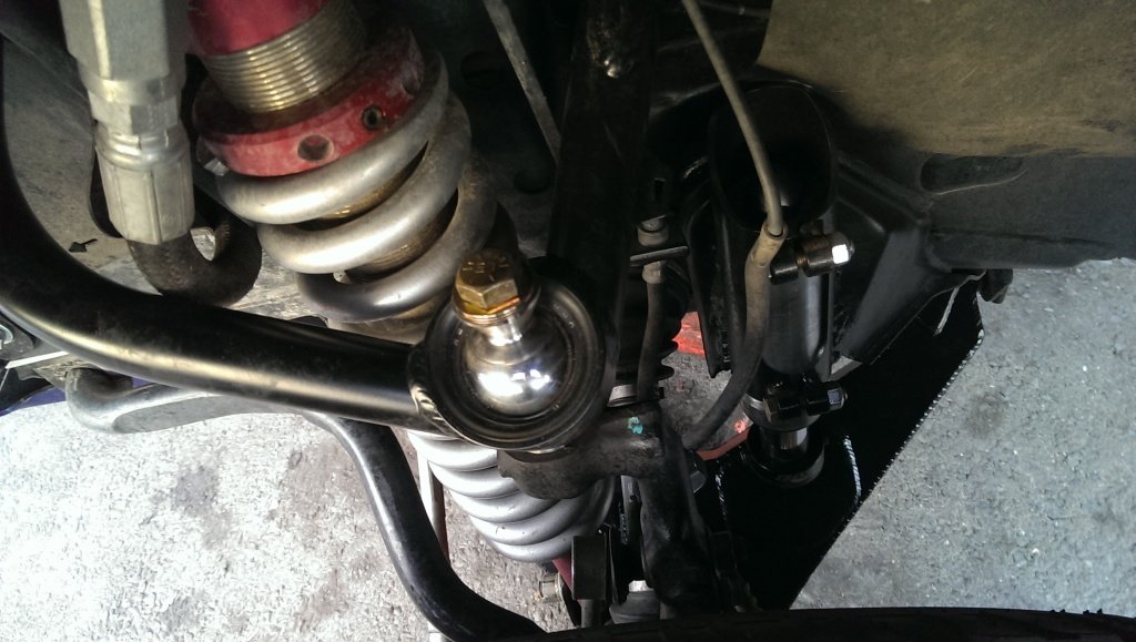

    Oh sh't. That sucks. How did keak fix/break his uca?

    I guess he put the joint back together. Literally... Hahaha.

    Oh. it didnt snap like last time. the joint pop'd out. Interesting. Hope you get your truck fixed soon.

    Just as an update, this accident may have been a blessing in disguise. What I will end up doing is having the fenders redone to Glassworks Baja fenders, and take the extra money I'll get from this and buy air bumps for the rear end.

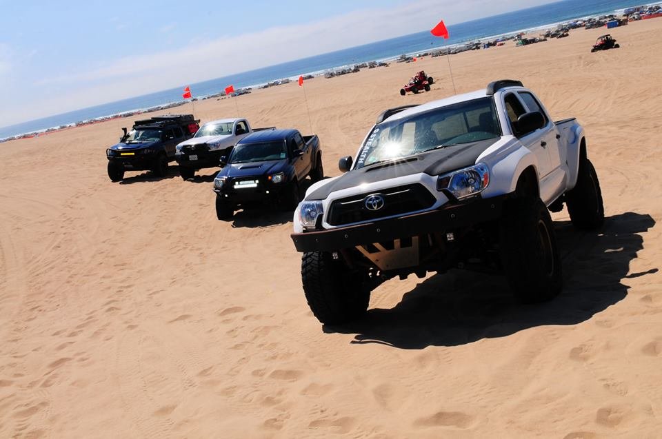

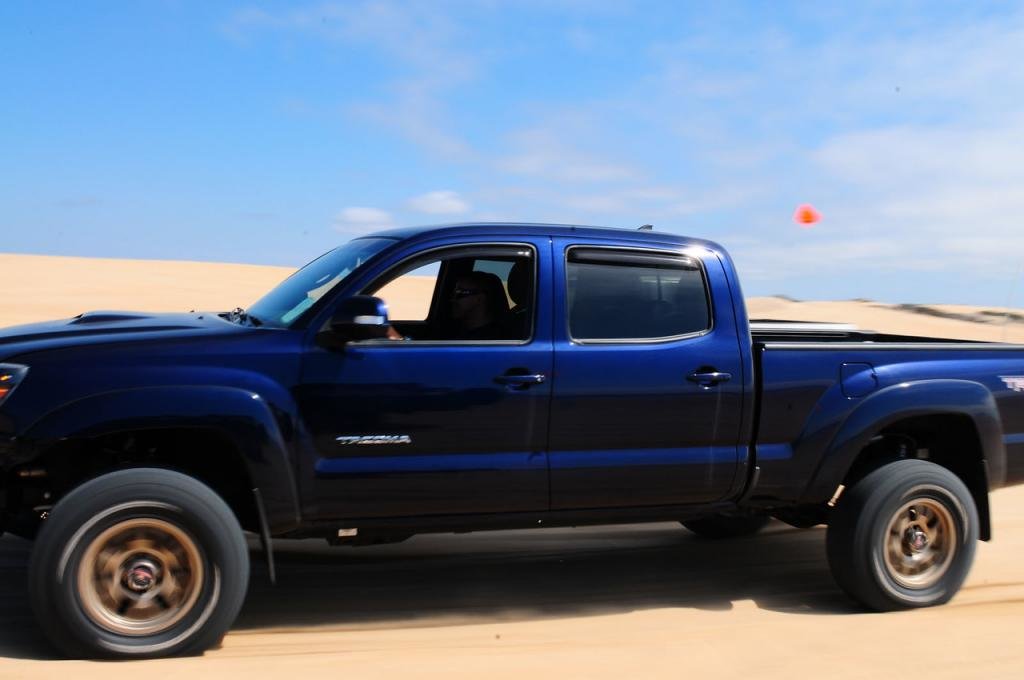

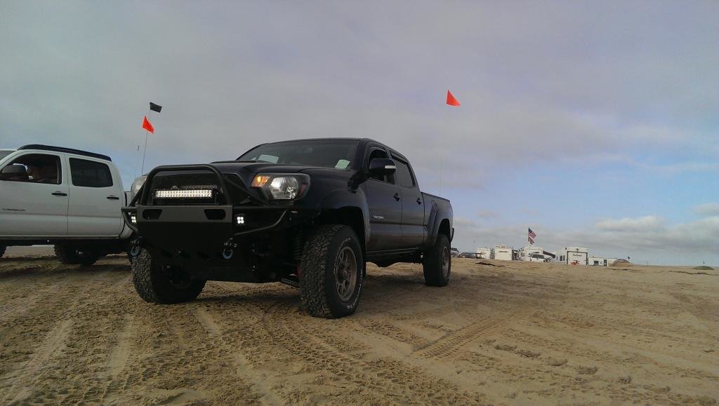

    Pics from Pismo Beach
