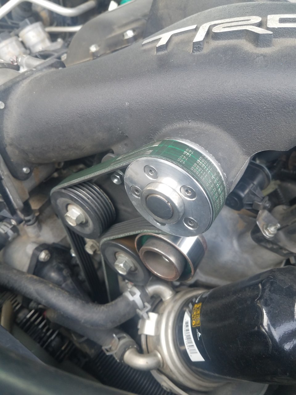

    As for me, yeah well, that was before I discovered an option existed for our blowers which was never previously known about to change out pulley sizes in less than 5-10 minutes.
    After I found out about that, that option became the only option which I knew HAD to go on, no matter what labor was required to be able to do so. :)

    I just didn't like how the only way you could mod on these was to do a press on style design. It was not okay and I couldn't believe that the design was only around in 6-8 rib designs like for the Grand Prix blowers. So I got to searching and eventually wound up here. It was worth the time and effort, not to mention it looks great!
    Thanks for reminding me I needed to update my list of mods on here. I have since the time of my last update hollowed out the hood scoop vent for additional heat extraction and also added in my Aerocatch hood latches finally! Both worthwhile mods. :woot:

    Absolutely a massive upgrade over the stock press-on style pulleys. I know ill never go back..

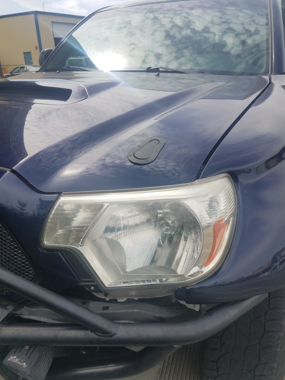

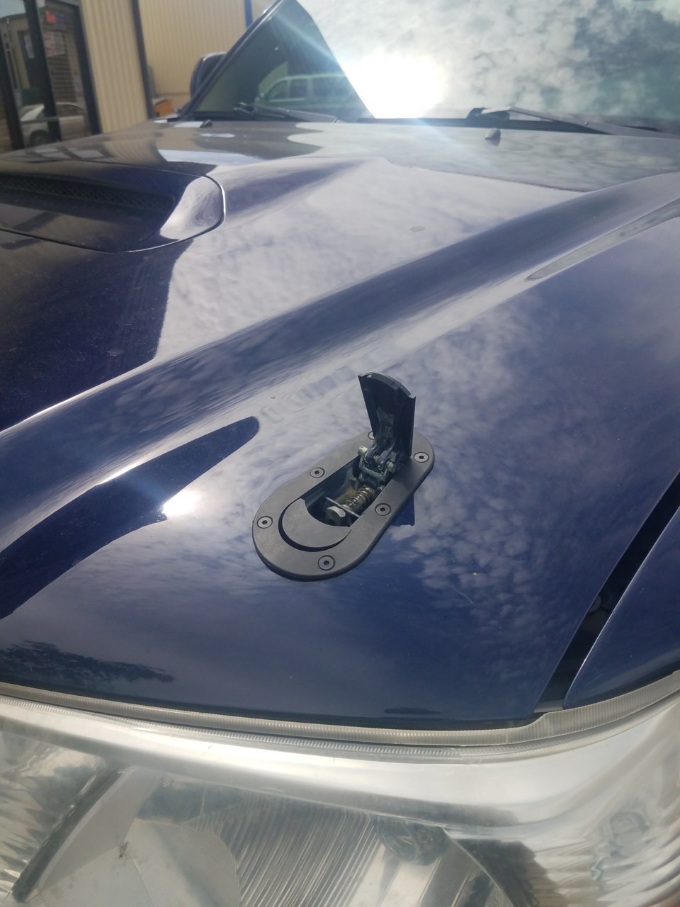

    The Aerocatch hood latch mod was not fun and install was not pretty, but it works and you can't even tell it was modded over, they just fit.
    The hood scoop was also another that was difficult to do because it is one solid piece so I had to drill/dremel/ and file away tons of plastic to make it work. I did the mod strictly for better heat extraction due to my AC system suffering massive heat soak at idle during 90-100* F days here in California. The fan was not capable of moving enough air to shed all the heat build up the AC was creating. That's really why I did it. It doesn't look perfect, but it damn sure works and it works well at that!

    Looking good! Is that an aftermarket hood, or did you just modify it to fit those hood latches? Im digging the fiberglass fenders too. So much good stuff going on here!

    That is the factory hood actually! I had to modify it to fit the latches. I put it off for a long time because I was afraid to cut the metal but eventually did it, I'm glad I did too because that hood flutter I would get would scare the hell out of me.
