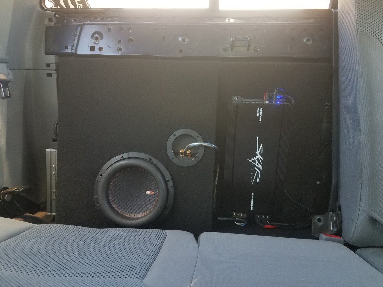

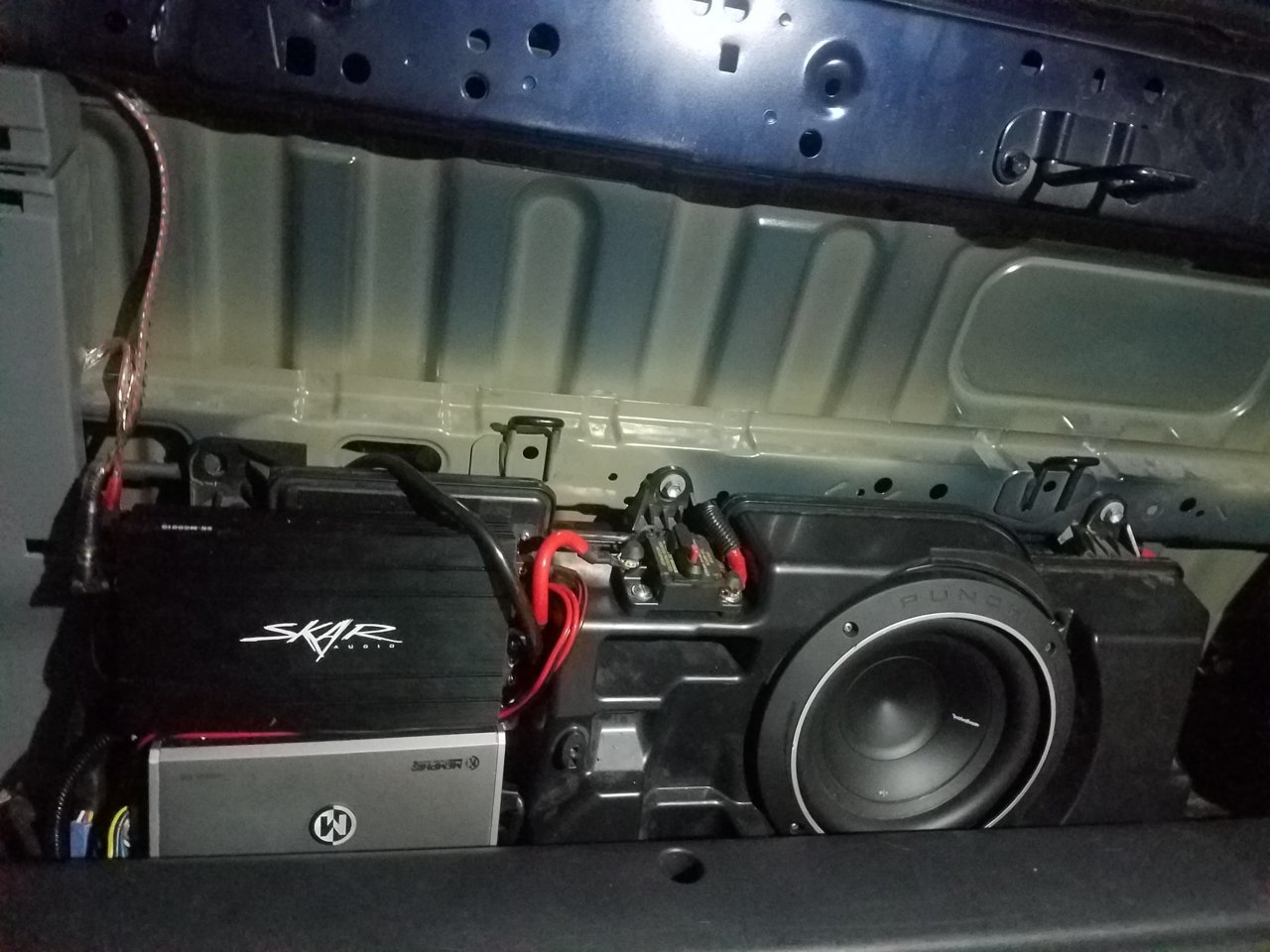

    Had a moment of creativity and the desire for more bass, so I worked as hard as I could to retain an incognito like stealth look all while running two amps and retaining the factory style setup. One is for the speakers and the other is exclusively for bass handling. I am just about done and need to do a little more trimming on the large rear panel for it to fully drop in, but it fits, it's mostly hidden and it THUMPS for a little 8".
    For additional aid in helping the OE enclosure sound better I filled the interior of it with polyfill before dropping in the P1 SVC sub. I decided to rig an in-line marine style breaker quick disconnect system instead of a inline fuse from a previous project for the main power circuit. It works incredible and fits behind the panel without getting tripped off.
    The system as a whole is just massively loud and is plenty for what I was after. The JBL setup should had came this way from the factory.

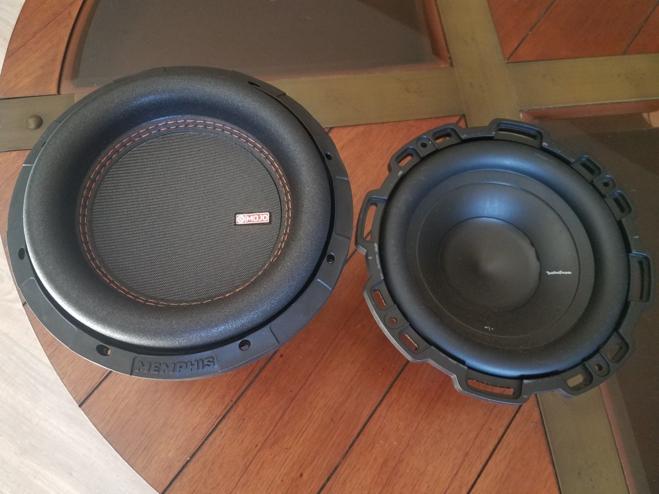

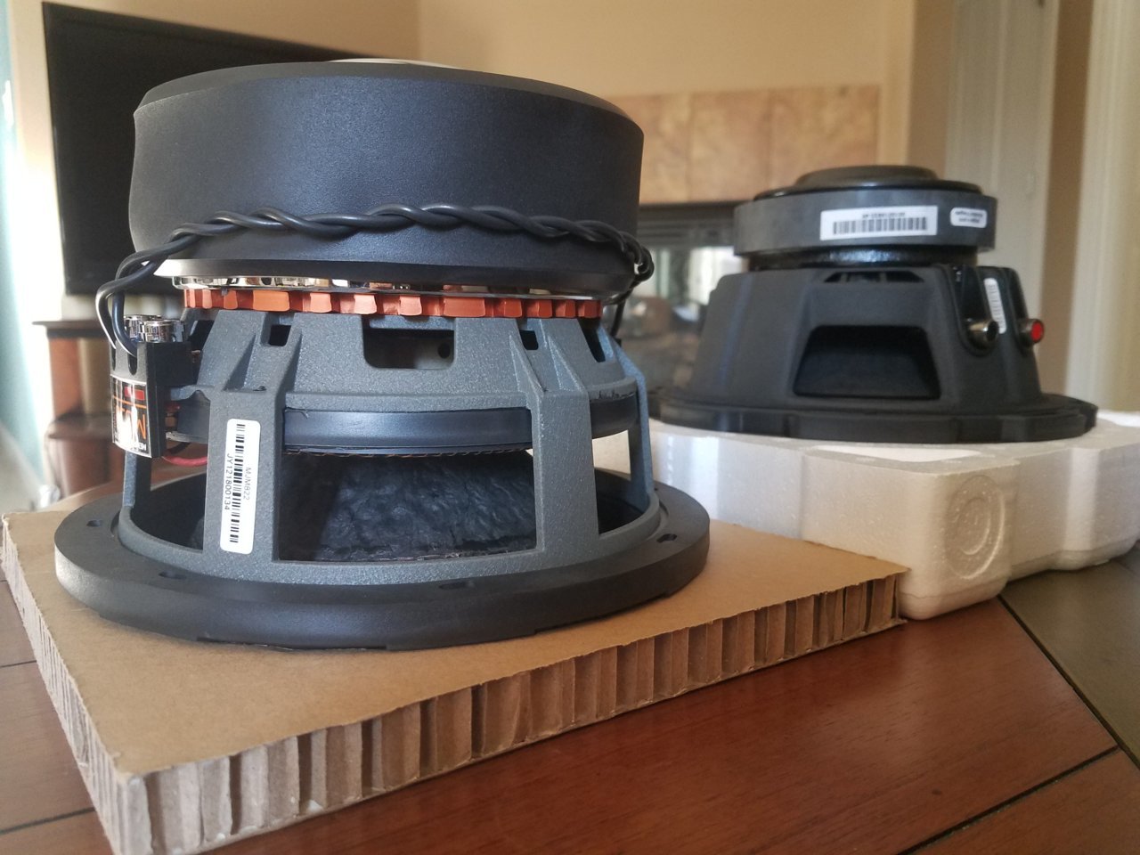

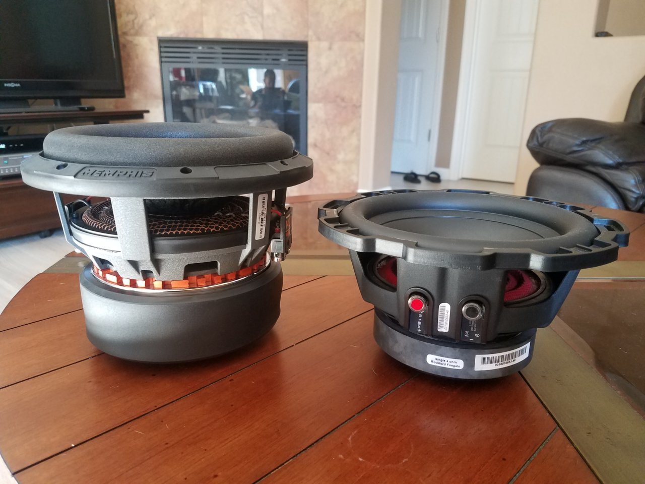

    My first and oldest of the most recent mods was the subwoofer setup. I am running a Memphis Mojo M6 and this thing BLASTS the cab for a 8" take a look at my old SVC 8" Rockford Fosgate sub for size comparison purposes. Needless to say this required modification of the backseat in order to fit correctly and I only recently was able to get it all to fit back in correctly and still function close to OE. The seat fitting and working correctly is still a work in progress to get it to work 100% like OE again. (The only part which I have not regained is the fold down feature which turns the backseat into a flat floor without hitting the sub face and causing interference. Everything works again otherwise.)

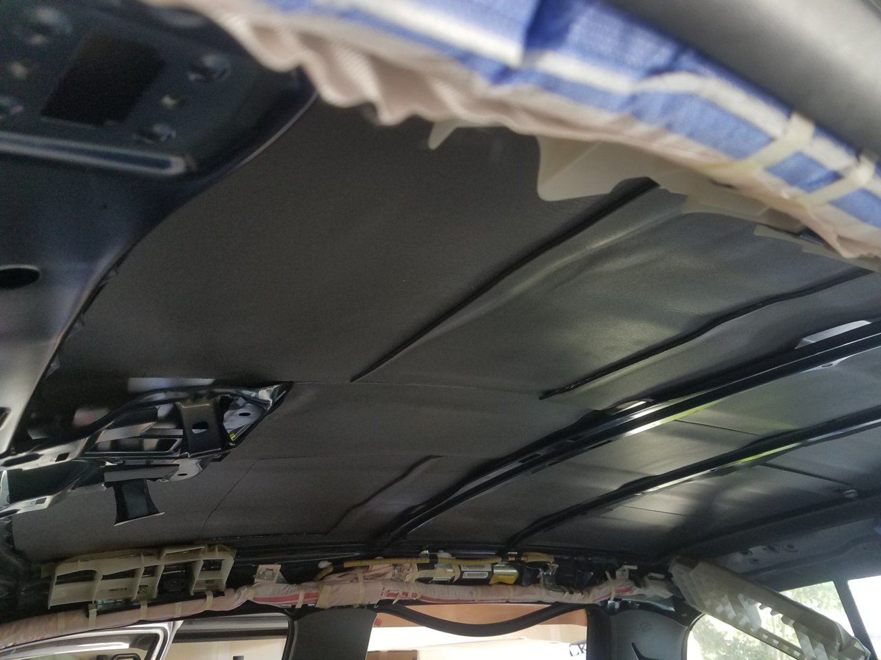

    In an effort to get better sound and mostly combat heat during the summer months, I removed my headliner and installed some Noico matting. I then installed some more liner above this stuff, not pictured, but you get the idea, the roof sounds nice when you knock on it from the outside now. Lol. This was a MAJOR pain to do because dropping the headliner is really annoying.

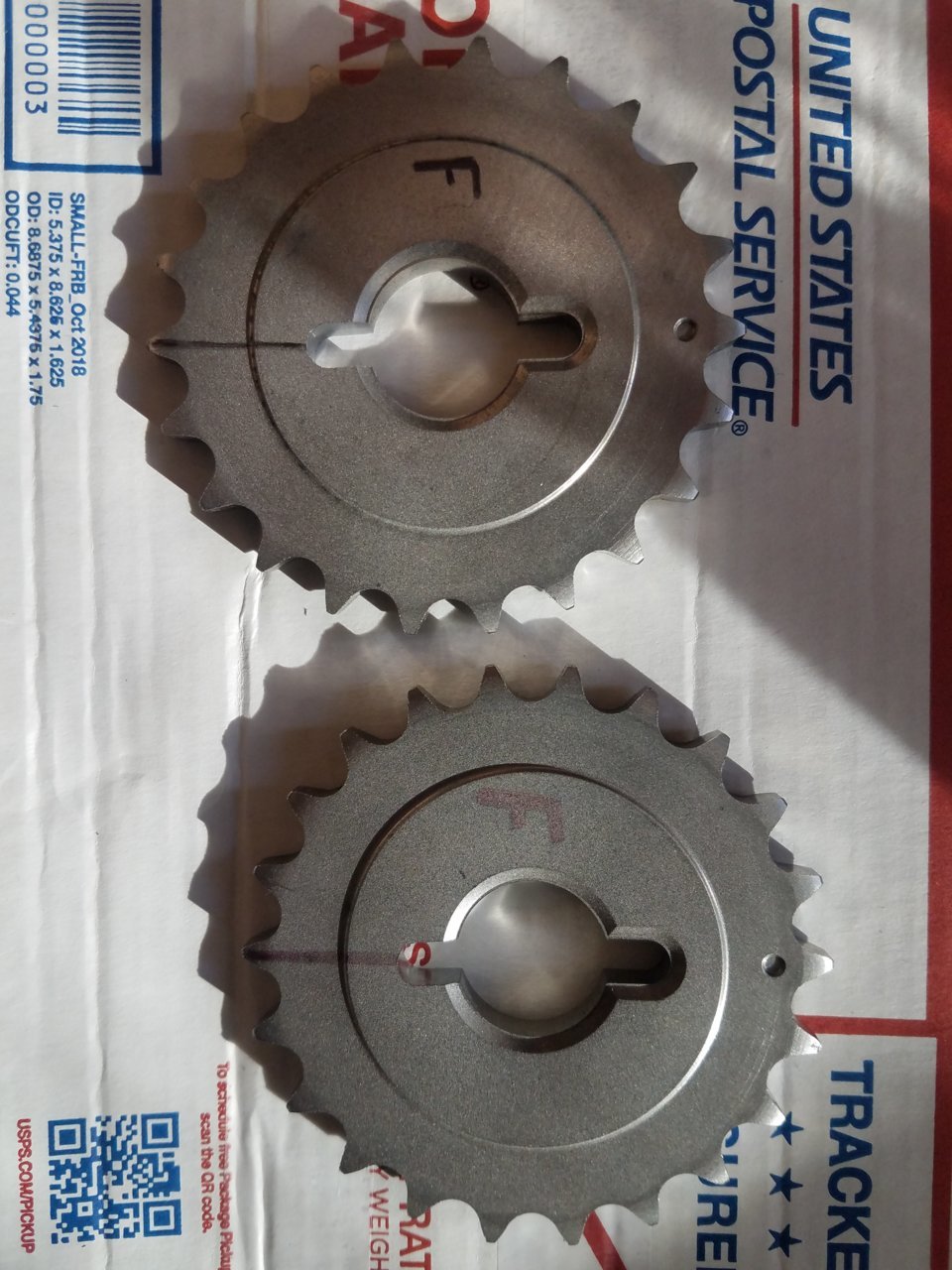

    Next up is cam gears. I didn't take a picture of them installed, but they are in and ROCK over OE function. Thanks @mightytacoman for making these for us! This is a picture of them marked and ready for install. The install day sucked, but it was done so that's all that matters.

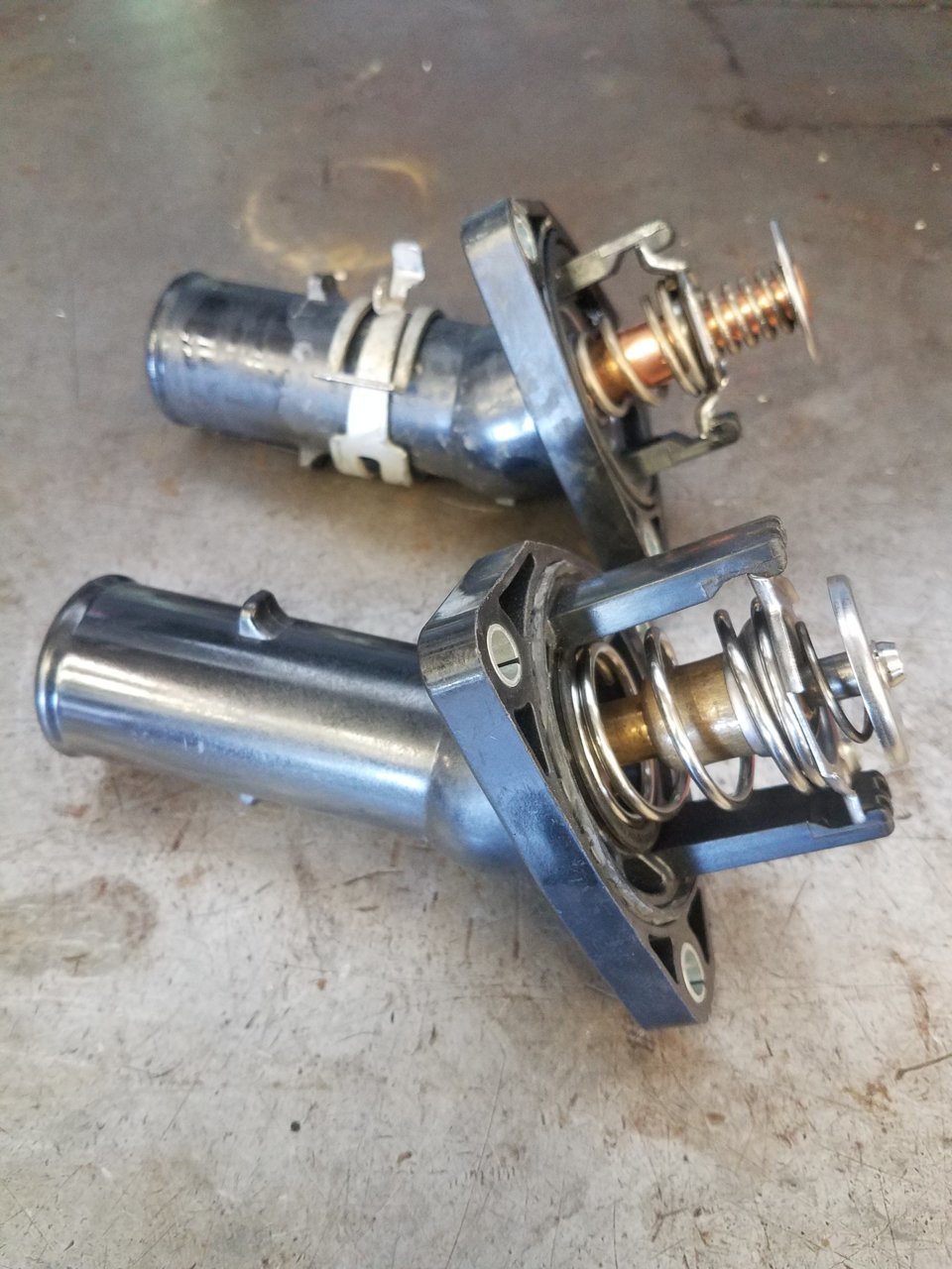

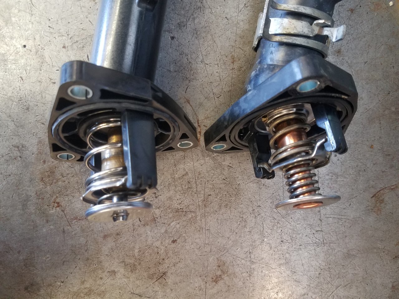

    While I was installing the cam gears I screwed up my OE T-stat so I took the liberty of installing a 160 Mishimoto thermostat. Pictured below is a side by side comparison with that of Mishimoto in comparison to Motorad. The quality is immediately notable. (Motorad has the clamp on the neck, Mishimoto does not)

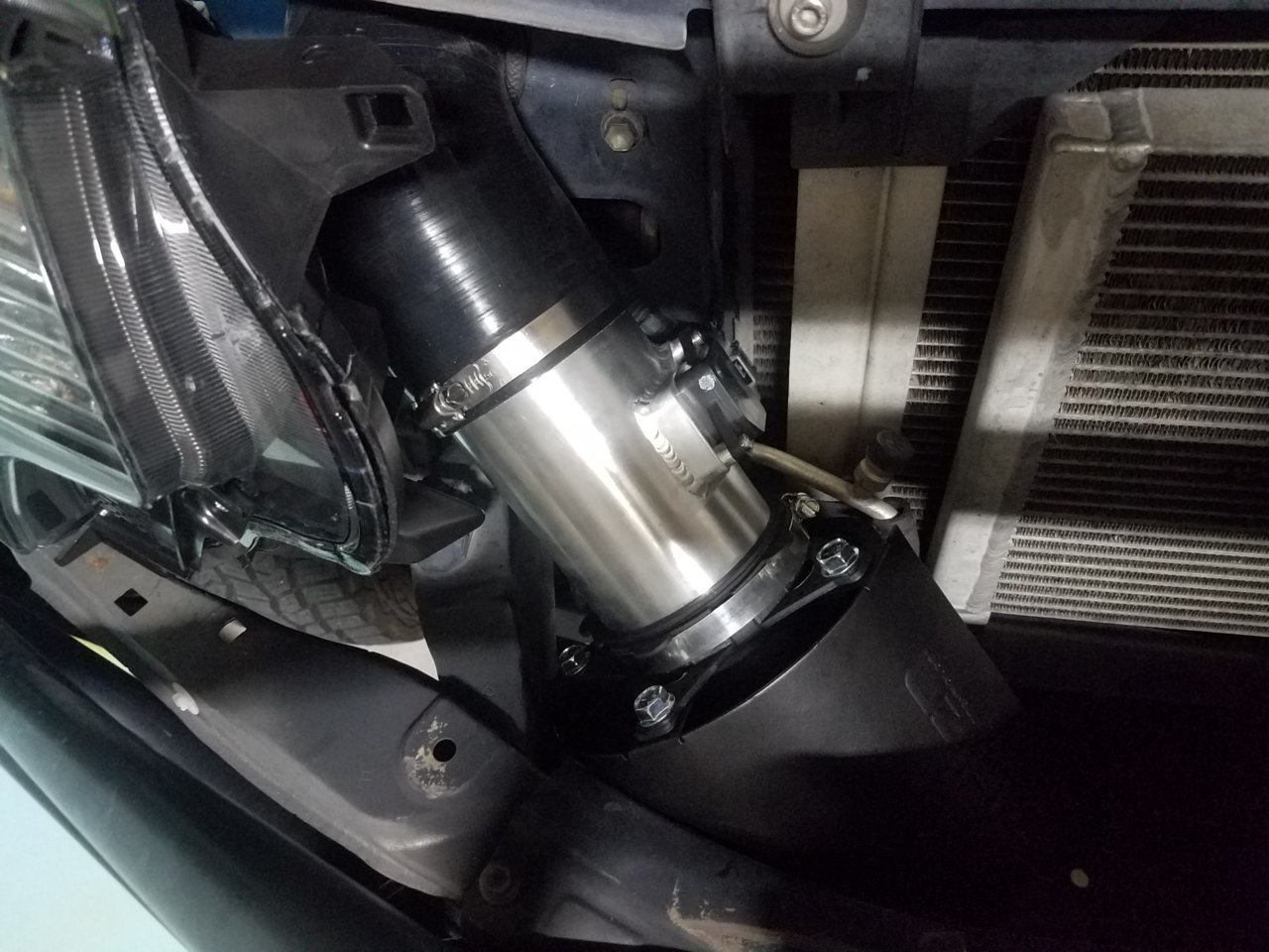

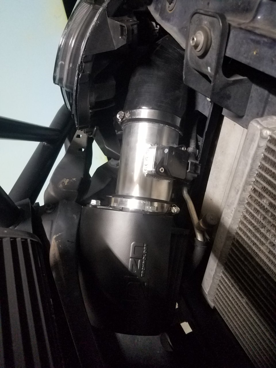

    I also went ahead and upgraded my MAF tube and half portion of my URD ram air intake to a really nice 3.5" unit. The MAF tube has a built in honeycomb for improving airflow across the MAF itself. Very nice touch. The MAF adapter tube is built by MRP and will set you back some $100 if I remember correctly. Worth it though.
    Link below if you want to see more photos of it:

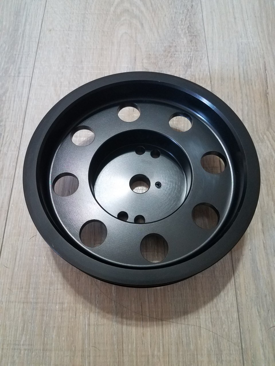

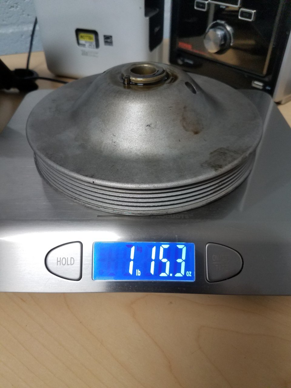

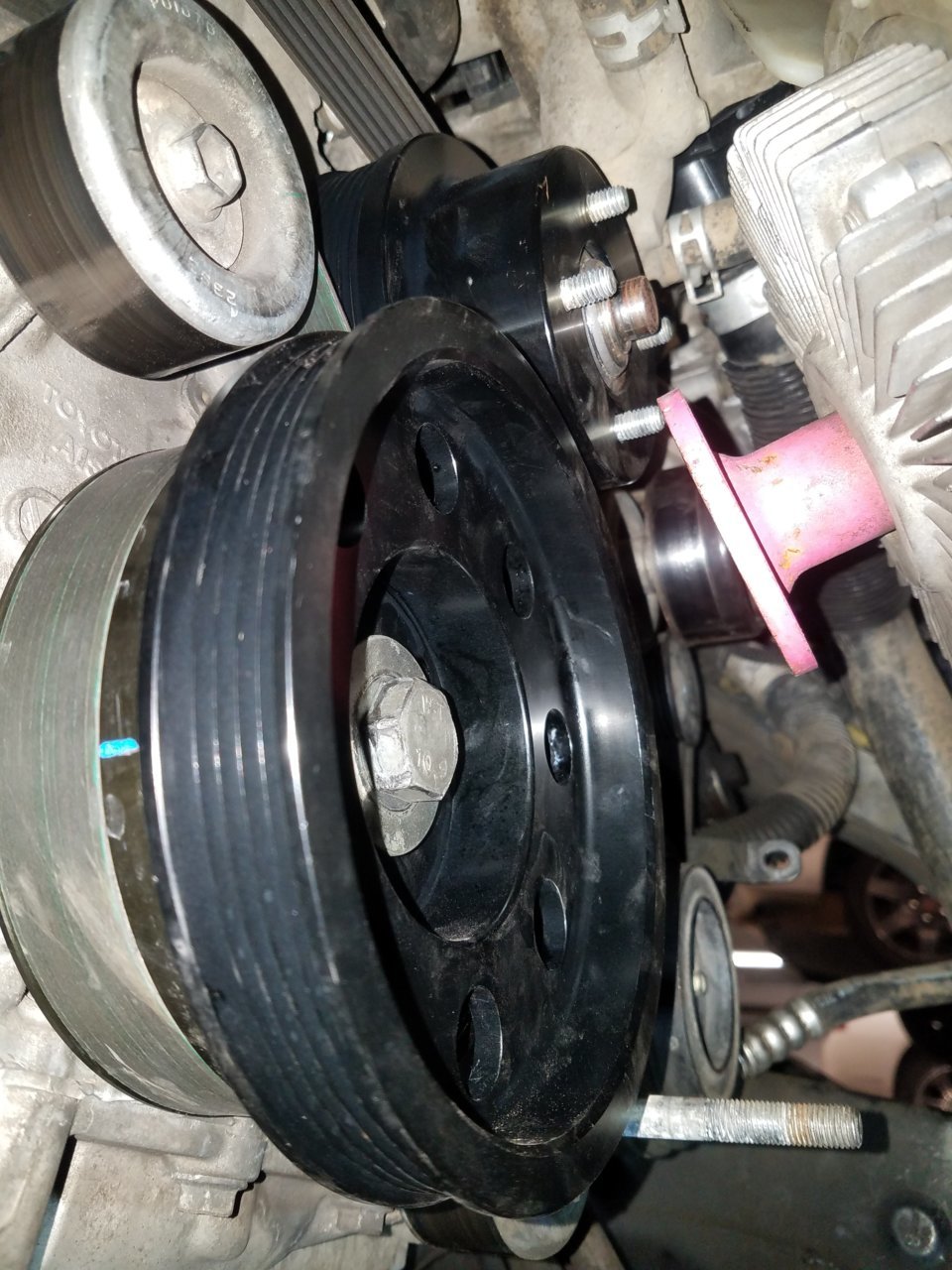

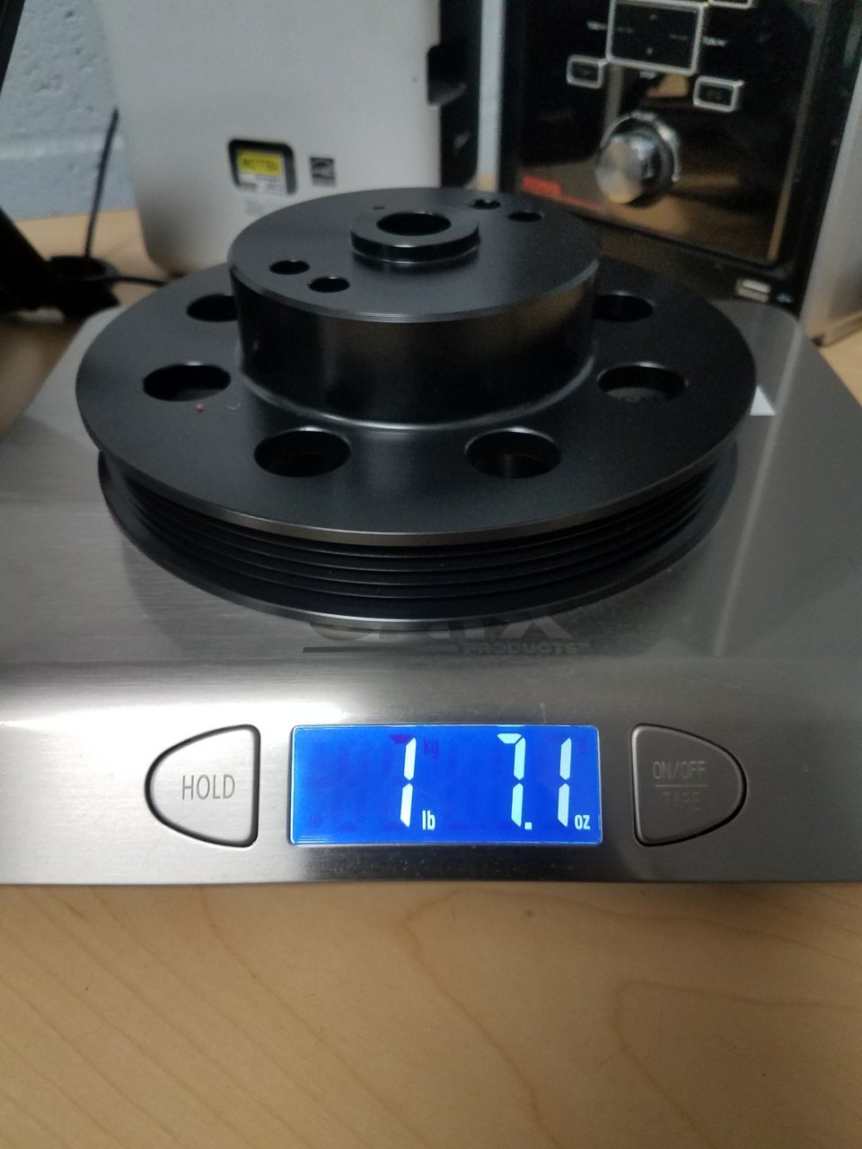

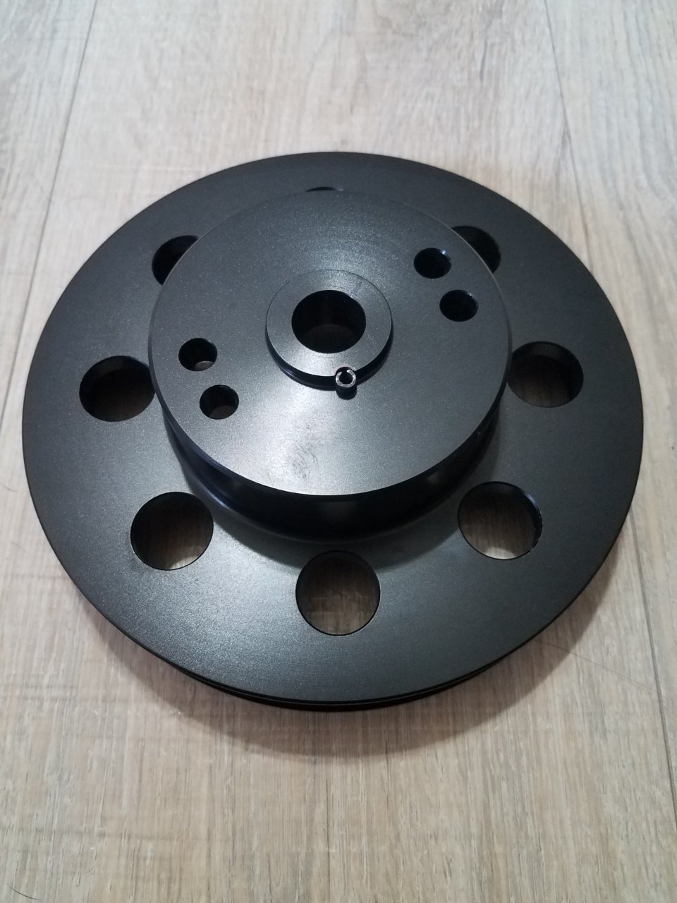

    Next up is my custom lightweight supercharger crank pulley, the lightweight crank dampner, and water pump pulley, all made by NST, the supercharger crank pulley is a one off prototype that they built for me in efforts of the group buy which is still in the production phase of the group buy for my supercharger group buddies they should start getting their units soon actually.
    Old pulley on the scale for weighing
    New pulley
    Installed

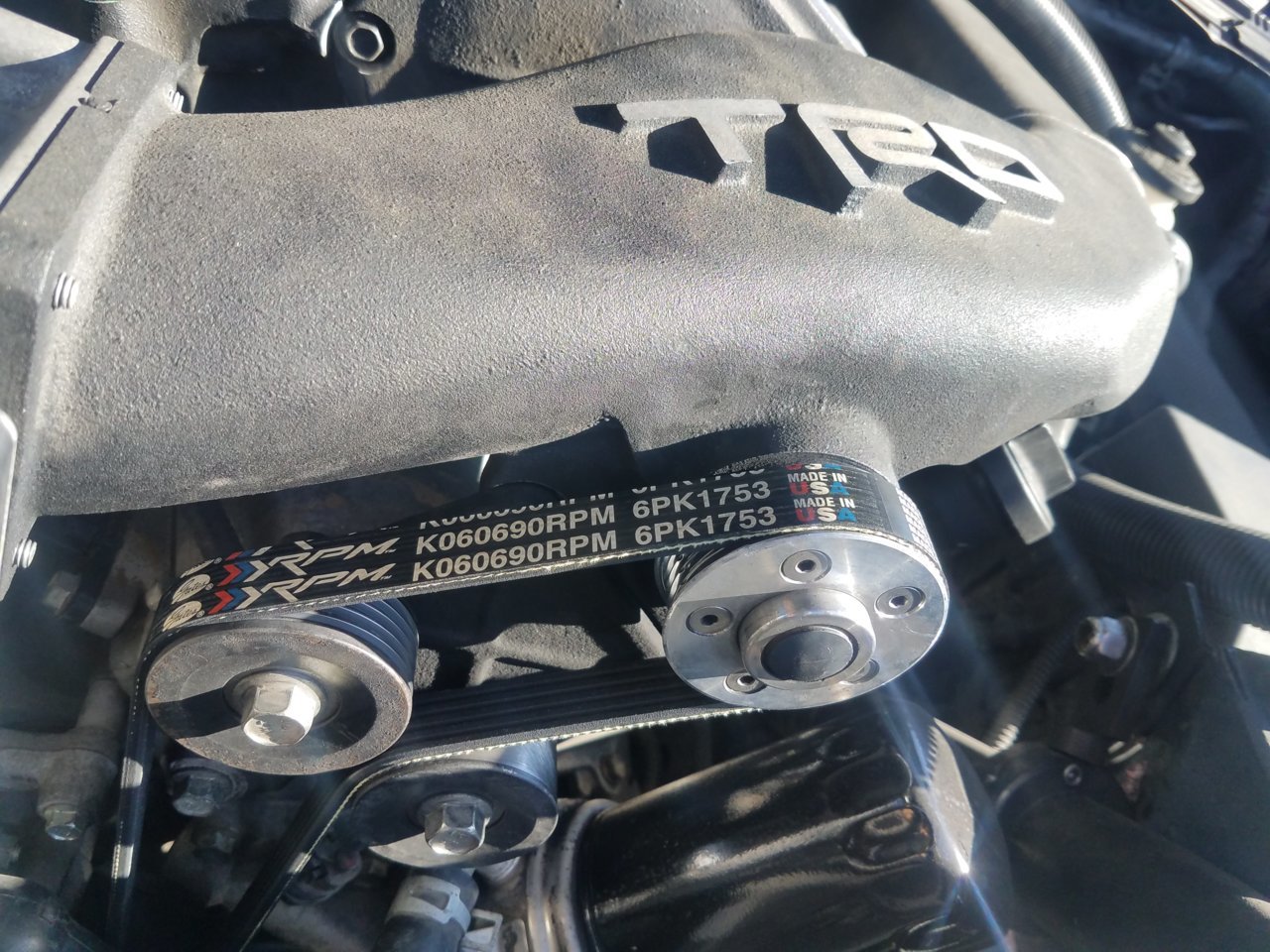

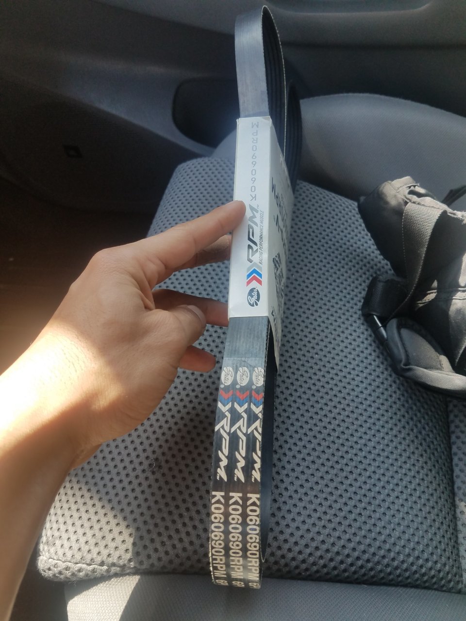

    In efforts to make my blower build more reliable and more stealthy, I installed a Gates RPM series belt, this was a huge help in ensuring belt longevity! I thrn removed my 2.3 pulley, sprayed it satin black and then added some black screws sent to me, big thanks to @Norton for hooking it up with the screws, this should help it come inspection time!

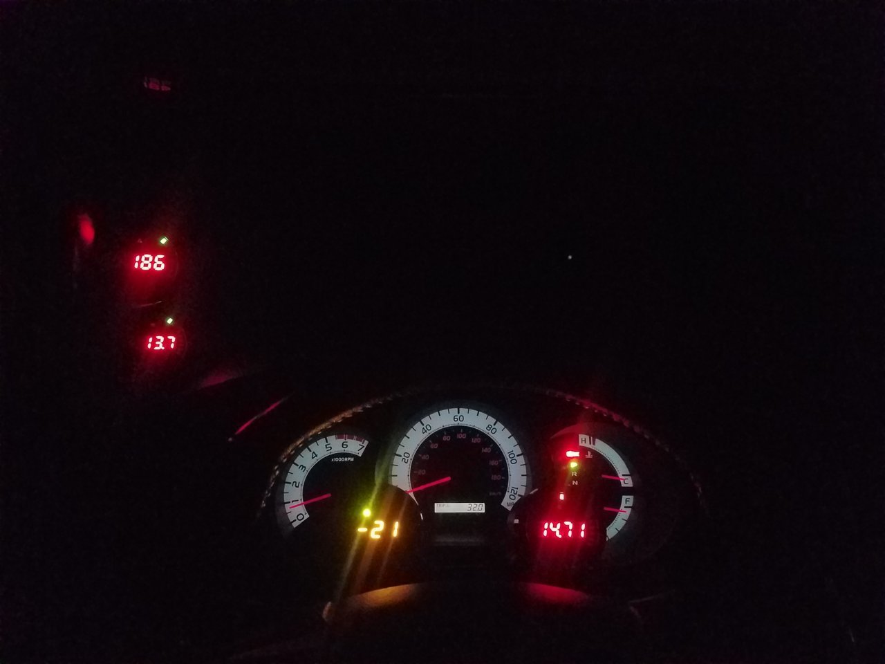

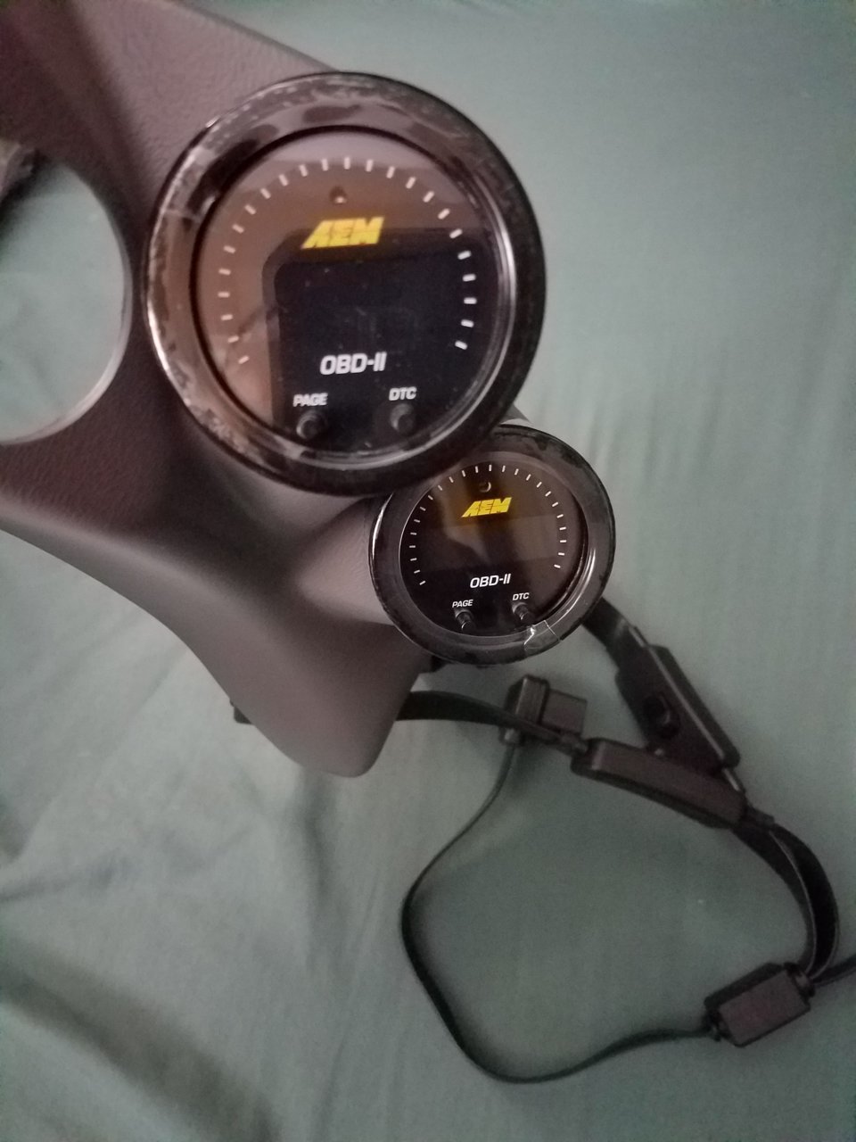

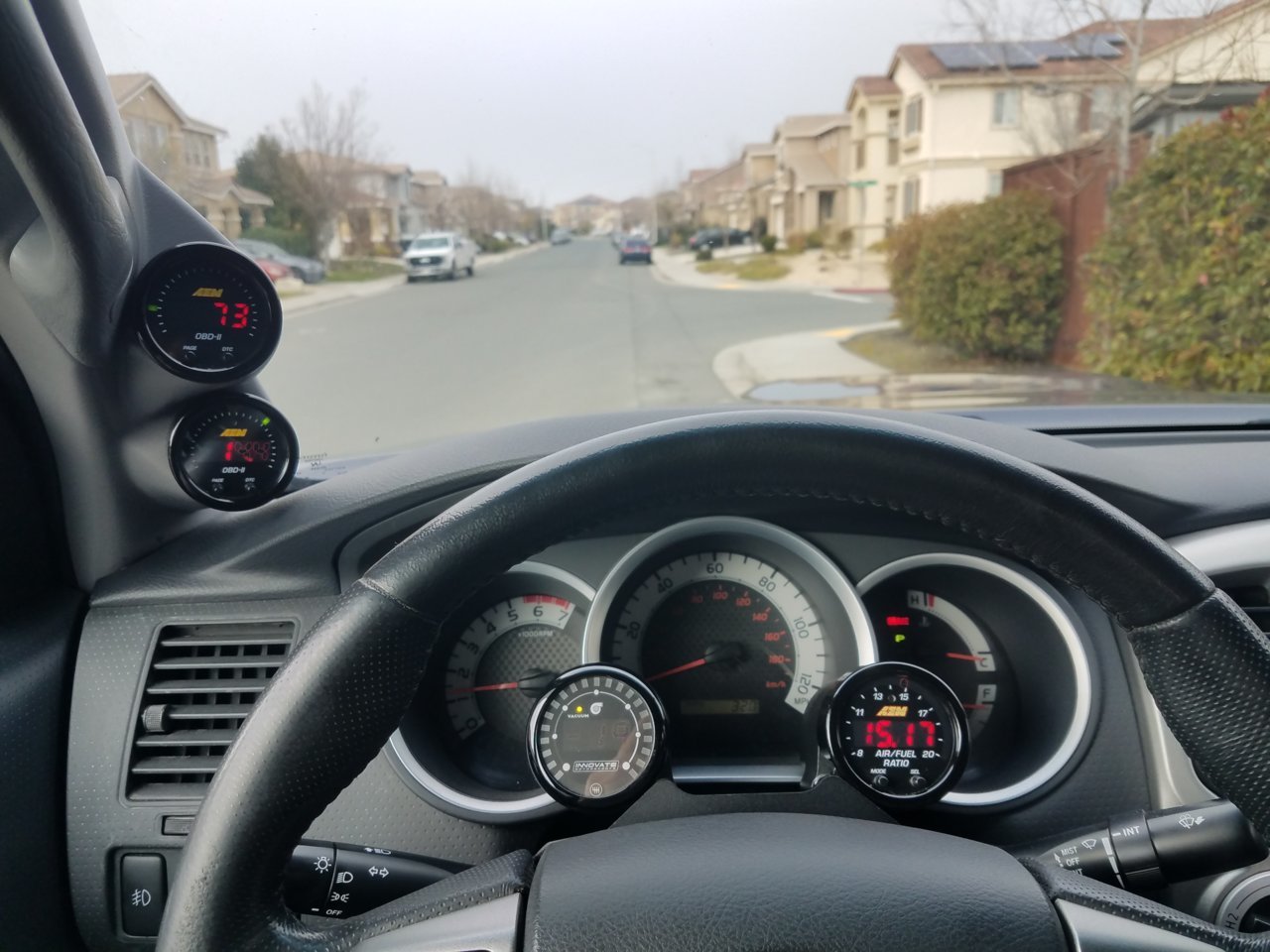

    I ordered a LoTek pillar pod and installed dual AEM X series OBD2 gauges. These things are awesome as they let me choose various PIDS on the fly while driving. I nornally use them for coolant and battery temperature though.

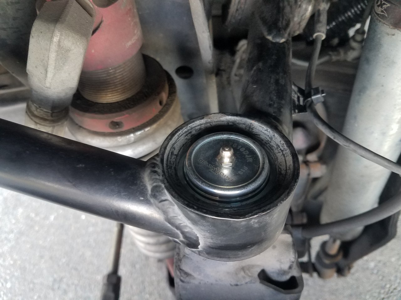

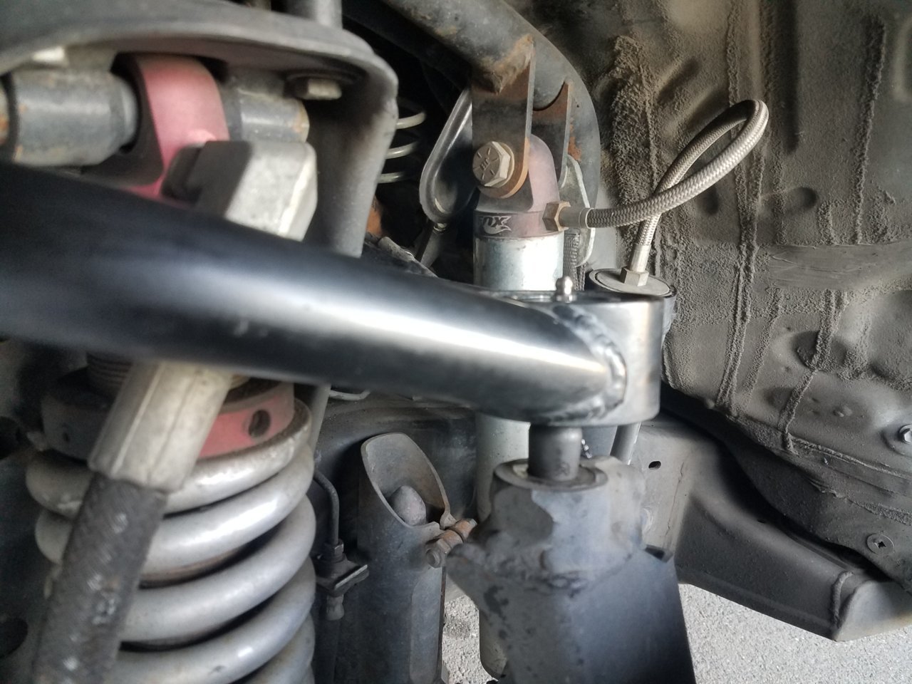

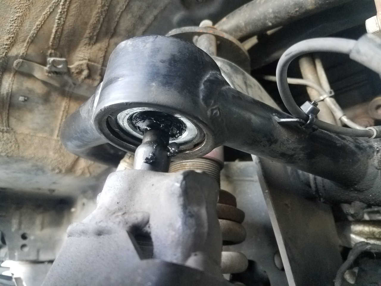

    I got sick and tired of so much squeaking from my uniballs and in an effort to combat annoying noises I upgraded my uniballs to Icon Delta Joint retrofits. These things are awesome and the fact they are greasable is a very welcome thing. The front has considerably quieted down now and they fit beautifully in the Dirt King Gen 1 tubular upper control arms.

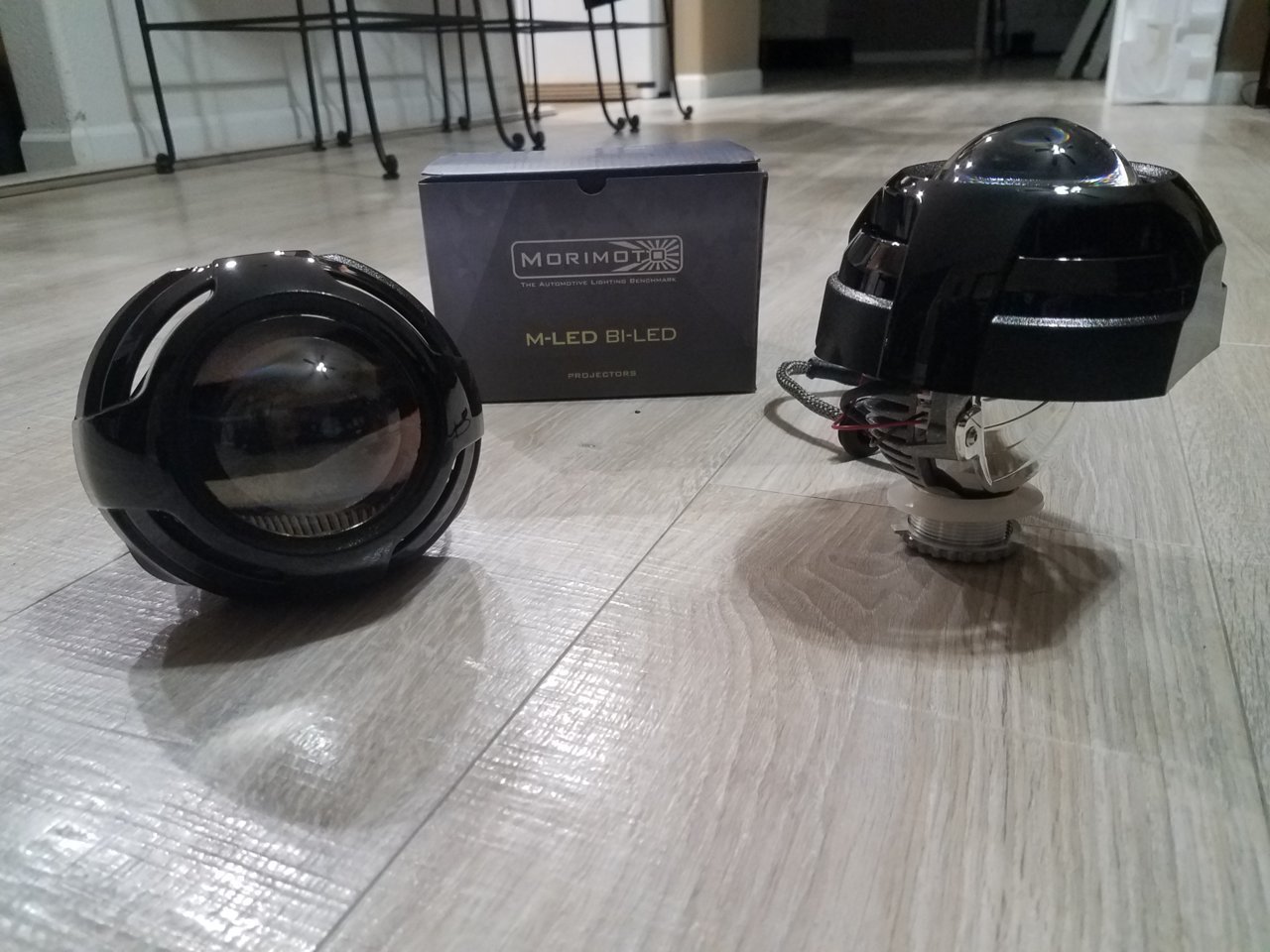

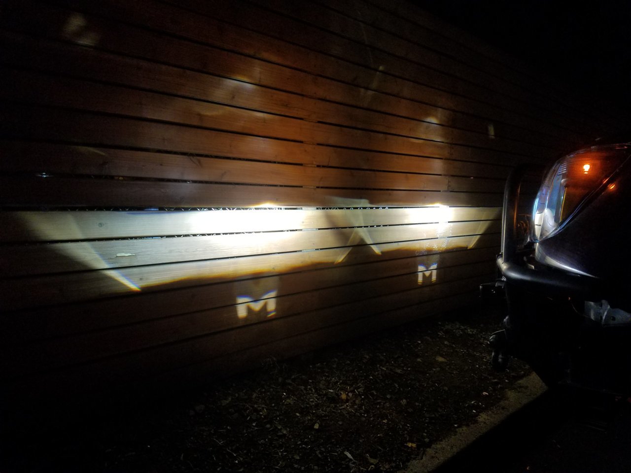

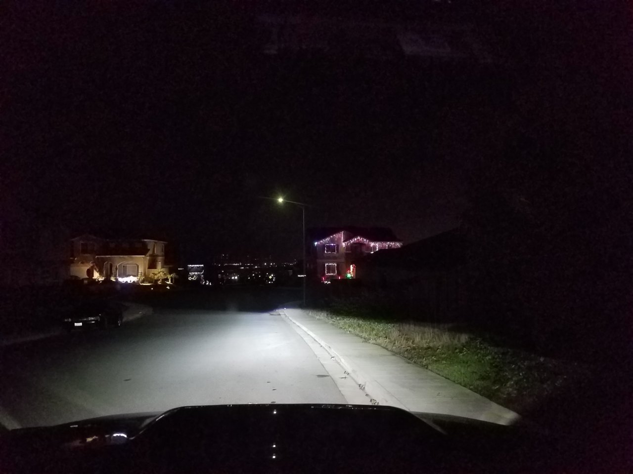

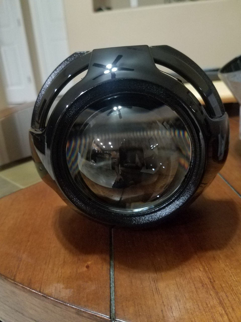

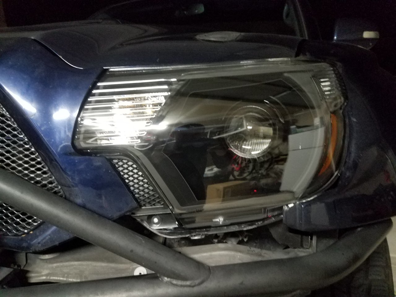

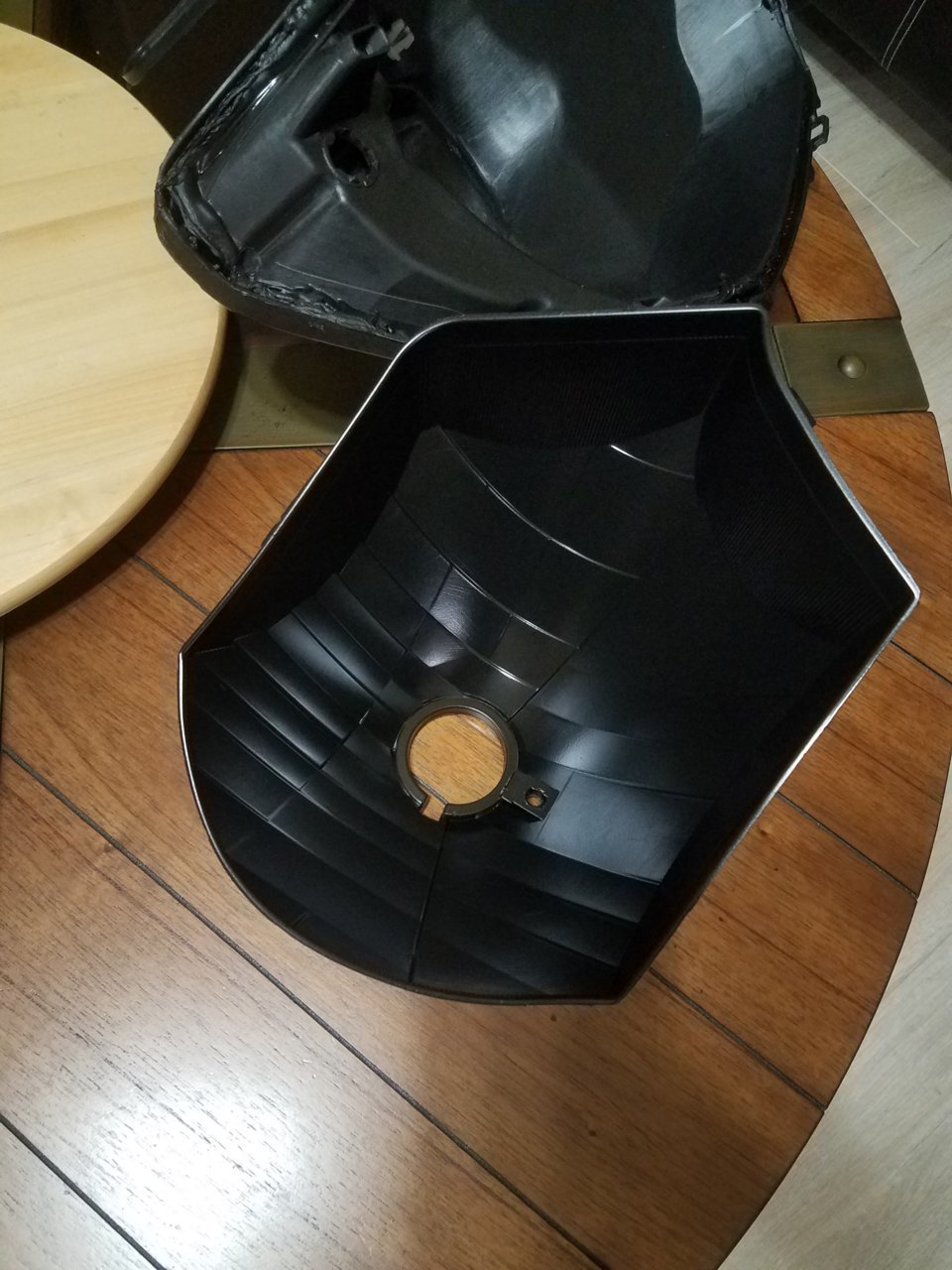

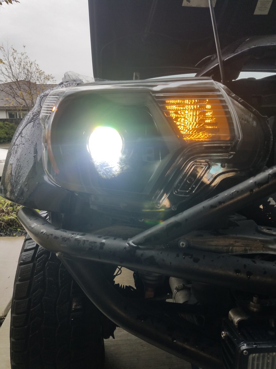

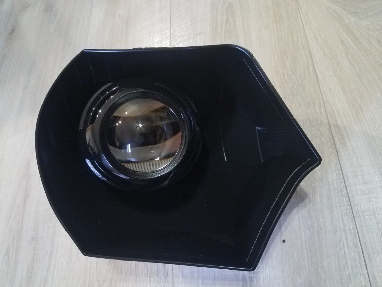

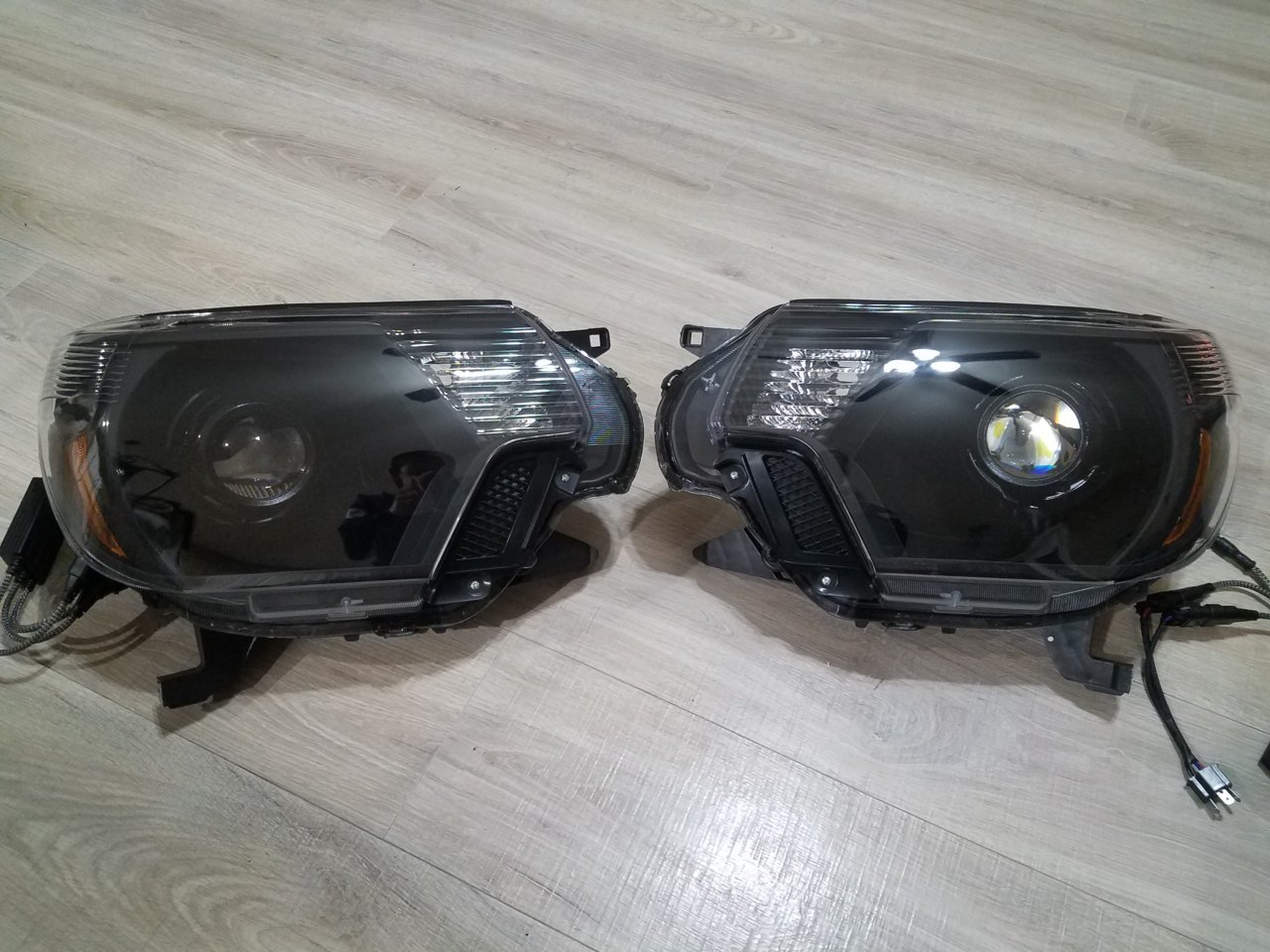

    Retrofits! This one was fun (not really) it was tedious, annoying, and there were so many snafu's along the process. It was ultimately worth it but I don't think I would do it again.
    Installed shot:
    Light output is pretty on par with that of HIDs. I must say, I am very pleased with the outcome.

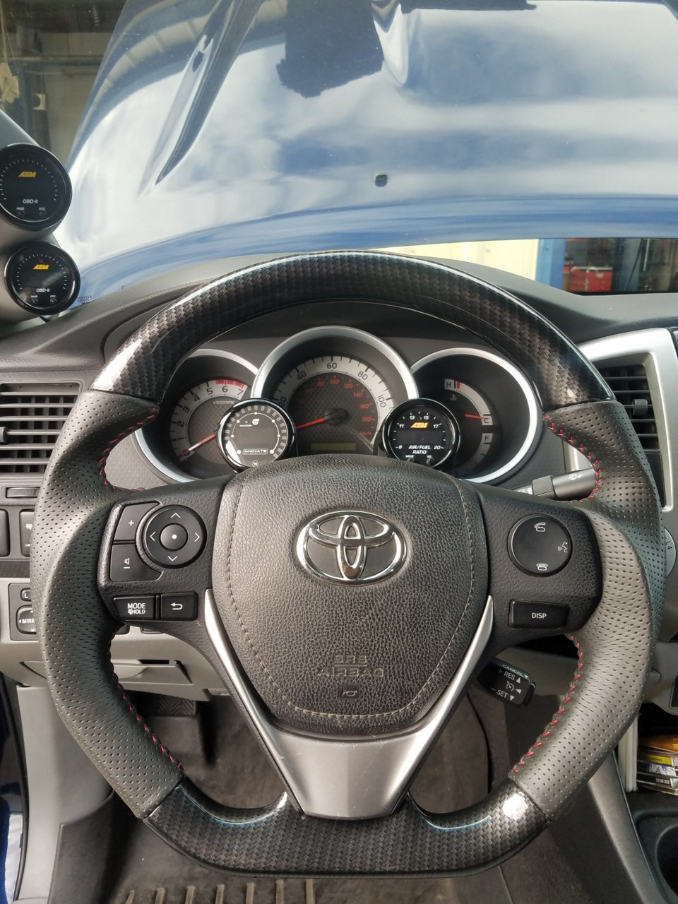

    How much did you spend to get the wheel/airbag? I have seen some on ebay but I am a bit concerned with buying an ebay air bag lol.
  17. Mar 25, 2020 at 9:19 AM
    #677
    12TRDTacoma
    12TRDTacoma [OP] Powered by Ford, GM, VW, and Mercedes
    Aug 20, 2012
    #85133
    16,671
    Rob
    Concordia
    12 TRD Sport DCLB 4x4 Supercharged
    Boosted
    I spent about $235 for the bag itself and about $250 for the wheel. I spent about $60 on the donor wheel to transfer stuff from and $90 for the steering wheel buttons which I may end up returning as I have a now have a spare on hand.
    Total about $635, and tons of time invested in rewiring things to restore functionality to the buttons on the truck as well as running new wiring for the additional buttons (which still don't work because of the module or the radio not supporting the buttons).
