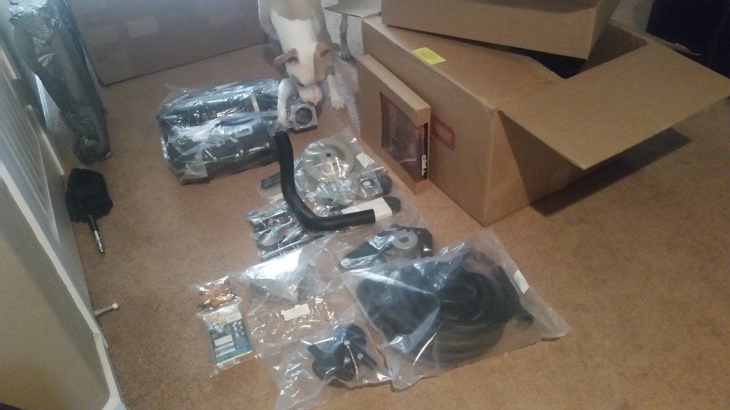

    Something big came in the mail today, anyone guess what it is? :D
    Now we're getting somewhere!
    Finally a part of the supercharged crew! :woot: install goes down this Sunday. Tune from dealer will be done on Monday. I'm beyond stoked!!

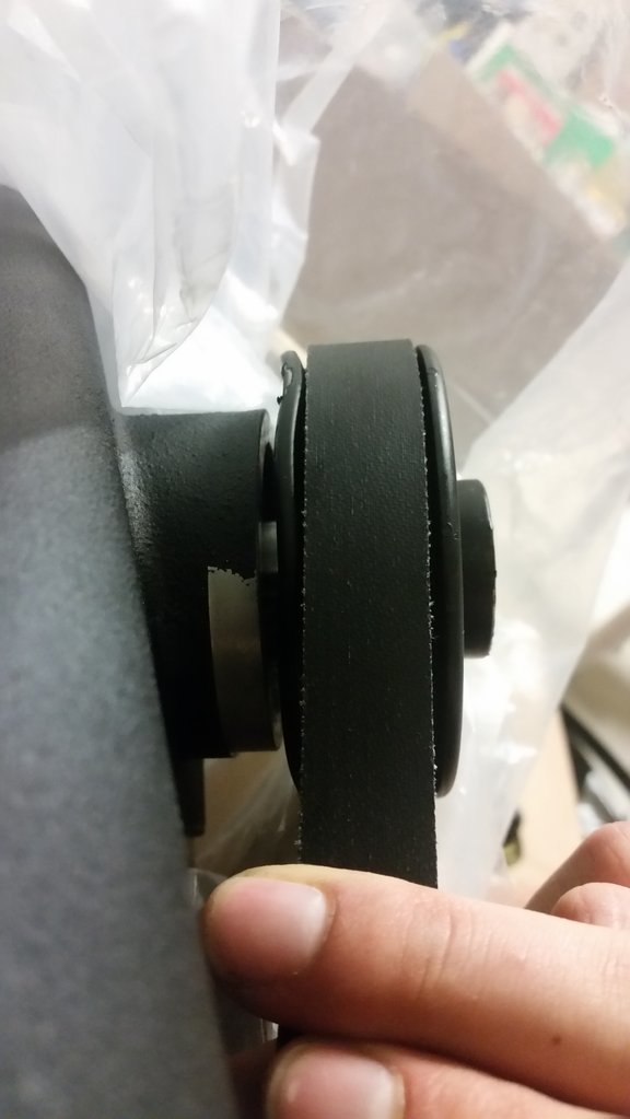

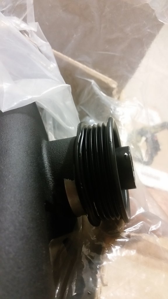

    Here is a picture of the pulley as it sits right now. It's about 1/2 of the way in. You can see where the bend in the back of it is largely pronounced.
    Upon putting the stock TRD belt on it though, it appears to fit just fine still. I am not sure. What do you guys think? Still serviceable?
    As far as continuing to install it goes if it still appears good to go, what do you guys suggest? I'm sure just take a torch to the entire pulley in general wouldn't work at this point would it due of the fact that the shaft is right there huh.

    I don't know man, I'd be afraid that under boost you'd start slipping on the pulley because it isn't fully engaged on the nose cone. I think leave it as is for now and give URD a call on Monday and see what Gadget says about that. He might tell you to replace it or do something else, you know?

    Well I would obviously continue to attempt to install the pulley all the way in. So the nose cone would be all way flush like it should be. I'm talking more about how the belt current rides in the pulley. It appears as if the back wall of the pulley and the fact that it is distorted still allows the belt to ride within its respective rib areas without issue.

    Oh. Yea...it looks fine to me. Its not being pressed on by the deformed spots and as long as it sits in the grooves, you're fine.
