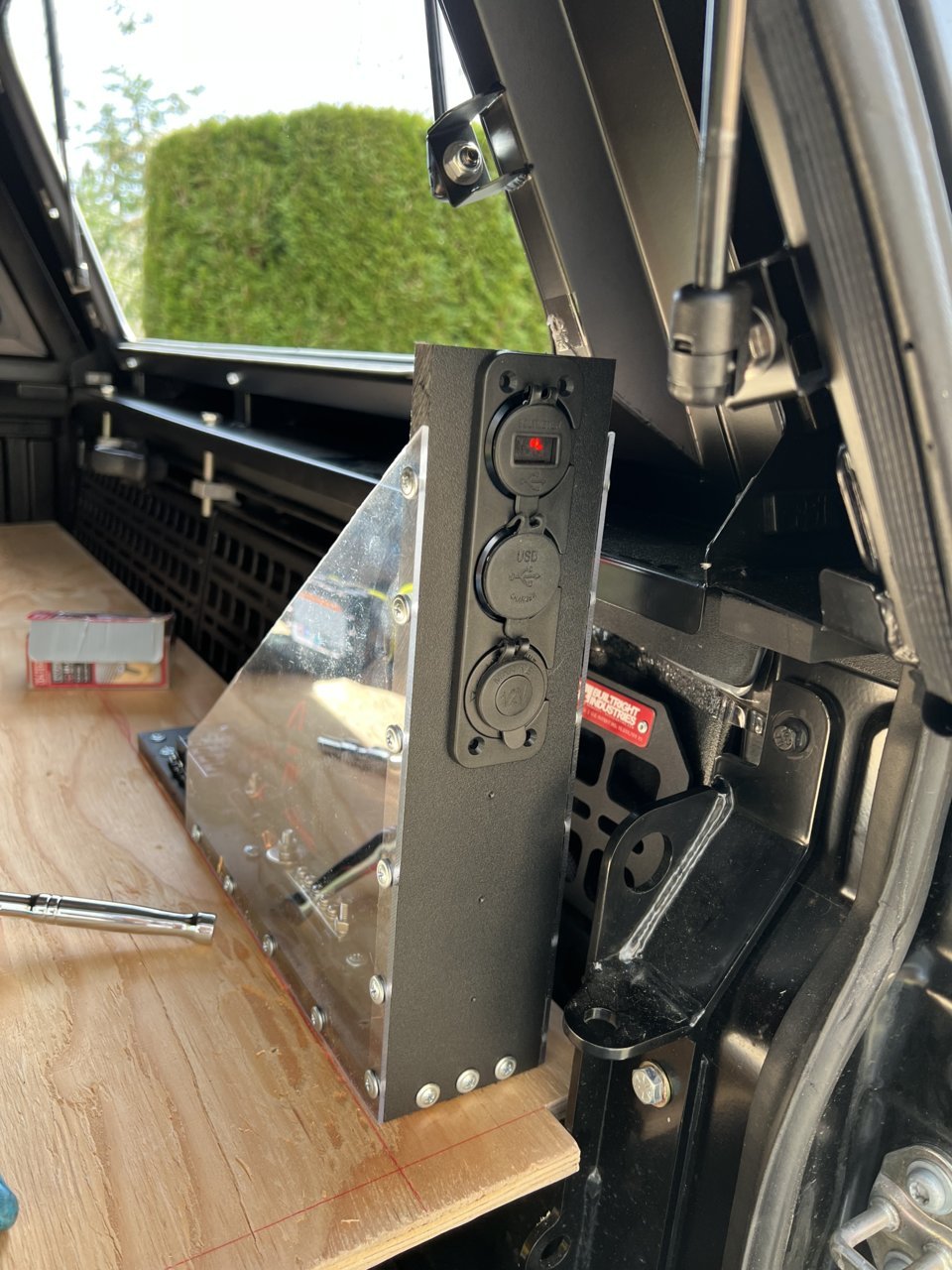

    No (with caveats) on the Decked system for same placement. The Decked "ammo can" that is the rear support blocks the back cubby/plug area. The OP put his plugs just above the cubby area, but that is still blocked by the Decked system. You would have to move the OPs setup higher up in the bed side. Decked instructions even recommend running a short extension from the plug before install if you have the rear 110 setup. My plan is to route wires into the Decked "ammo can" in the back passenger/right side. Then my 110v, 12v plug, USB, and voltmeter will be visible on the back surface of the ammo can. I will then make a kydex panel to cover the wires inside the can so much of the ammo can storage is till usable. I doubt I will ever have more items in back so will not likely do the fuse sub-panel. I still need to decide how to route the wires from under the bed into the Decked can. I will likely bring up and into the Tacomo cubby then just cross into the rear side of the ammo can. If you have better ideas..I am all ears!

    Whemever you do this decinitely send pics, it sounds interesting. But to understand more of what you're doing, so basically in that ammo can you'll have the guts (fuse block, and such) withing the ammo can, then the ports on the taco itself, or wouldn't it just be easier to cut out the holes and screw the module onto the top of the lid of the ammo can.

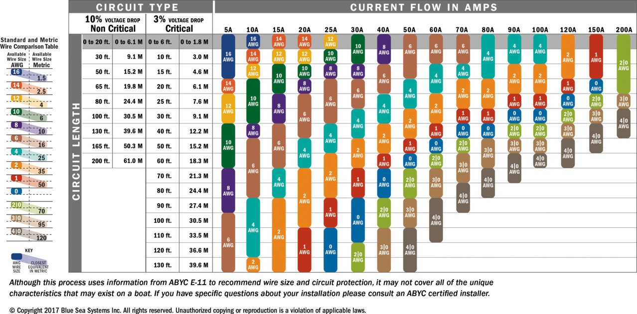

    C67C3A71-70F1-4B0E-BD0A-B621F8F5969F.jpg I use a 60amp circuit breaker. Make sure your wire is sized correctly. I ran 4 gauge. Positive and negative. To my setup.

    Ok. The OP used 10 gauge wire and a 30amp fuse. If I mimic your set up then I’ll run a positive 4 gauge wire to a 60amp circuit breaker then the outlet, a negative 4 gauge wire to the outlet, and no ground wire.

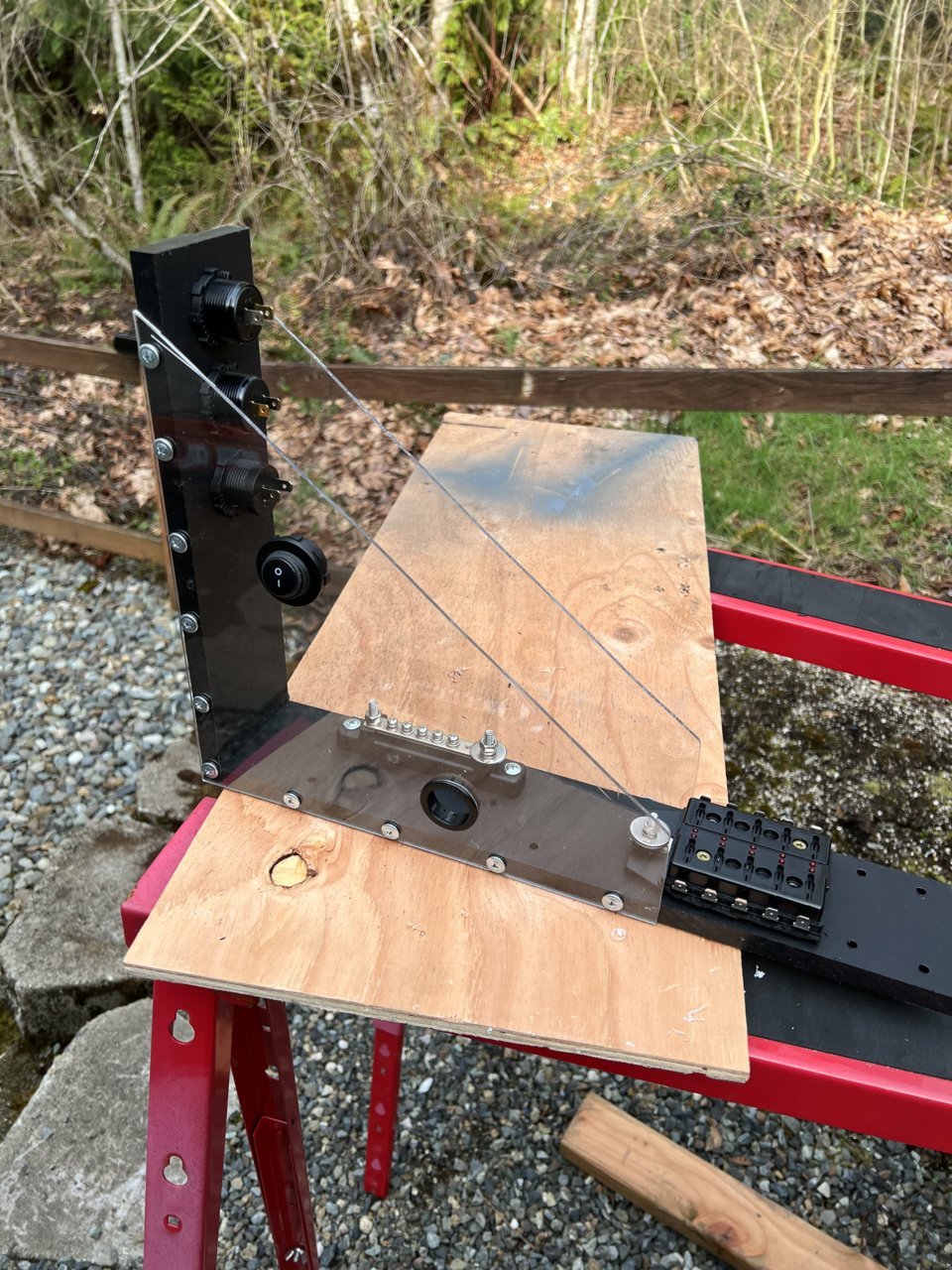

    My 4 gauge runs to fuse block in the bed. From there it’s broken down to power plugs and usb.
