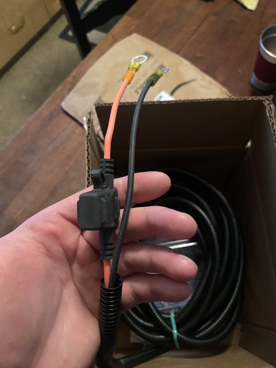

    Recently bough genesis offroads prewired blue sea 12v outlet, and wanted to wire it up the left side of the truck. Whats the best route to the battery? Couldn't really find a thread of where exactly to go. 2016 access cab.

    This is the wiring if anyone was curious.

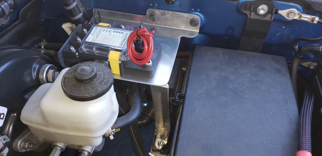

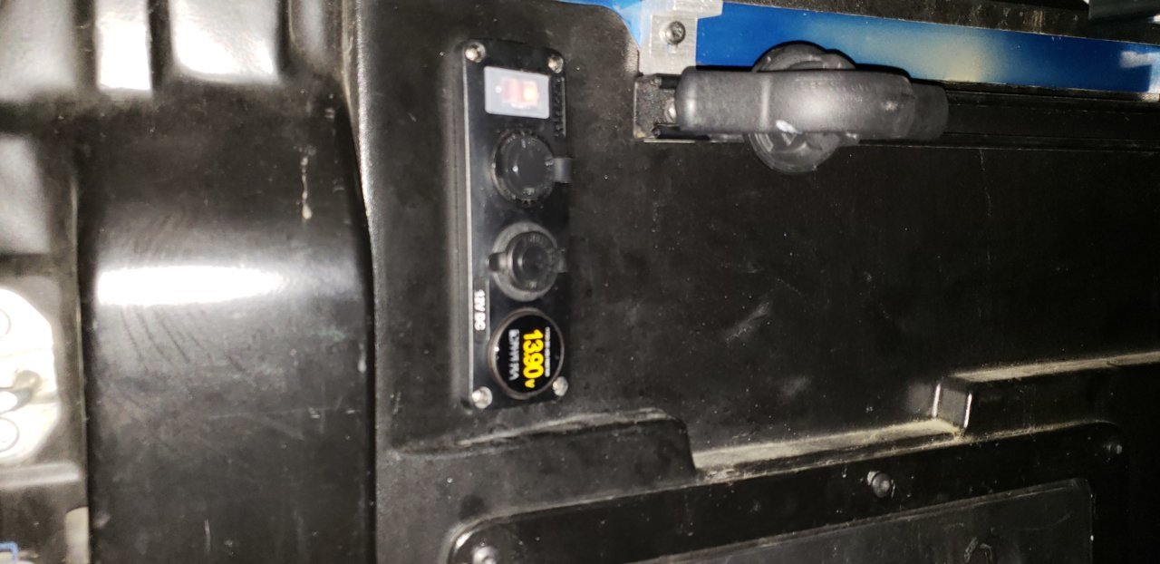

    If you are going to the box, I ran my wiring along the frame. It was tight getting it above the fuel tank. I zip tied it to the factory harness along the way. Then up behind the left taillamp to where I mounted my power panel. I also made a support and mounted a fuse panel behind the factory relay box. When I ran my wires, I ran a bundle so I didn't have to do it again anytime soon. Just for future upgrades.
