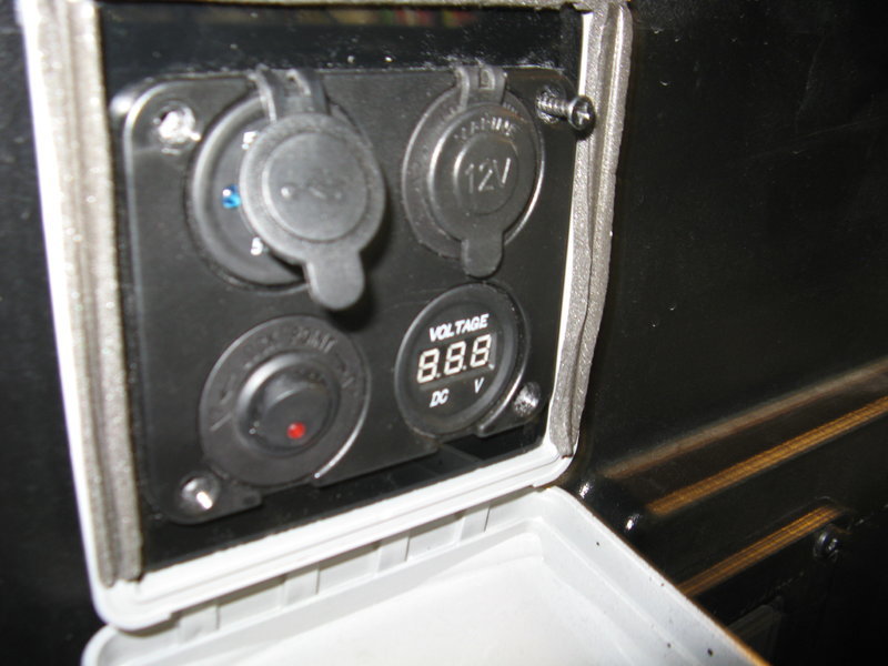

    what enclosure is this and where did you source it? I think I might steal this idea. I want to get power to my bed, too, but have no cap and need to keep stuff out of the storage box.

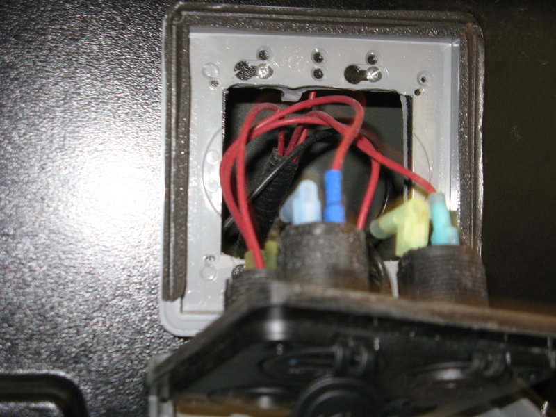

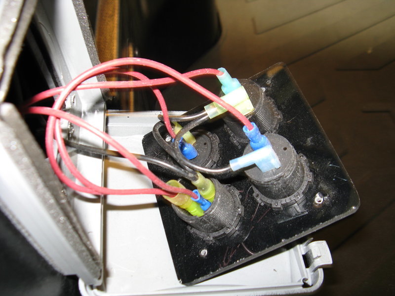

    if you have any questions, hit me up. I will try to help you as much as possible. This was by far the best thing I have done so far, I use the crap out of it when I am camping for my Bluetooth speaker and ipod. The cover kept all the snow and rain out of it all winter, and we had a record breaking winter this year with all the rain, and snow that fell.

    Perfect. Found it on the site; I even have some spare plexi hanging around. Thanks!
