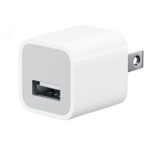

    You can just splice into what’s already there, many have done it. Or, get one of these
