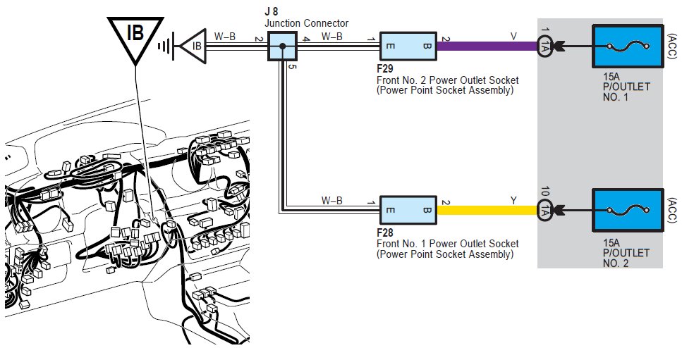

    Does anyone know where the ground is located for the 12v outlets?

  3. May 3, 2019 at 1:07 PM
    Siblue
    Siblue Well-Known Member
    Dec 2, 2014
    #143489
    3,159
    So Cal
    25 Tundra TRD pro
    WHT/BLK is standard Toyota ground wire throughout the vehicle.
  4. May 3, 2019 at 1:09 PM
    Gunshot-6A
    Gunshot-6A Prime Beef
    Dec 29, 2009
    #28389
    23,595
    Conner
    Everett, WA
    '15 TRDOR / '17 Africa Twin
    Generally under the tires :rofl:
    Look for a white/black wire. That's toyota's common ground color.
    Khoadattran and TacoManOne like this.
  5. May 4, 2019 at 12:05 PM
    over60
    over60 Over70 & still a "Grumpy Old Guy"
    Oct 20, 2010
    #44995
    4,791
    John
    Muskoka, Ontario
    2016 Inferno (Punkin) TRD 4X4 Sport DCLB w/upgrade & tech pkg..!!
    Toyota running boards/Solid Fold 2.0/custom stickers/Anti-Dark LED light under hood/Derped grill/Scoop, etc.
    There is a ground nut by the fuse box. Another attached to the 12v lighter socket in the console....OR...Any part of the frame.
    I just found another one behind the dash.....5" behind the start (or 4X4) button...(Muct remove 2 pieces to get at it.)
    What are you doing? Maybe I can help ya'll.

  7. Aug 24, 2019 at 1:54 PM
    oconnor
    oconnor Where am I?
    May 28, 2016
    #188156
    2,382
    Midwest
    '18 TRD Sport 4x4 AC 6MT/ '04 TJ Rubicon
    So the purple wire on the 12v socket (dash) is switched (IGN)? Looking for "on with ignition" for heated seats...

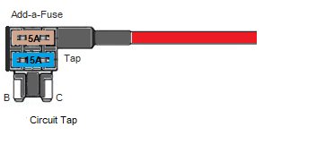

  8. Aug 24, 2019 at 2:11 PM
    caribe makaira
    caribe makaira Well-Known Member
    Feb 13, 2011
    #51121
    11,786
    Caribbean, Puerto Rico
    05 PreRunner TRD Offroad AutoTrans
    Hood Struts, My version Fogs always ON, Map & Overhead Light Mod,
    Tap the fuse of the 12v Socket with an Add-a-fuse.

  10. Aug 24, 2019 at 2:47 PM
    oconnor
    oconnor Where am I?
    May 28, 2016
    #188156
    2,382
    Midwest
    I believe this is just for the switch lighting.
    EDIT: Looks like this is the best route. :thumbsup:
    These are the Rostra ComfortHeat that come from Clazzio. I'm using the harness with the gold power supply. They didn't come with a relay but it sounds like the blue/green lead (switch lighting) needs power before the seats will work, may act as an integrated relay? I am also adding a secondary Blue Sea setup so will power/ground and relay from there if needed.
