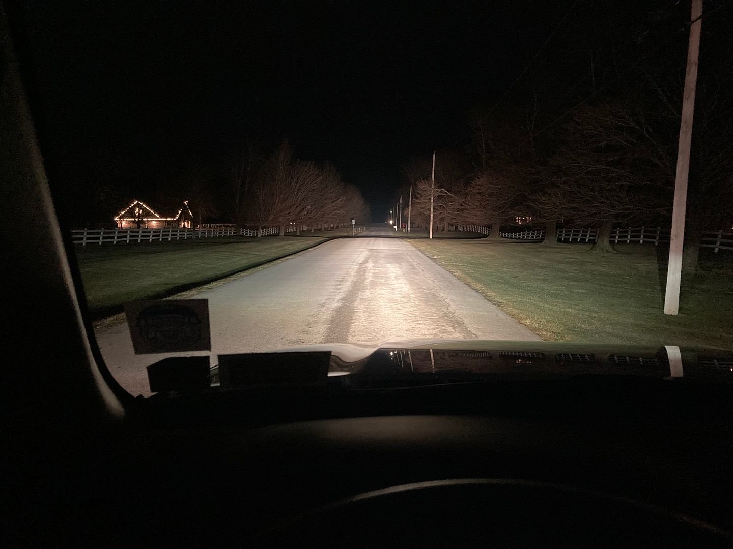

    Hmmm, those are Flood beams. Generally speaking, Flood beams are of very little use on the highway. First, they don't project very far. Second, the light that they do put out is literally blown all over the place - including upwards. That means it's wasted. What you generally want for most highway driving is a beam pattern matched to your needs.
    For instance, if you're looking to improve your distance lighting, you generally want a Spot or Driving pattern. If you want peripheral vision, you generally want a Fog pattern. If you want to improve your side vision, a Flood beam actually works - as long as you're not looking for distance out to the sides. With Spot, Driving or Flood patterns, you generally cannot run them when oncoming traffic approaches. Properly aimed Fog pattern lights can be run though.
    Just to show you what proper pattern selection can do for you, I offer this personal example. I wanted pure distance lighting to supplement the high beams in my 2021 4Runner. I added a pair of Diode Dynamics SS5 Pro Driving pattern LED pods behind my grill. Better, but too much spill off to the sides for me. So, I swapped in the Spot lenses. Here's the result - which was exactly what I was looking for on dark, country roads. The road falls away and bends right about a half mile away. BTW, the spill off to the sides is still a bit too much for me, but it's 100% from my high beams. (The pods are wired through a relay to come on any time I hit the high beams.)
