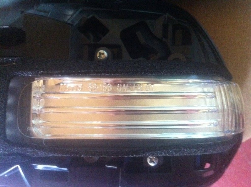

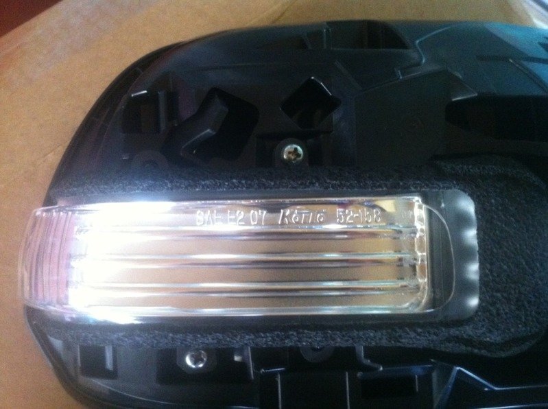

    It's possible.
    All you need to do is remove the cover, and that blinker housing is being held with 2 screws. Would recommending just using a tint type of film to black it out.
    Forgot to mention. Ones you remove the 2 screws, you can easily unplug it and remove that piece.
