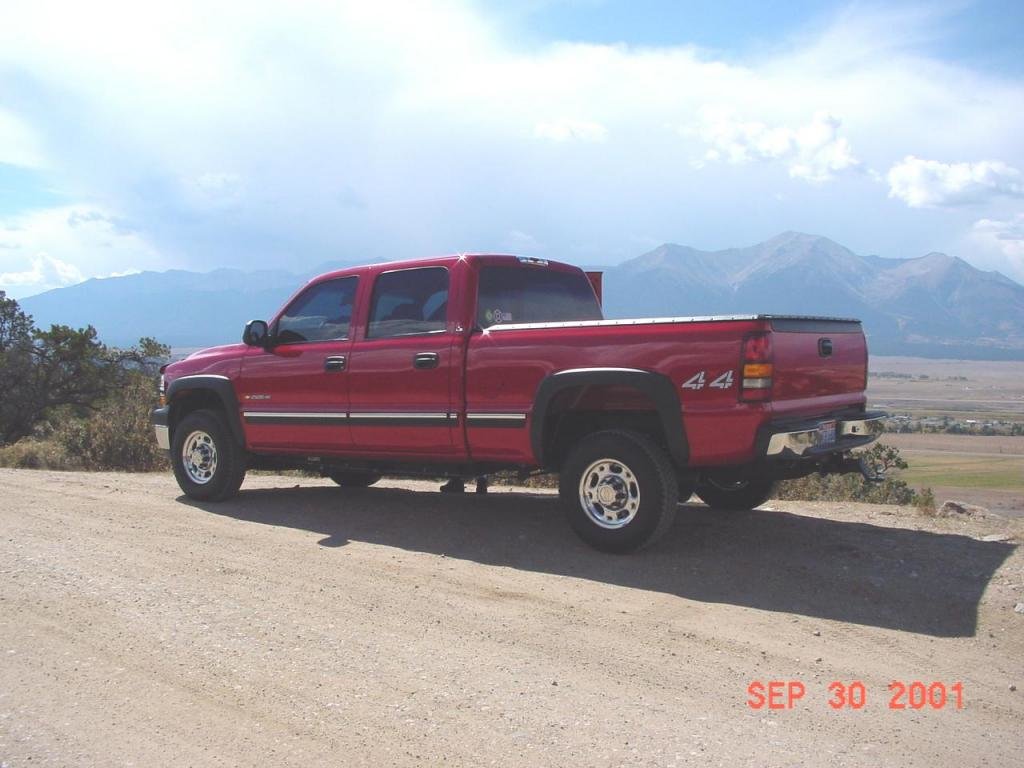

    ^This^
    I had this truck replaced with the lemon law.
    It had the suspension replaced front to back 3 times. At the time I towed a lot of things (27' travel trailer, 16' utility trailer, boat, ATV's, etc...) and I never felt comfortable with towing anything with it. Going over even small bumps it literary felt as if the suspension was coming out from underneath it. After the third time I had had enough. I loved the truck but I didn't trust it. I ended up going through arbitration and GM bought it back.
    I hope you don't have to go through all that trouble with such a new truck. I know how frustrating it can be to by something and it not be the way you want it to be. Hopefully it will be resolved soon.
