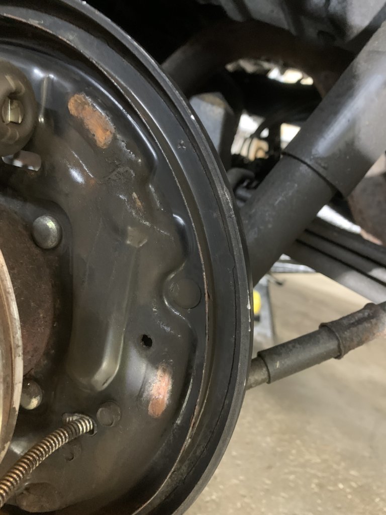

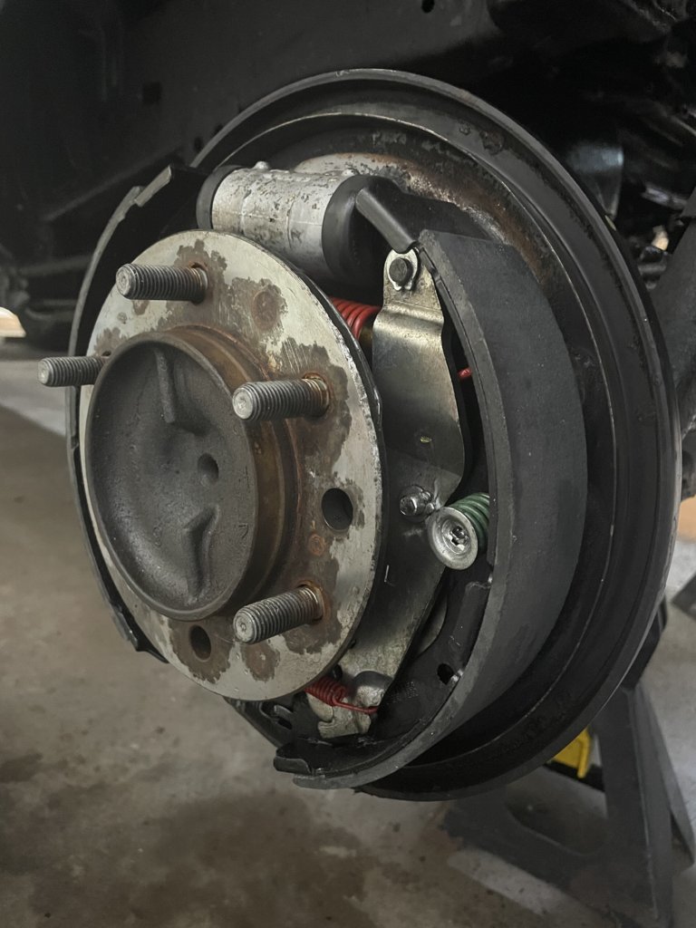

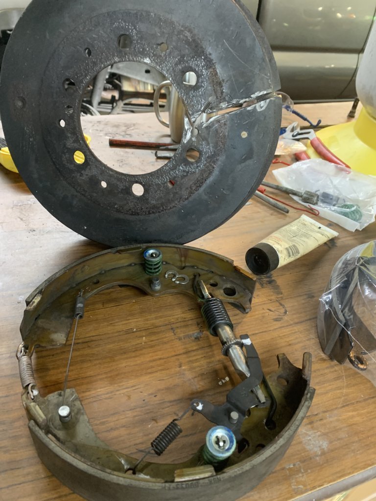

    Think I rooted out the issue - age, dried/absent grease, and crusty contact points on the backing plate. Parking brake cables seem just fine.
    Both drums were rust “welded” to the hubs. Heat from two MAPP torches, a lot of PBlaster, and many thwacks with a deadblow hammer later … I gave up and resorted to cutting the drums. Enough so that I could tap a chisel and expand them off the concentric ring on the hub. Then they popped right off. Too bad because it was surprisingly clean inside, the shoes I would estimate at 50% or more life left (75k mi). I really think a clean of the backing plate to remove the crustyness and some lubrication is all it would have needed. I think things were just getting hung up from too much friction, and also why they would suddenly break free when I tried to drive. With the drums cut I was all in for new everything.
    I got a complete kit from Powerstop and that all went together without an issue. Haven’t driven it just yet as I nicked 2 lug studs with the cutoff wheel and wanted to replace them, they arrived just this evening.
    The drums have never been off, the factory paper gasket was still there (it obviously didn’t do much). I’ll be painting the hub flange with antisieze. Lesson here, take those drums off regularly. I’m going to make this part of my annual Fluid Film process so I can check, adjust, regrease, and apply fresh antisieze on the hub. It sucked to destroy the drums to remove them, I spent hours trying to save them but to no avail.
    Crusty backing plate contacts
