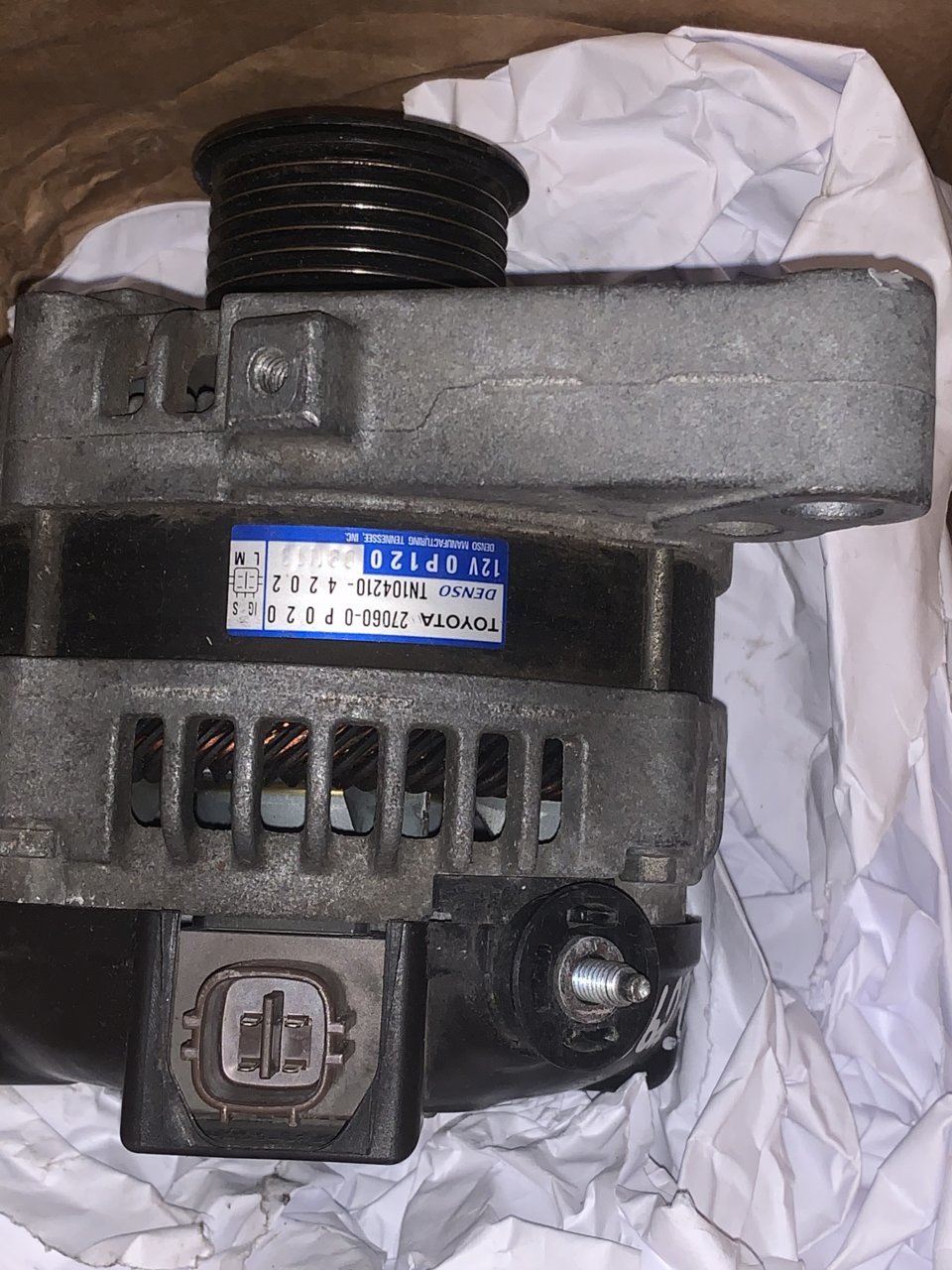

    Luka, I got the 130 amp alternator in today. It’s a used unit from Amazo nupload_2021-9-20_17-27-15.jpg

    Denso’s website says that the plug code on both are 917. So, hopefully it fits.
