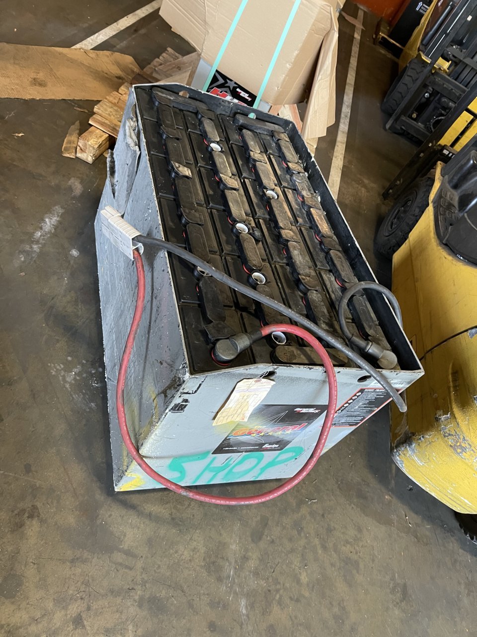

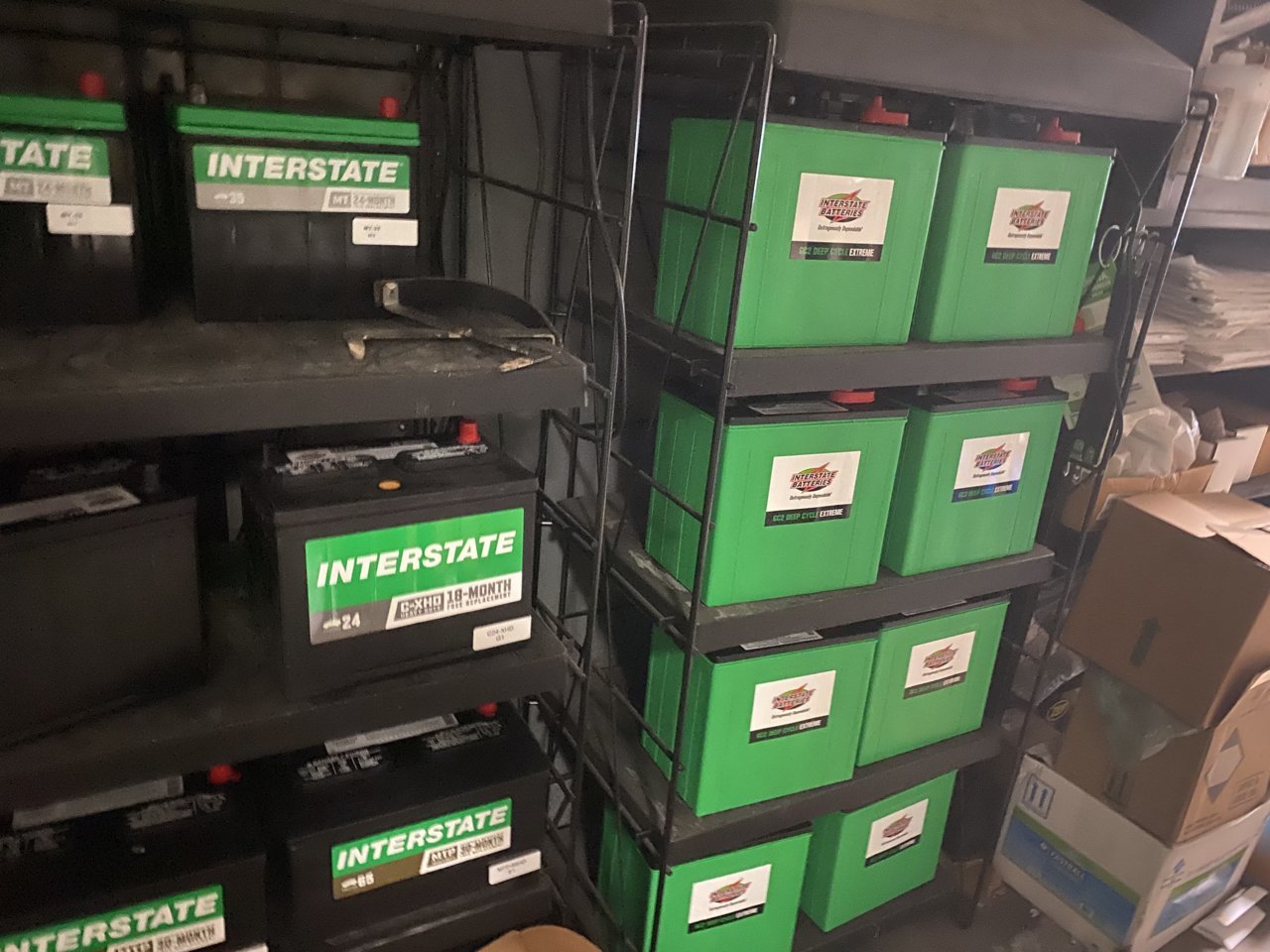

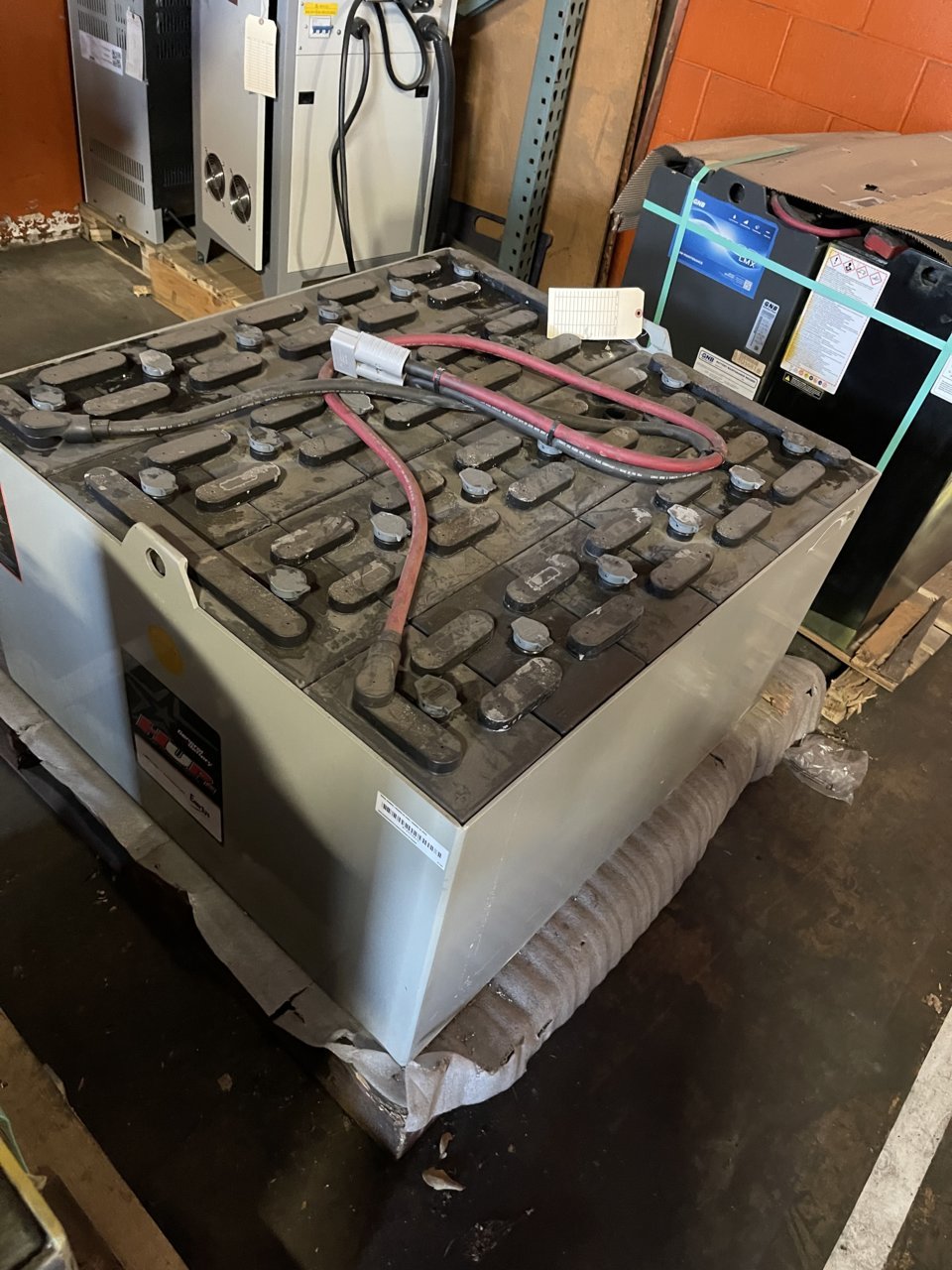

    There’s pictures of the batteries. The ones on the left are regular 12v car batteries. The ones on the right are 6v. I’ve seen bigger 6v batteries.

    Then here’s some of the really big ones. Of course these are 48v. But you could have them custom made for 12v, if you’re willing to have the entire bed taken up by a battery. They cost thousands and are super heavy.

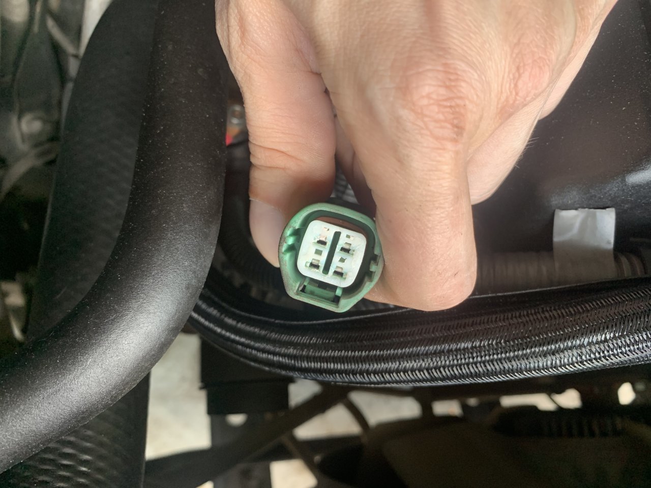

    Today I found that the 130A alternator plug is the same, and serpentine belt width is the same. I already have the 130 amp alternator sitting in my house. I’m gonna take the 130A alternator to get bench tested at Advance Auto, since it’s a used 70k miles stock Denso unit purchased from Amazon. I don’t want to install it until it is confirmed to be functional.

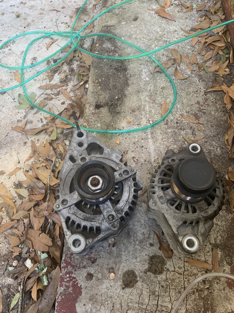

    The 130A alternator tested out as good. We also put it side by side with an 80A, and it’s dimensions are almost identical. I think I will be installing it on Monday.

    Okay, I tried it. It’s a negative. The bolt holes do not line up. See photo below. The left one is the 130A, and the right is the 80A.

    Dang it. Since it's out you can bring it to a friendly auto parts store to have it tested
