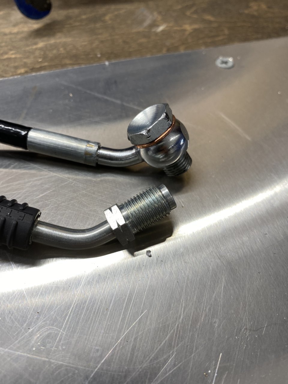

    I would use a hard line but I have Solo Motorsports 3" spindles and they don't have a spot to install the bracket that transitions from soft to hard lines. What about installing Tundra extended SS brake lines? Has anyone tried that?
    In the image below, is the spindle I similarly have but they're using an extended SS brake line without a banjo bolt.
  13. Oct 23, 2019 at 5:51 PM
    ChargedSHOTaco
    ChargedSHOTaco Well-Known Member
    Aug 19, 2012
    #85118
    820
    That is a short flared fitting to a braided line; essentially a hard line connection. I would ask Solo where the purchased the fitting and do the same. You get the benefit of installing a “hard line” on the Tundra calipers with the flexibility of a braided hose.

    Alright, I got rid of the Tacoma brake lines with banjo bolt and picked up Tundra brake lines from https://www.solomotorsports.com/
    You won’t find these on their website but if you call them, ask for Bobby or Paul. Let them know that you’re doing the Tundra brake upgrade and they’ll set you up.
