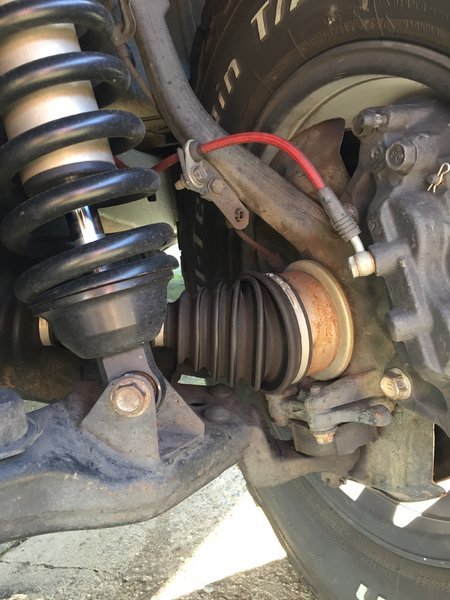

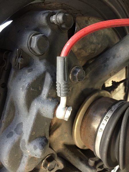

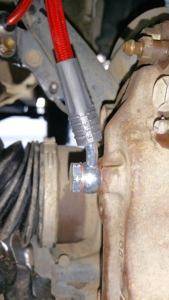

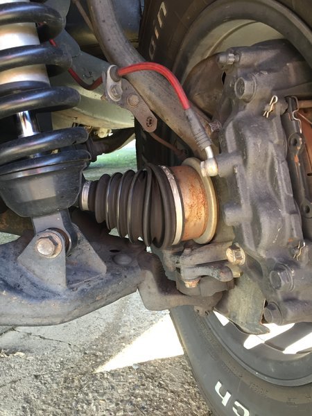

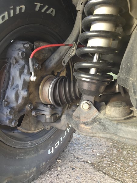

    Here are some pics of that matters.
    Stock
    Aftermarket
