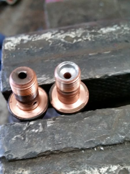

    20161029_140401.jpg Thats how i did mine. You drill the center out a liitle bit to fit over the tapered seat on caliper. I also shortened it about 1 thread with a file.

    Not sure you need to shorten the stock bolt. This is the first I've heard anyone doing that before.

    My copper washers weren't real thick ones. I only removed 1 thread.

    Gotcha. That would make sense.
    FYI to anyone doing this, make sure you blow out all the metal shavings

    YES BLOW OUT THE METAL SHAVINGS! VERY IMPORTANT!
