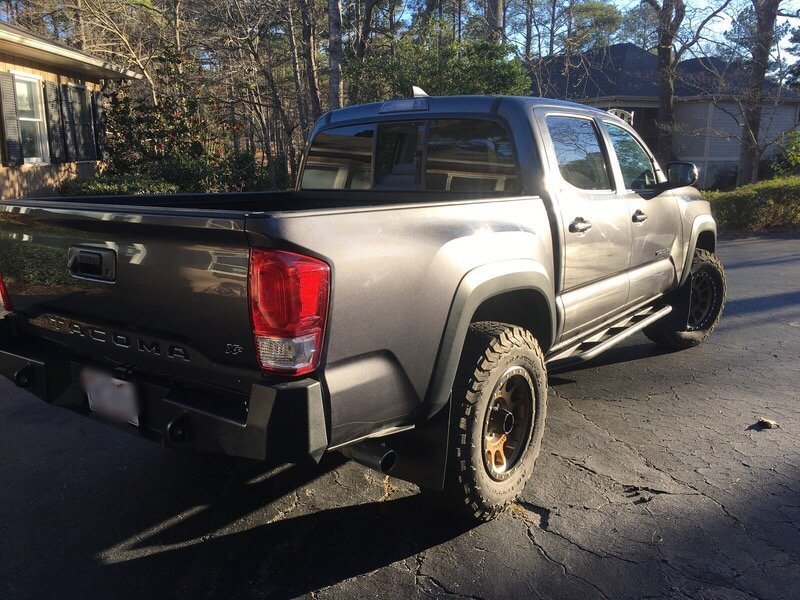

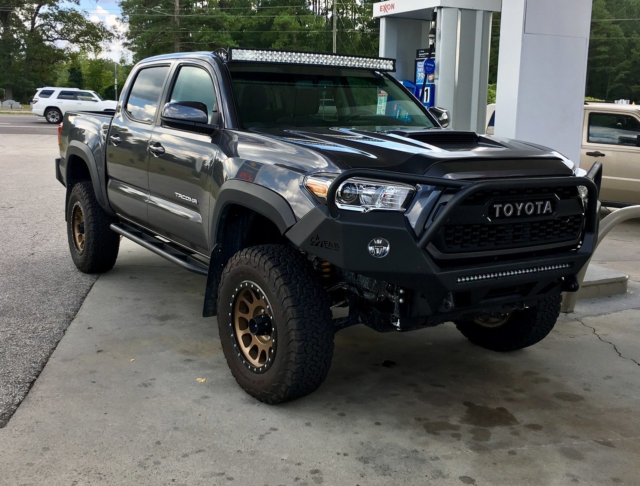

    He has a front bumper, rear bumper sliders, different wheel and tires and leds.
    More weight less auerodynamic. Not even sure why this is even a debate.....

    Not a debate. My stop and go city driving fuel efficiency dropped maybe 1-2MPG after bolting on thousands of lbs of shit and bigger tires. My highway MPGs are down 6+. How does that make sense?

    Honestly I don’t know your area of driving. Is is flat roads or constant up and down hilly areas, incline more than decline roads, speed limit change, aggressive driver that passes people. So many factors it ain’t funny. You changed your truck from stock that’s the big difference.
    Are you calculating gas or looking at your dash?
    I said in the first page. Your going way to fast on this truck. Sweet spot for decent mpg is 55-60mph. The faster you go you don’t exactly get better mpg, plus that front bumper don’t help you at all.

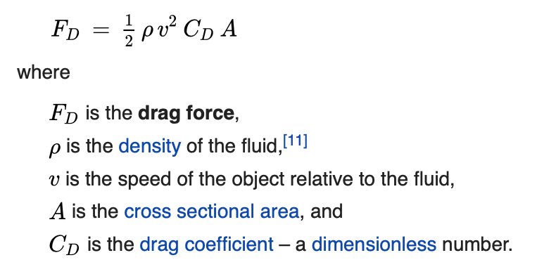

    Drag is not affected by the mass inside the vehicle. If you look at the equation for high speed drag you'll see there no mass in the equation:
    Rolling resistance increases with increasing load on the vehicle, but it's a pretty small change.
    Note that the drag force is a function of the square of the velocity, the difference between 55 mph and 70 mph is yuge.

    It is all about the velocity, the drag coefficient and the frontal area. Look at the equation, where do you see mass?

    Yep. Lifting the truck effectively increases the frontal cross section. Also, the roof rack.

    Rolling resistance increased by adding weight + different tires. It is important.
    Yes aero is the biggie and that light bar and bumper is big there too.
    OP, looking at your truck I definitely can see you taking a big hit o
    I don't have to look at that equation... I have it burned into my brain lol.
    What is missing is accelerating that mass up an incline. Say a 5% hill for several miles.
    You are right partly but so are several others lol.
    Bottom line, the truck is not broke. It is totally within normal limits given the mods.

    Not important at all, actually. It is a tiny, tiny factor.
    Yep. By orders of magnitude at 70 mph.
