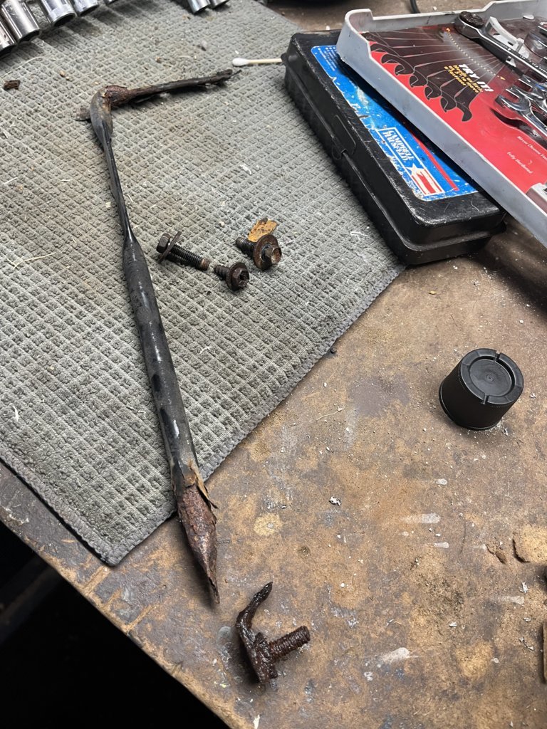

    I rubbed against my truck in the driveway today only to find out that the whole front of the bed is flapping in the wind! The front panel support on the right side of the bed is completely rusted off! 48,000 and it’s rotted away! Bad enough my paint is falling off, now this. All of the bolts are going to have to be ground off!

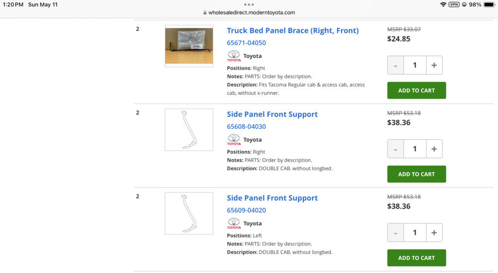

    I’m having trouble finding the correct part number. The ones I’ve seen are single and extended cab, excludes long bed!

    Long bed uses the same as Access Cab, 6.2 ft bed.

    How does that happen with only 48k miles?

    11 years in salt
