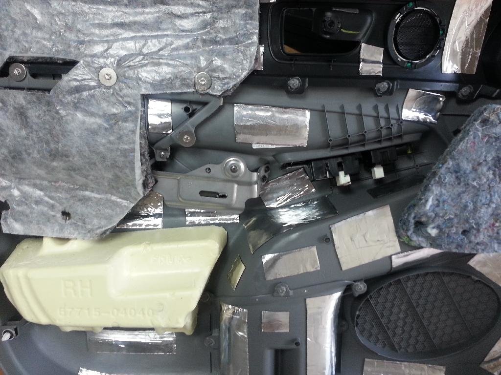

    Want: More time at night when its cooler. Need: Cold beer and a hug after realizing stuff still doesn't fit after many many fittings/trims.

    When talking about stuff not fitting I'm assuming you're referring to the door panels? They are a bit tricky. You need to sand down that piece of beige foam in the panel that provides structure to the door. Otherwise it will never fit. I'd also recommend cutting holes the size of the contact points where the plastic pop rivets fit. The pillars and rear walls should be somewhat easy though. The floor/carpet is easy as pie.

    Yup, so basically, cut the MLV then the CCF about 1/4 larger than MLV around the edges (besides the inner cutouts for the hardware, passthroughs, door clips). The trick was actually making the template from both the door panel and the inner door itself. Combination of the tracing and using the outline of the door panel with a good reference point was key and the other 3 doors went on the first time w/ slight trimmings since the wiring loom isn't exactly the same on each door.
    You need a roller to flatten the edges down. What has been working well is making sure the tile is completely flat and only pulling the backer enough to expose one corner or edge, then getting into place, holding it flat and pulling the rest of the backer off from underneath. As for sticking, a roller is a must and for the tight spots, used a piece of rounded over flat wood stock to press down the corners and edges so they are tapered toward the surface as not to get snagged, usually by my hands. This was really important because unless you are cutting the tiles with a utility knife, scissors will leave undulated edges that act like a serrated knife if given the chance. One more thing, before applying the tile/sheet if deadener, did you clean the surface? Prepping the surfaces with isopropyl alcohol both to wipe the dust and dissovle any polar compounds like oil and grease that would interfere with the adhesive and keep it in place is critical.

    I will say, I don't hear a 'night and day' improvement with the MLV and 3M in the roof/door panels, rear deck after phase II. Although the roof is a little cooler than it was after adding CLD tiles and 3M, my Costa's are still too hot to hold in my hand when I take them out of the sun glass storage area on a hot day (and summer has just started). Adding MLV you have a lot to do to get all the panels to fit back on, a lot of good tips above.
    If you want to do what makes the most difference, do the doors and back deck wall with CLD, CCF, and 3M. Make sure to put anti-vibration strips on the inside of the door panel - especially the front doors. It makes a huge difference when the bass kicks in. You can get some cheaper CLD tiles for this type of application.

    Thanks, the real credit goes to the ones who went before me. I am merely a copy cat, standing on the shoulders of giants. It is a huge pain until you get the hang of it, then it's easy cheesy.
    Sound wise, it is a huge difference to me. I got rid of all the crappy foam and fabric Toyota thinks is "helping". :rolleyes: The road noise was very obvious, and has been greatly reduced. This can be attributable from the Thinsulate filling up almost all of the free space between the door and panel. It is an excellent product and glad I splurged on it. As far as temps go, when I park the truck and come back, the temperature is much cooler in the cab than before. Granted, leaving it out in the sun over an extended period of time will eventually heat up regardless of how much insulation one can pack in there.
    Agreed, although adding caulking into the panel's seams vastly reduced the vibrations, and the CLD tiles helped some, but not nearly as much as the caulking. The CCF did help, and will probably help more later on down the road when things get older to prevent rattles from starting. The MLV is fantastic at reducing the noise moving through the door, as well as the extra layers of Thinsulate.
