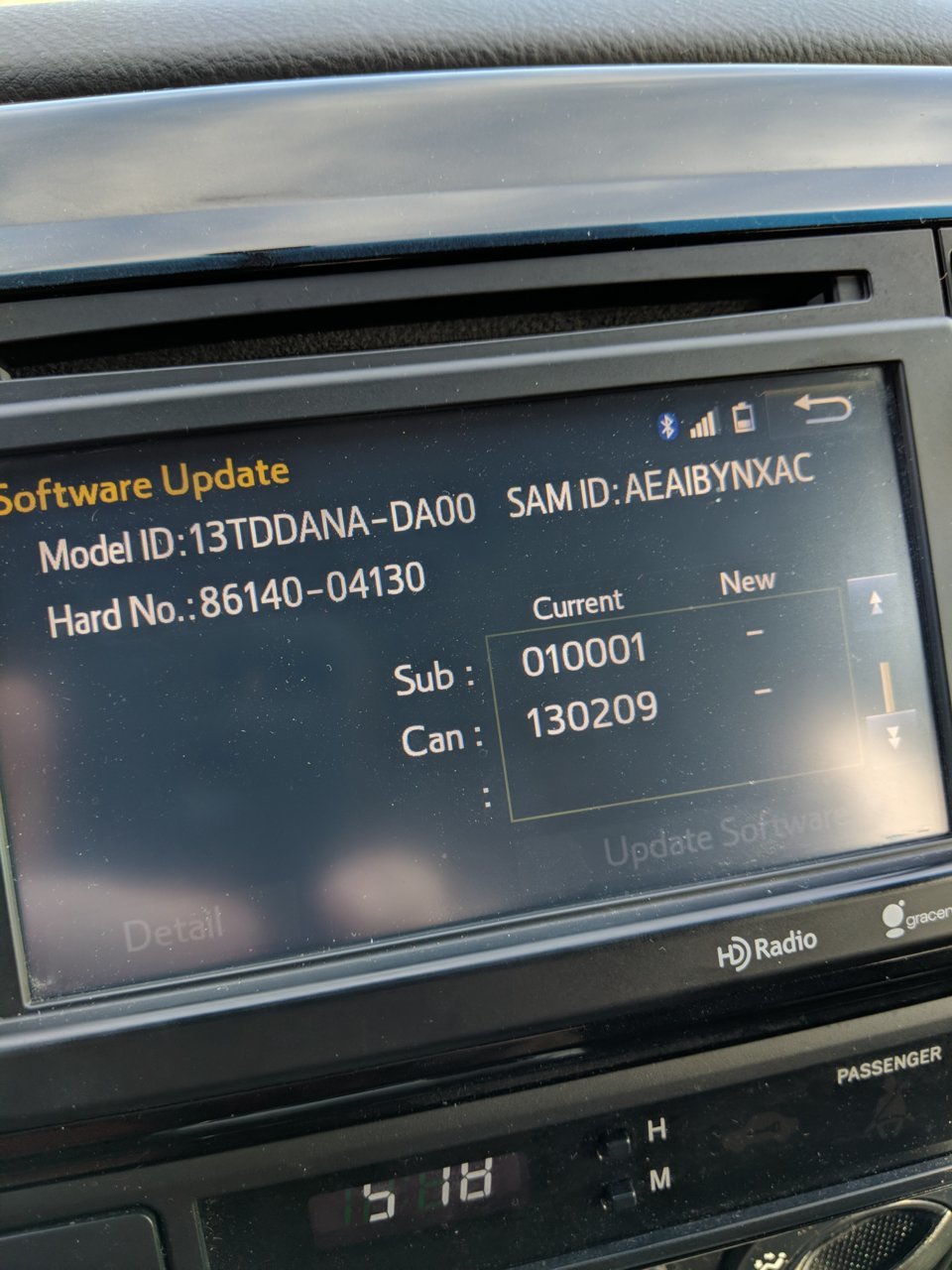

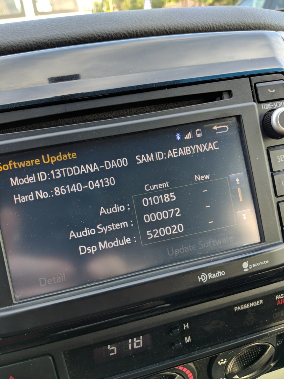

    Ok I searched and read a few threads about updating the firmware for the Entune w/ nav, fixing these issues. I have one without Nav and according to the Toyota website there is no update for mine. Is this true? Any way to fix this?

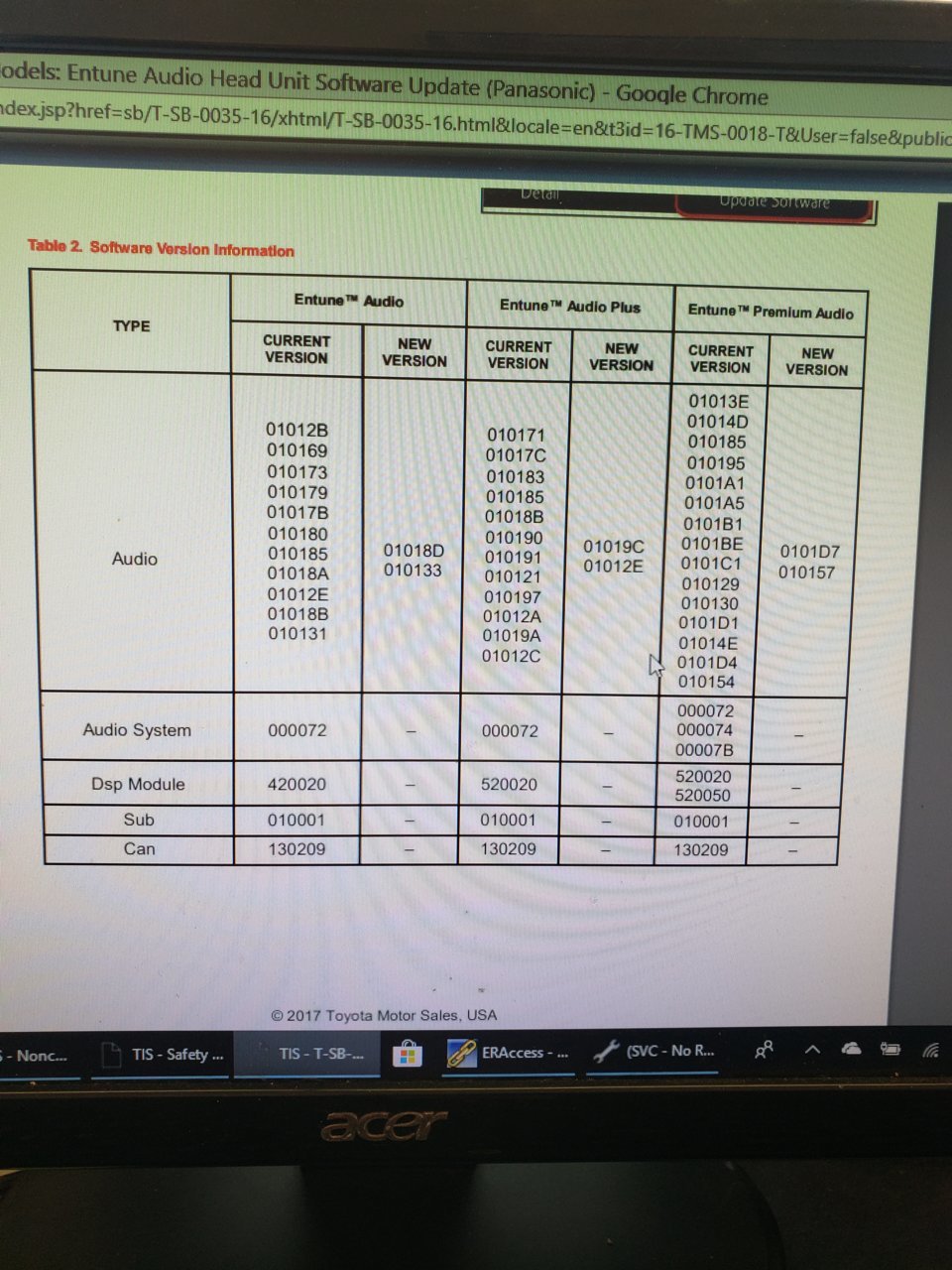

    Give me your current software version and I'll check when i get back to work

  7. Apr 5, 2019 at 11:26 AM
    GMan8402
    GMan8402 [OP] Well-Known Member
    Jan 30, 2019
    #281227
    86
    98 SR5 4x4 / 14 Prerunner TRD OR 4x2
  8. Apr 5, 2019 at 11:27 AM

    PM me your email address and I'll email you the file
    GMan8402[OP] likes this.

    File I have for it is 13TDDANADA00_0156.kwi

    Here they are

    The reply with the software that 2015 trd sport is correct.
    Get the file, put on a usb drive and it will allow you to update.

    Seems to be working OK though so I think everything is good. Thanks!
    EDIT: NVM I have the Audio Plus... lol I'm an idiot. I really appreciate all the help!

    According to that document i posted you have entune plus
